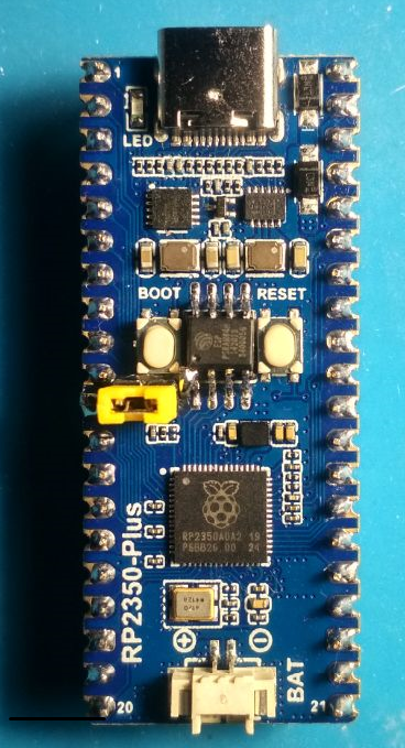

Now, I have another question about PSRAM, how can I now disable it without resetting other settings options?
Posts: 9115
Posted: 09:59pm 17 Dec 2024
Have you tried OPTION PSRAM DISABLE ?
Then again, just disconnecting it from GP8 will remove its CS signal and it's gone.

OPTION PSRAM DISABLE does not work, there is no such OPTION.
I modified my RP2350-Plus board with a jumper that disconnects CS from the PSRAM chip.
Disabling this signal CS subsequently led to a complete system freeze. I had to erase and reflash "Pico2" again, restore the option settings.
By the way, can someone help write a stress test or a performance test for this type of PSRAM memory with a capacity of 8 Mbytes?

Posts: 6101
Posted: 06:12am 18 Dec 2024
Hi Javavi,
Disconnecting is not enough. You may need a pull-up on the chip to make sure the cs pin is off.
I tested PSRAM by DIM of a huge array.
Filling that with random data in a loop is basically a memory test. i.e. 800000 elements (=800000 * 8 bytes = 6.4Mbyte). You can also use ppre-defined data (&haaaaaaaa and &h55555555) and verifty the data by reading it.
If you run the same test with 8000 elements in the array (8000 elements = 64kbyte = fit in RP2350 RAM) you will notice that the speed of MMBasic is significantly higher (per array cell changed) than when executing the same routine with 800000 elements. So PSRAM is slower.
I measured PSRAM to be 10x slower in earlier tests.

Posts: 3375
Posted: 07:11am 18 Dec 2024
  Quote  You may need a pull-up on the chip to make sure the cs pin is off.
To test that without adding a resistor replace the jumper then:-
SetPin GP8, DOut : Pin(GP8) = 1
Though you will need to remove OPTION PSRAM from the options.
If OPTION PSRAM DISABLE doesn't work trial and error may be needed.
eg OPTION PSRAM OFF or DELETE or REMOVE etc.
Failing that reset all the Options.
Edited 2024-12-18 17:19 by phil99
Posts: 6101
Posted: 07:17am 18 Dec 2024
Hi phill,
That may not work. When PSRAM blocks the flash SPI bus, you cannot get into MMBAsic at all.

> OPTION PSRAM PIN DISABLE
On my "Pico2" module I have a jumper to pin 1 (CS) of the PSRAM which is pulled up by a 10k resistor to the chip power supply.
If the PSRAM is connected and the OPTION PSRAM PIN GPn is configured, then everything works.
But if you remove the CS jumper and turn on the power, then everything freezes, and returning the jumper does not change anything. Only erasing and reflashing with the CS jumper disconnected restores startup.
Is it possible to introduce some kind of check for the presence of the PSRAM at startup and if it is not detected, then disable it or not use it?
