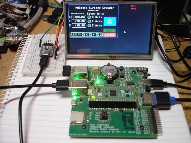

G'day Bryan,
The "graphics" are just to indicate what the jog buttons are going to do, they are not buttons, it was just an idea and they should be another colour I guess.

Now I just tested those push buttons and all of worked then got another white out so that part of the code is working nicely.

Those white outs did come at odd times a few times when the USB is connected the LCD shows the serial stream then when I used the run command it did it, now also a few times after using the touch screen a couple of times it did it also.
Now when I finally got the Z axis calibrated and found that 0.55mm backlash drift it worked for a good 10 minutes so I will put some cap's on the breadboard tomorrow and use the 4 0ff AAA batteries to power the LCD as that could be an issue.
Now when I was using the ILI9488 I didn't have a white out once and when I got the 4" LCD it was a straight swap out so all the wiring was still in place.

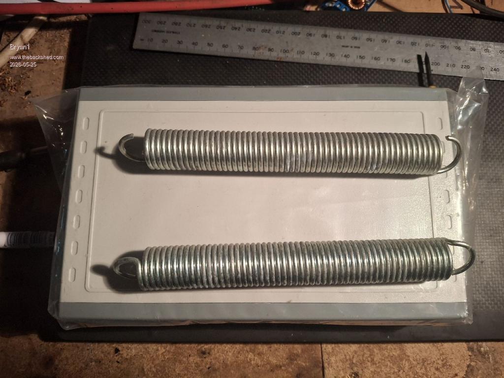

Well while walking up my shed this morning thought about those heavy springs I had in my shed
So I do think they may be strong enough to take the slop out of the Z axis so I will fit them and give it a try.
Also shown is the project box I will be mounting the LCD screen on and the PCB's can also go in there and I'll make a mount so it's easy to see on the surface grinder.

Those springs look like they will be up to the job    My little sis had a trampoline but in the end all the springs went missing, me and the old man had better uses for them
Some further thoughts, if you say you are getting 1mm travel with 6450 steps at 8000 steps / REV that means 1.24mm pitch leadscrew, that doesn't sound right
A simple test would be to draw a line on the coupling (or use the grub screw as a reference) and see if it does 0.8 turns, otherwise something is up s**t creek.

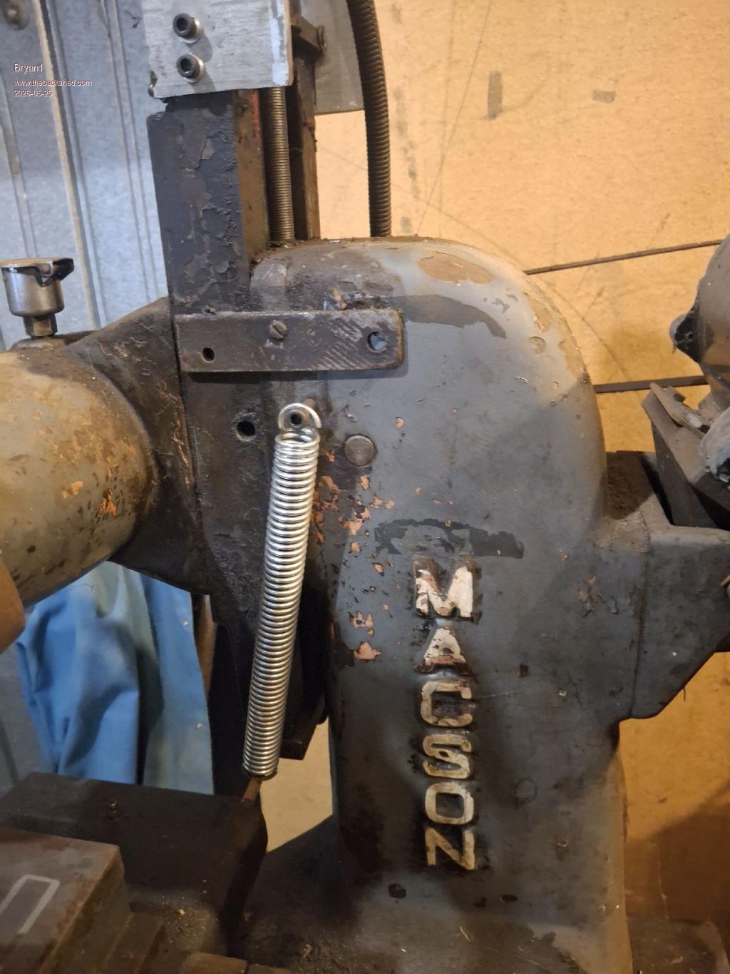

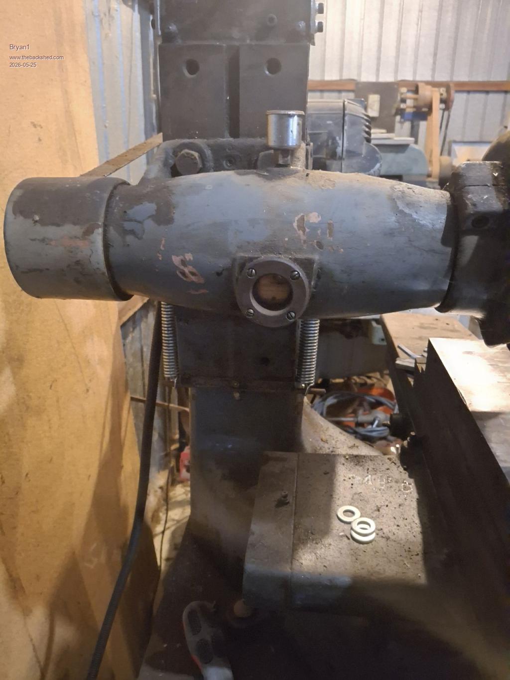

Very nice Lyle   Just did a test with these springs and I reckon the drift is now under 0.1mm on average, now it could be put in the code when the Z axis goes down it goes straight backup to putting pressure on the thread. I did measure 1.6mm backlash using 1mm of travel and my metric dial indicator which does let me see the drift happening.
Now for the top of the springs there is a 1/4"BSW thread so I put longer set screws in to accommodate the springs. Now on the rear there was a hole at the same height so the springs are balanced.
For securing the other side of the spring I just used some 1/4" round bar and it sits nicely under the bottom plate.
Now just tested on the up travel and the coupling does go about 0.8 of a turn and it's the same on the down travel after the backlash is taken up.
