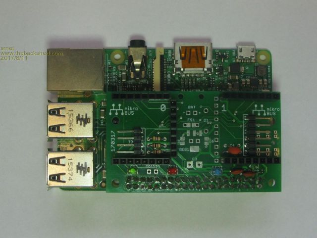

srnet
Joined: 08/08/2014
Posts: 164
Posted: 01:10am 29 Jul 2017
I have MMBASIC running on a Pi2 and I can run a simple Blink program.
I then moved onto trying to run some of the programs I had written for a SPI device, the Semtech SX1278.
The SPI is started with;
SPI OPEN 10000000, 0, 8
And this causes an error;
[158] SPI OPEN 10000000, 0, 8
Error: Already open.
There is only one SPI OPEN in the program.
What am I doing wrong ?

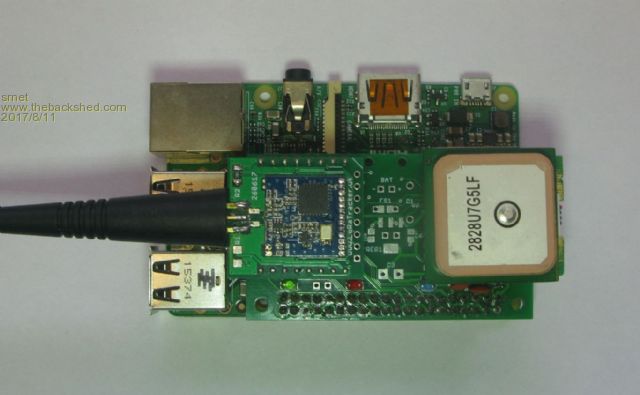

srnet
Joined: 08/08/2014
Posts: 164
Posted: 12:27am 11 Aug 2017
I got it working, I had not appreciated that you had to start MMBasic, then delete the options file and then load a program.
I did notice that if you quit from MMBasic and then restart it, it behaves as if the option file exists, although its not there.
I have written some LoRa code in Arduino, but I wanted something more user and language friendly to use my Pi Mikrobus shield with. I thought of Python of course but it runs like a dog.
For the comparision I timed a program that reads and prints to console the contents of the SX127x LoRa device registers, there are 128 of these in the SPI device.
The timings were;
Arduino Pro Mini 8Mhz, 0.031Seconds
Pi 2 Mikrobus HAT,900Mhz and Python, 7.44Seconds
Pi 2 Mikrobus HAT,900Mhz and MMbasic, 0.19Seconds
So in my view Python on the Pi is un-usably slow but MMbasic is OK.
