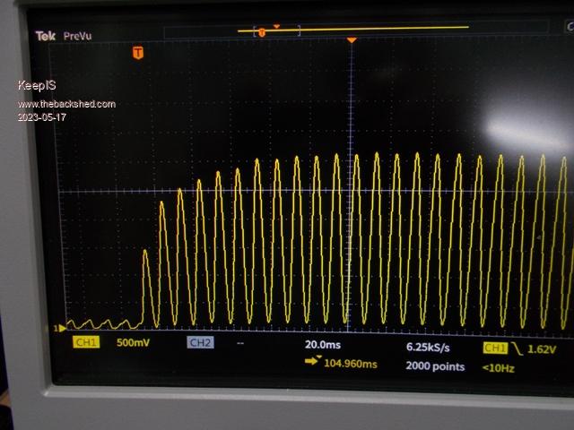

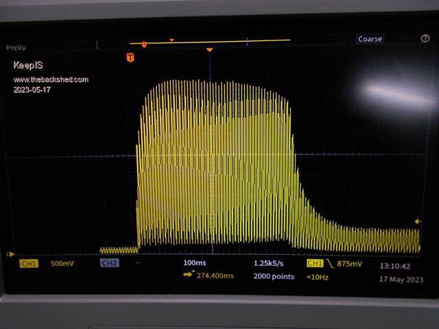

Now that the Inverter is running perfectly, I decided to get some Data on the DC input currents for this inverter Board compared to the Standard 8010 driver board.
The results are interesting: The Test setup is the same as before:
1: A 500A C2T unidirectional Hall Current Sensor.
2: 100Mhz DSO.
A: The DC input waveform was very clean compared to the Old Driver.
B: The Current drawn was a bit less on the Dust extraction.
C: I have to investigate further (not going to speculate) on the initial start up Stall surge current.
It appears that when the stationary induction motor and load are dumped across the inverter, for the first cycle the peak surge current starts out low and builds to maximum start surge current by around the 4th cycle. Not so much of shock to the FETS.

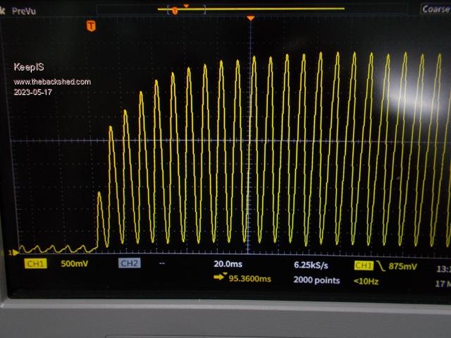

Below: This is the compressor startup - 535A - 21kW
The 5 tiny pulses at the start are around 350 watt general running load, then the 3HP Compressor is powered on. The very sensitive LED fluros give a momentary tiny flicker.
Below: This is  the DE startup - 392A - 18.2kW
This is slightly less then with the old inverter driver. The 4 tiny pulses at the start are around 350 watt general running load, then the DE starts up.

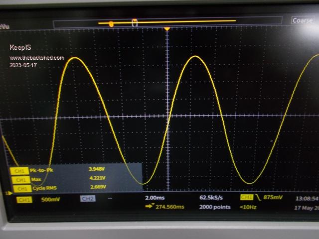

Below:
This is the DC current waveform into the inverter running at 534A and 21kW of load:
Each cycle is one half of one AC sinewave, two DC cycles for 1 pos to neg excursion.
The repetition rate is 100 x 540A pulses per second of peak DC current.

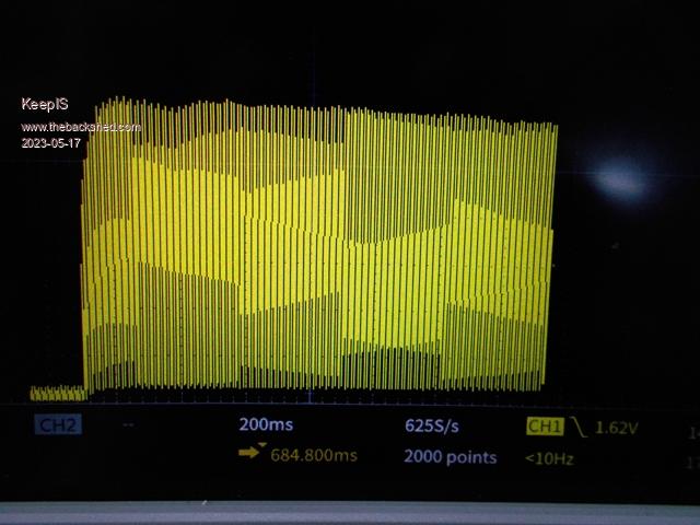

The following shows the duration of the load start up and it falling to Run current.
The compressor - 530A DC input, that peak load is around 600ms long before it drops off.
Below: Part of the DE load with what looks like FET drive waveform ripples in the Image.
The complete waveform (this is only a portion) is almost 3 seconds long of 392A /  18.2kW needed to start the DE. (Exactly the same time as on Mains AC)

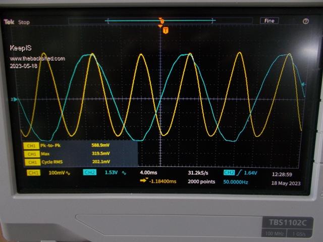

Some Choke testing no load, 350w load, 2.3kW load and 12kW startup load.
To cut to the end, the choke requirement remains the same, but minor improvements to the waveform can be noticed at Idle without the Ferrite 1/2 of the Hybride choke.
Bypassing the Ferrite makes a slight change to a small kink in the Leading waveform of the DC current input swing, but that's it.
This inverter uses two chokes, one in each leg of the Toriod.
Choke A: Hybride of Ferrite E-Core at around 16uH and a Toriod 4 stack of 16uH in series for a total of 32uH, saturation around 180A from memory.
Choke B: 37uH 10 Stack Toriod that does not Saturate even at 600A.
Light loads (350W) shorting out the Hybride makes a minor difference to the waveform. Shorting out the 10 Stack makes almost no difference.
2.3kW loads. Shorting out the Hybride makes a difference, the waveform is not as crisp and the DC input waveform is slightly distorted.
Bypassing the 10 Stack choke is a bad idea, DC input waveform is pulled and leans a little, AC output is still fair but the Toriod is not happy, changes from silent to a slight buzz at 2.3kW load. (that's with the hibride 32uH still in circuit.
The photo of 2.3kw load, AC output (blue) over DC input current waveform (yellow), notice the DC input waveform is twice the frequency of the 50Hz AC output.
1: The Flat top on the AC is from the Loads, not the inverter.
2: The Mains AC powering the same loads is exactly the same.

12 kW startup: The AC and DC input waveforms are both perfect under 12kW startup loads.

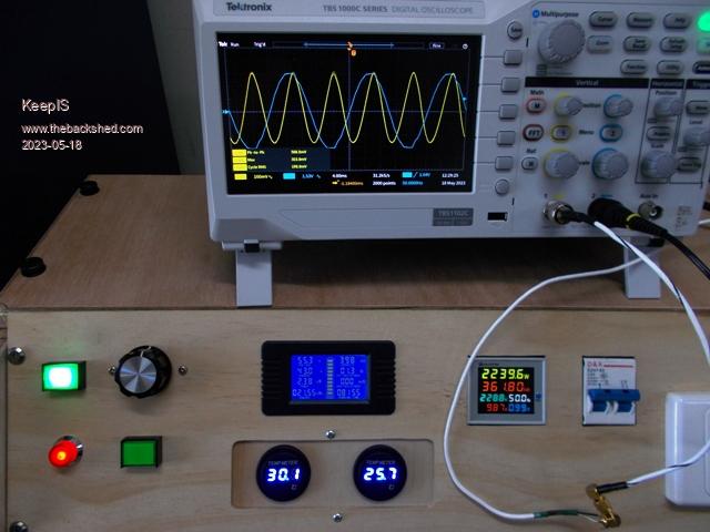

EDIT:
Took a quick snap of the front panel after an hour running at 2.3kW to 2.6kW:
AC volts: 228v
DC power: 2.38kW
AC power: 2.24kW
This is a complex load so not that accurate to calculate efficiency.
Note: No Fans running or started since yesterday morning, it's been running all night and day leading up to the hour long workshop gear being used as above.
Core Temp: 31 deg
Heat transfer Bars: 25.7 deg
Yellow: DC input current waveform
Blue: AC out to load.
The 3 position switch with Black silver knob is: OFF - AUTO - ON
In AUTO, the Inverter is started and stopped depending on the state of the Public AC supply [mains]. It's automatically transferred from Mains to Inverter [Mains Loss] and back, depending on the Priority switch setting, [Mains or Solar priority] transfer is via an external Transfer box.
Top Green LED: AUX 20V indicator, also indicates AC output from the toriod.
RED LED: 8010 Status LED
Green LED/push switch, next to RED LED: Over current trip LED indicator and reset switch.
Edited 2023-05-18 15:57 by KeepIS

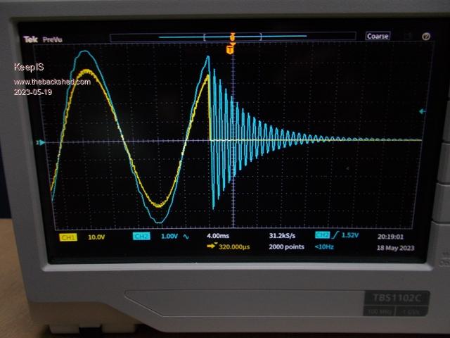

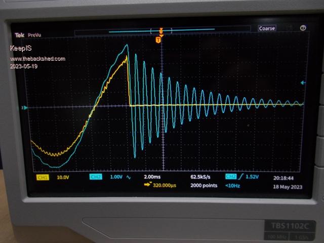

I've been looking at waveforms again, Primary current, and Across the drive output to the Toriod transformer, but dam you have to careful, a Digital DSO can lead you astray with the way they trigger and display the waveforms. You can end up chasing something that's not really there. I'm sure the real expensive units are a lot better, tomorrow I'll get out my Analogue CRO with Digital storage and make sure of what I'm looking at, that can't and never has fooled me.
It seems to me that the choke setup, and the values I have chosen, seem to be hard to beat. In both types of inverter driver configurations, I had expected to find this as it's not a black art. If there is no underlying wiring error or fault in an inverter that you are trying to cover with a choke, then the values, the reason for the choke, and why they work, should not change..
However I think the Ferrite E-core might be slightly increasing the Decaying sinewave I posted earlier, when the Drive is abruptly stopped at power off. However it appear to be completely harmless.
It's hard to catch, and I've been lucky enough to catch it again while monitoring the drive to the Toriod and AC output, both locked and gated, even have a screen capture.
It has confirmed that the ringing is solely in the Transformers decaying magnetic field.
Edited 2023-05-19 09:39 by KeepIS

Posted: 01:29am 19 May 2023
This is the ringing in the Toriod at the point when SPWMEN is driven LOW.
I've never caught it at Crest disable before, looks to be around 1kHz.
Toriod does not make a sound, No Load. Likely it would be swamped with a load.
When you think about it, after 10ms the ringing is virtually nothing, about half of an AC cycle.
Yellow trace: Between the HI/LO drive feeding the Chokes and Toriod transformer.

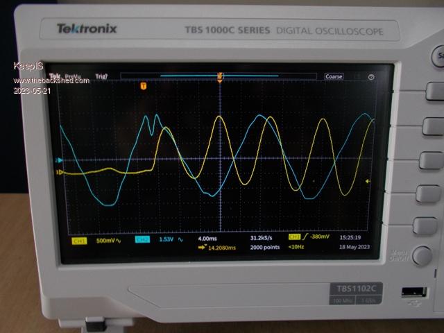

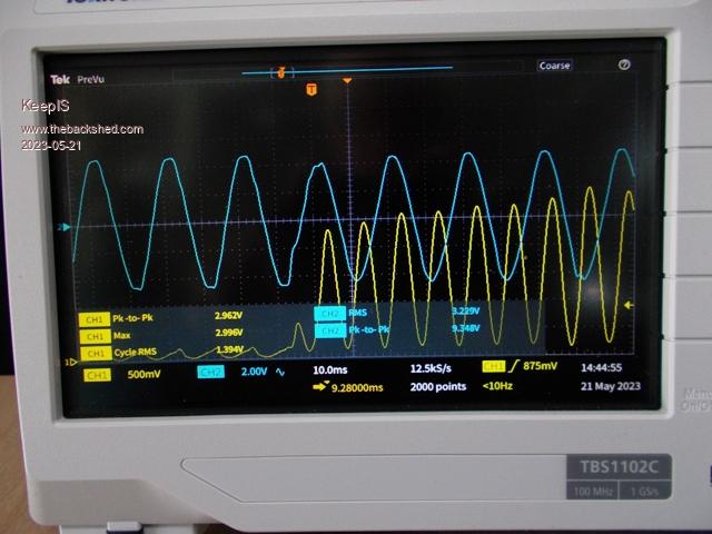

I left the previous post as is, it shows that eventually you will find a load that really helps you make the final choice for a Choke, but for different reasons, it also shows IMHO, that something like a 10 Stack Hi saturation 37uH choke is the starting point to work from, play all you like, as I have done, but I would never run my inverters without that choke.
Soooo... right on Que, I finally find a load that behaves differently on the New Inverter Controller.
The Air-conditioning unit in the workshop: A Fujitsu reverse cycle Inverter.
First time running this inverter, it's cold today: I was out of the shed when it ramped up, my wife came over to tell me the AIR Con was making a loud buzzing noise and something was beeping.
The Chasepower UPS which keeps my programming PC and two 32" monitors running no matter what, was having a hissy fit and was the cause of non stop beeping, it's very sensitive, there is a name for that now but I'll stay within the bounds of political correctness.
It was the inverter that was buzzing loudly, AC power out was around 2.3kW, lots of other light loads running as well.
Temps were normal, DC input current was fine, everything was electrically happy.
Put a DSO on the AC out and had a waveform similar to the Heat-gun pulling power from one half of the AC cycle, it has a Diode in series with the Heater winding on low.
It was also ringing at the point of waveform disturbance. I've posted a picture previously, that time, nothing I did made any real difference to the waveform, however this time there was big difference when testing choke combinations.
Bridging out the 4 stack toriod part of the Hybrid choke, leaving just the Ferrite choke in circuit, and it made a bit of an improvement and quietened the 3 stack Toriod transformer about 30%, bridging out just the Ferrite E-Core made a huge difference and reduced the buzz considerably more - both chokes are around 16uH.
Once again that difference between choke materials.
I bypassed the Hybrid completely: The Transformer was silent, the waveform was almost normal but for a very slight kink on the affected part of the cycle.
Primary current went up a fraction when the Hybrid was bypassed, the inverter was running at 2.3kW as I was testing the combinations.
Switched off the inverter and bypassed the Hybrid choke correctly, then powered it back up.
Silence.... with the AC and 2.3kW loads running. I took the gamble and started the Dust Extractor, that's a 400A DC peak input - 12kW AC on top of the 2.3kW Inverter load.
Perfect... Not a peep from the UPS, the toriod transformer gave a gentle hum just at the start of the 2.5 second duration 12kW surge load as it was dropped on to the 2.3kW running load. Final running load with Dust-Ext spun up was 3.8kW, the Inverter is silent.
NOTE: I had determined on previous tests that the Ferrite E-Core was causing the ringing in the transformer at power off to be SLIGHTLY increased, but as it appeared to be the only effect, I wasn't going to remove it.
EDIT: In the NOTE above, the difference I saw was because the cutoff point was slightly lower when checking. I have just tested the Transformer ringing when SPWM output is disabled on power down, there is None, Zero, and NO change at  all to the ringing as the Transformer field collapses "under no load".
Under load, the oscillation [ringing] is quashed. Currently my inverter output automatically switches to Mains when it's powered off, a possible reason why I noticed this and Mike didn't?  Mike [wiseguy] has the only other running inverter controller and power board like this, it's his design, but he's had little time to fully play around with it..
So ... The Chokes were innocent.
The Take away: The overall sweet spot for this inverter driver is now: One 10 Stack 37uH choke with a saturation point higher than 540A peak DC input, I believe that the FET switching currents could be a lot higher than this depending on the % of PWM drive width [on time] and like almost everything else, that varies with each inverter build configuration.
BTW None of the other newer "inverter drive white goods" and other equipment has caused any issues, not even our big inverter microwave, only the AIR-Con pushing HOT air.

So, for anyone interested, this is the difference between starting the 3hp Dust extractor with the hybrid choke removed, not quite the same time frame, but it's still interesting.
Blue trace AS output.
Yellow trace DC input current:
The first capture was centered (AC coupled) with the AC sinewave, the second was DC coupled, this is a unidirectional DC Sensor, so it only produces output in one direction, each vertical division is the same value in both.
The extra choke was definitely reducing surge current and changing the ramp up curve, at the same time making the AC output go a little strange.
Below: Two Chokes start up:
Below: One 10 stack 37uh choke, this is what I'm using now in the inverter:
I have also started the 3Hp Compressor at 530A DC input, it draws more current on the first 2 cycles with one choke, but it's a very clean start and the UPS does make it's normal beep of complaint. Very impressive - no smoke ........... yet!

Looking at the screen captures of the Choke startup compassion, the slope of increase in current is about the same, using AC coupling for the Sensor is just causing it to float around as the DC level rapidly changes in the first capture, but the main point was the difference in current over the first few cycles.
