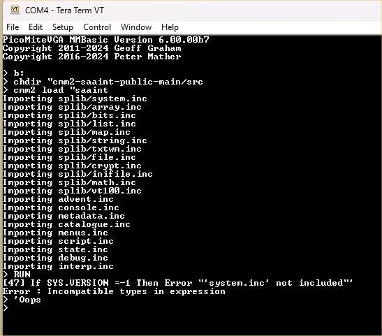

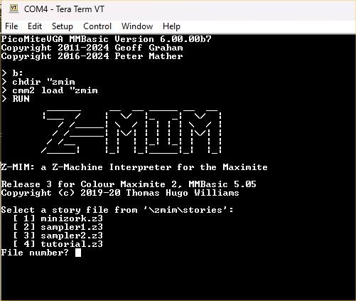

Kevin: Can you either create a simple demo program or try your program again with fewer circles and/or smaller circles and let me know what happens - thanks

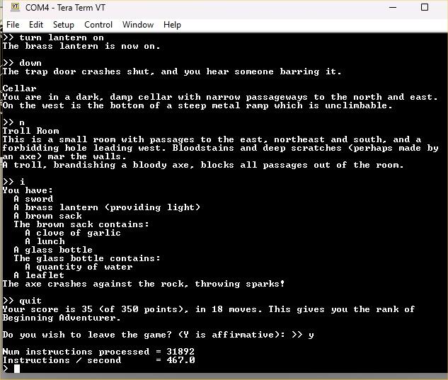

PicoMiteRP2350V6.00.00b7.zip
This one is for Tom
new commands:
CMM2 LOAD fname$ [,R]
CMM2 RUN fname$
These commands load and/or run programs whilst supporting the CMM2 directives
#DEFINE
#INCLUDE
#COMMENT START/END
#MMDEBUG ON/OFF
The program is loaded and crunched as per the CMM2 so if you edit the loaded program you will see it without any spaces and or comments and with the INCLUDE files inserted in-line.
If using these it therefore makes sense to only edit the individual source files off disk and back onto disk
EDIT fname$
This loads but doesn't run due to reuse of same variable with different type
This runs beautifully including my #define hacks

Hope you don't mind me posting Tom - could be added to the games thread?
zmim.zip

Posts: 8966
Posted: 12:45pm 21 Sep 2024
Text adventures on a Pico.. :)
I'm in love....  <swoon>....

Posts: 4378
Posted: 03:19pm 21 Sep 2024
  matherp said  This one is for Tom
If the intent was to distract me then you did so at least temporarily.
CMM2 RUN fname$
Nice additions.
  matherp said  This loads but doesn't run due to reuse of same variable with different type
Looks like I'd left the SAAINT source code in an unstable state .
I've done a quick fix for this and if you update your clone (you may need to do a forced update) or download a new zip then this problem will hopefully be resolved:
- https://github.com/thwill1000/cmm2-saaint-public
- https://github.com/thwill1000/cmm2-saaint-public/archive/refs/heads/main.zip
HOWEVER when I last looked at it on real RP2040 hardware it would report OOM because its use of strings is very naive. It should easily fit (the original games would run in 16K), I just never got around to implementing more efficient read-only string storage. It may run unaltered on an RP2350.
With regards Z-MIM I'm not entirely certain which memory-model you've built with, I suspect it might be the one where the entire story file is held in RAM, in which case IIRC the RP2040 has enough RAM to run "minizork" but not any of the proper Infocom .z3 story files. I'm afraid it is yet another thing I need to look at, my plan was to load the read-only parts of the story file into a flash slot.
  matherp said  Hope you don't mind me posting Tom - could be added to the games thread?
Of course I don't mind. I was holding off posting them myself until they were properly working on the Pico (if/when I get around to it), but I don't object to someone else posting if they want to.
BTW did you get my email about LOAD BMP ?

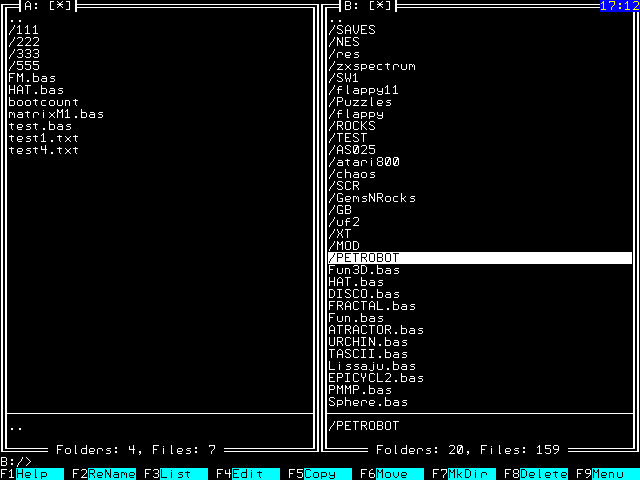

Posts: 5995
Posted: 12:02pm 22 Sep 2024
Peter,
If there is one thing from cmm2 that would be much appreciated, it is a way to browse the sd card.
A filebrowser. Ideally that would be one that can also move, copy files ( a 2 pane browser like midnight commander. But the cmm2 browser is also fine, with its build in file associations.
I remember there was midnight commander alike browser written in mmbasic for cmm2.
Anyway… a file browser for picomite would be great.

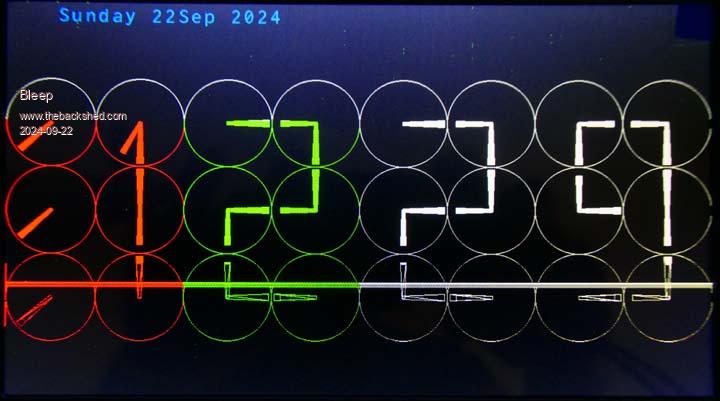

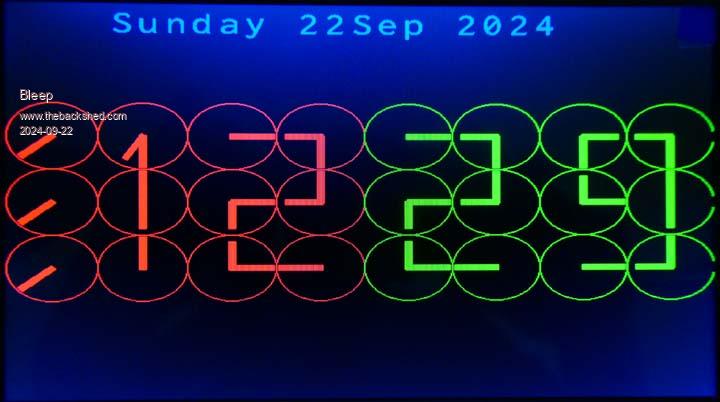

Bleep
Joined: 09/01/2022
Posts: 817

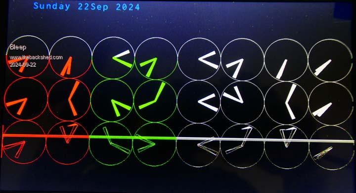

Posted: 12:08pm 22 Sep 2024
Hi Peter,
In B7 and B8 Framebuffer now works fine. However I get the following.
I have only adjusted the positioning and size of the clocks so far, not bothered yet to correct the tiles for colouring.
Wide Screen Mode 1 B9
The horizontal and vertical bar appears to be the fill from the lower line of clocks gone awol. The hands are being drawn from a Ploygon command, which draws multiple hands at a time from arrays. I get the same with or without Framebuffer.
With the hands moving you can see the origin of some of the hands being at 12 O'clock
This is what it should look like in Non Widescreen.
Edited 2024-09-22 22:21 by Bleep

Peter,Volhout,
I would also like to have a file manager built into PicoMite, like a built-in code editor, so that it could also work in the terminal.
I even started making one in MMBASIC, but it is not finished. It only does not work for editing and launching programs.
FM - File Manager.zip
Regards, javavi
Edited 2024-09-23 00:28 by javavi
