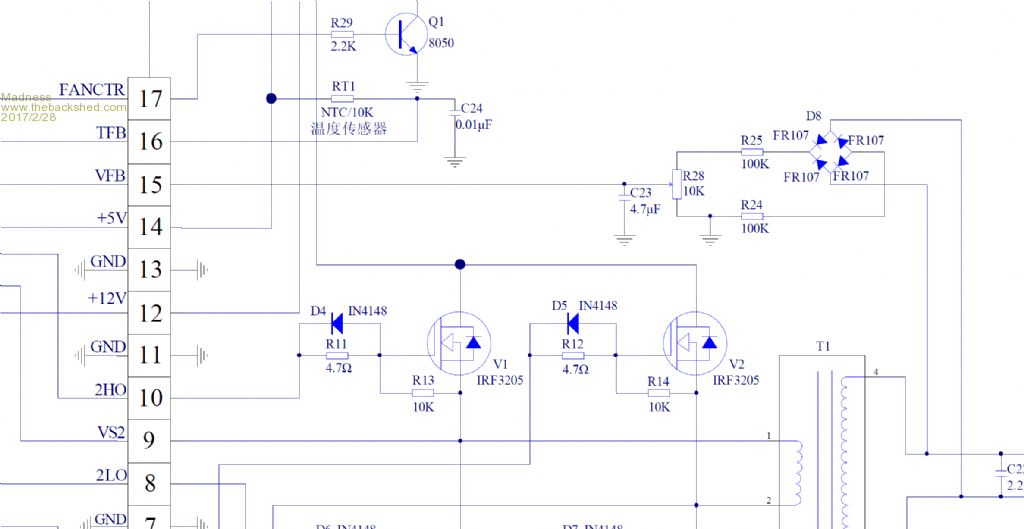

Hi madness. I think I'm on the trail of something with our inverter problems. Perhaps you could check along the same lines and between us we *will* solve this frustrating conundrum.
Anyway, I just perused (again) the application notes for the EG1810.
On page 12 under "AC Output Voltage Feedback" I found two things that are different on my PCB.
The first "A filter inductor needs to connect to SPWM output port" I have not done that. Its not on the little EGS002 boards either and oztules also does not have them on the PCB screenshots he posted a while ago.
Do you think that's worthwhile to investigate? If so, what size inductor? I think I'll get some of those little ones that look like a resistor and try them.
The second, and IMO more important, difference: "voltage feedback is through measuring the AC voltage output of inverter."
Here I just reverse engineered what oztules had on his PCB which obviously works.
He rectified the output of the little 12V transformer.
But then its no longer AC that gets sampled!
I think the 8010 is looking for an AC waveform on its VFB (pin 13) input. Presenting the DC ripple of rectified AC 'might' work but it also might not. I certainly will now go and try that.
If I am right then I will post an altered schematic here later and I'm sorry for not picking this up sooner.
Now lets see what else I can find, I'm almost convinced something is wrong with the signals driving the gates rather than with the Mosfets themselves.

Hi Klaus,
Just looked at the circuit in the EG8010 data sheet and I can't see the inductor you mention in the VFB circuit, as far as I know it is DC and needs 3 volts at the chip. In the EG8101 data sheet on page 12, I can see a circuit there with the inductor which is the choke that we are using, sorry if I am missing something here. For testing, I have connected the 12V supply to the diodes on the Oztules control board. This allows me to have the control board running on it's own. I am using this to test the Gate drive boards I am making with the TC4452 chips. The PCB's are just 22 X 26 MM, the chips have just arrived. Tomorrow I have time to work on it, fingers crossed I will have a positive outcome.
Warp I know the EG8010 chips I am using came from the same supplier as Oztules so a good chance they are the same. I doubt they are the problem though as I get good results with a limited number of FETs. But until I get it right I do not know what they problem is. Hopefully, the TC4452's with more grunt will make it all work the way it is supposed to.
Posted: 10:15pm 27 Feb 2017
Hi Gary,
The manual is not worded very clear with regard to the inductor.
As I read it there should be a conductor at each of the SPWM out (pins 27-30) of the 8010.
But I might be wrong.
The other thing, look at the circuit schematic on the EGS002 datasheet (you'll need a magnifying glass). The VFB (pin 13) samples the **AC** of the transformer output.
We put a little 12V transformer there to isolate this sampling from the high voltage side.
But its still AC that is being sampled, there are no rectifying diodes used on that circuit, neither are there any in figure 8.1a (page 12 of EG1810 datasheet).
So, why did oztules rectify this feedback voltage?

On page 10 we have diodes, there is no transformer but we know Oztules added it for a good reason that caused him problems when his batteries got wet. But what matters is diodes = DC.
This version is low voltage with a transformer same as we are building. The Chinese manuals are not perfect either so you are right to doubt everything.

Gary, I cannot find that page. Any chance of the correct url?
The manual I look at (EGS002) only has 6 pages.
The one for the EG8010 does not have the schematic above.
It must work with AC fed into the VFB input as well or the schematics I can see are all wrong.

The EG8010 Datasheet is here this from EGMicro. This is the version of the documentation that I took the image from.
If you have a look at the EGMicro download page you will find other incarnations of the circuit using different driver chips, no doubt this will keep you occupied for a few hours.
If you can read Chinese there is a version 2.2 of the manual, the circuits, fortunately, are in english.Edited by Madness 2017-03-01

Right, the transformer on the VFB is only necessary if you have an earthed system. Look at the circuit provided by madness... it is obvious that any earthing regime will short out one side of the voltage splitter... and your unit will run between 240 and 120 v depending on the impedance to ground of the battery bank. A isolating transformer fixes this... otherwise an opto would do the same thing.
The VFB uses DC to control the AC output.

[quote]Right, the transformer on the VFB is only necessary if you have an earthed system. [/quote]
I would think a small transformer would be a must in any system, grounded or not.
You cannot assume the output will be split or floating and provide a nice symmetrical voltage to your diode bridge. It might work fine like that tested on the bench, but with real loads and external wiring connected there will potentially be leakage to ground in many places, and it may be very unequal on either side of the system.
Fit a transformer to completely isolate the feedback voltage, its then one less thing that can potentially go wrong.

Thank you gentlemen, very useful info above, as usual.
I *do* have that little transformer isolating the VFB from the mains.
What I was querying is that most of the 8010 circuits do not have a DC voltage VFB, only the one circuit madness posted (and oztules) has that.
So the 8010 must be able to control the VFB even if its AC (from the secondary of that little transformer).
And it seems to, there was no ill effect when I tested mine with lo voltage AC at VFB, sans any Mosfets connected to the gate driver.

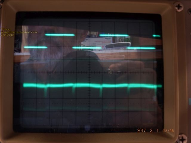

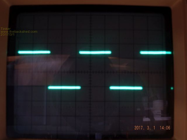

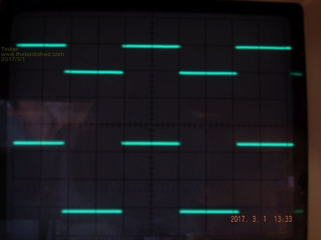

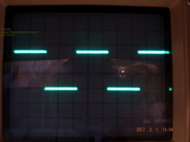

Today I was testing if there are any problems with my inverter electronics.
No Mosfets were connected.
To give the TC4452 chips some load I connected a 2700pF capacitor between the gate & source terminal.
I used 2 isolated DC/DC converters (12V-12V)to get the high side drive voltage. I had these left over from another project, they seem to do the trick even if only rated at 250mA each. I consider using them permanently instead of the charge pump idea. Reason being, the TC4452 gets powered up *before* I turn the gate drive on.
Here is a pic of what happens at the IR2110 LIN (top trace)and LOUT (bottom trace) terminals: 5V/div, time base = 5ms.
Its too difficult to see the 1us dead time but the traces have no visible overlap.
Pics from the high frequency side did not turn out sharp and made little sense to me:
Here's the signal at the capacitor (LO side chip, 1LO) I'd connected to the TC4452 output:
And here the same at the capacitor (LO side chip, 1HO)
Any comments are welcome, as usual.

Today I was testing TC4452 driver PCB's I have made to add to the existing 24 FET boards I have. I did not get to try driving the MOSFETs yet as other things got in the way as usual. I did get very good waveforms at slightly high levels than the input from the IR2110's.
Klaus if there was any shoot through, ie no dead time it would have to show on your CRO as spikes. You will need to drive some FETs to try this, as Oztules mentioned using a test board with no caps and a series resistance on the power supply won't blow FETs if the signal is crap. This has saved me a few times now testing the control boards and drivers.

Posted: 11:01am 01 Mar 2017
Great stuff guys.
Yes you need a current limited supply without any brutal energy storage capacitors, and any really violent shoot through current spikes should really stand out.
There are also some tests you should do on the microprocessor board to make sure the designer did not screw up with that.
The problem with any software operated device is that it needs to logically follow one instruction after another without the program crashing. Any idiot can write software that runs, but how it starts up and shuts down under very marginal power supply conditions can lead to the not unknown problem of "blowing up" every now and again for no apparent reason.
So connect up the microprocessor board to an adjustable 0 to +5v supply, and run your power bridge through a very small fuse at low voltage. Just enough so that if the gate drive waveforms go momentarily spastic, the fuse will blow without doing any real damage.
Then try VERY SLOWLY increasing and decreasing the five volt supply to the microprocessor. If the circuit designer was on the ball, you should be able to do this all day without any mishap.
The processor should have an under voltage sensing chip that holds the processor in reset until it has sufficient supply to start running in an orderly way. That is almost never a problem.
What can be a problem is if the voltage sags and the software crashes. Getting it to always shut down in a safe manner can be a bit more challenging.
If it does go pop when you turn the power off, you will never know until next time you turn it back on.
"Oh it blew at power up". Maybe, or maybe it really blew at last power down. No way to really know for sure.
So give it the power starvation test, and then at least you can have a bit more confidence in something someone else has designed.

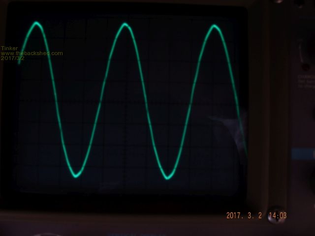

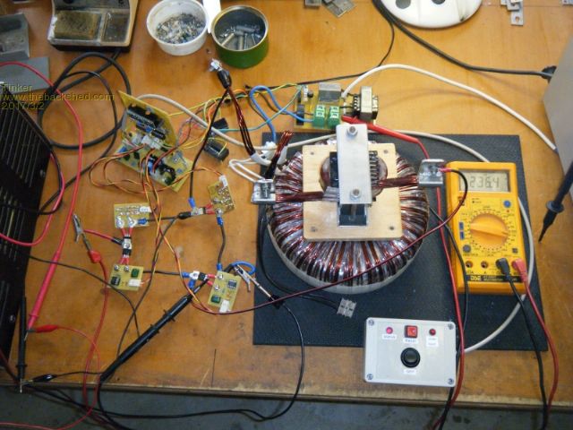

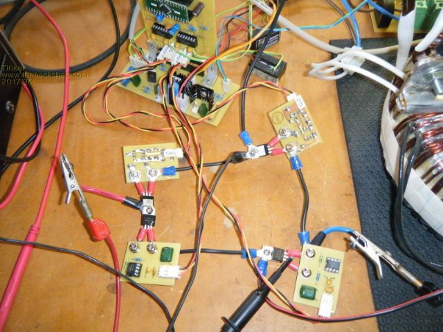

Posted: 11:51pm 01 Mar 2017
A bit more fun with testing today.
First I rigged up My little gate driver boards to some 4110 Mosfet chips and connected the lot into a full bridge inverter.
The close up pic below shows the little DC/DC converter blocks I use for the high side power (top right)
Then all was powered up, voltage & current measured and I got a nice AC output on the scope.
While I was probing around with the CRO probe the inverter just died suddenly.
No bang thanks to no caps fitted and limited current supply. Turns out just one of the 4110 chips had developed a D-S short. No idea why.
Replacing that one all worked again, of course with no load since there is no heat sink. So far I could not get it to fail again.
It occurs to me doing a soak test for each chip might be a good idea, especially if there are 4 or more in parallel in the final inverter.
So I'm making a little 4 chip test rig with screw type terminals for quick Mosfet connection. The 5mm spaced terminals will suit the HY4008 chips perfectly.
No caps, no heat sink, just for checking the reliable operation and supply voltage endurance.
Leaving each set of 4 on for a few hours, with many times on - off switching, should weed out the crappy ones.
I think I'll continue using the gate driver chips for the HY4008 experimenting. Even the 4110's took the extra gate drive through a 1 Ohm resistor with no complains.

I want to share some information about the operation of the EG8010 I have discovered today. It seems some people here might want to know how a bit more about how Vfb works.
I performed a simple test, feeding Vfb with a DC signal at about 3.05V with a short 1ms pulse 90mV higher. I sweep this short pulse over the entire 50 Hz time frame.
I thought this might show how the EG8010 samples Vfb and when it samples it. Or maybe it will show that the EG8010 samples Vfb many times throughout a 50Hz cycle...
I knew that Vfb was only looking at DC, from earlier tests as outlined in the EGS002 manual on page 5. I suspected that Vfb was sampled within a short or narrow window each 50Hz cycle.
This experiment shows that this is the case.
I made a video showing a complete sweep of possible sample times of a 50 Hz cycle and you can see exactly when and where the pulsed input of Vfb effects the output.
Right at the top of one half of the 50Hz output. Pulses as narrow as 1% of the 50Hz (i.e. 200ns) clearly effect the PWM output.
See https://youtu.be/SdkPxG5mNOY for the results.
Our voltage feedback designs will need to take this information on board.
I believe Vfb is sampled only within a very narrow window, maybe 200ns each 50Hz.
On another forum I posted my findings from playing with a pure sine wave inverter prototype I built using an Arduino to produce the needed PWM signals, as well as have the arduino control output voltage via a closed loop system using a PID control.
It works beyond expectations and is stable under all my test conditions.
See http://www.anotherpower.com/board/index.php/topic,1228.msg13170.html#msg13170
The point I want to make is that in the arduino code, I sample the output voltage only once per 50Hz cycle, and perform the PID feedback control on that data point only.
It seems that this is the way to go.
