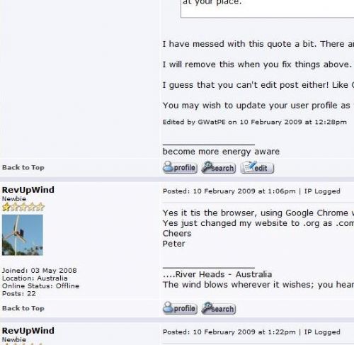

GWatPE
Joined: 01/09/2006
Posts: 2127
Posted: 05:27am 10 Feb 2009
  RevUpWind said   Hello GWatPE, have no edit tab on that incorrect post so cannot remove.
Can you remove it?
I cannot see how this is so. No I cannot edit your posts, but you can. You need to read what follows.
Use the EDIT button at the botttom of the post window, then update post with the changes. You do need to be logged in as well to see the EDIT button.
here are examples. See if you can spot the differences.
The first one is when I was not logged in.
This one is when I was logged in.
It is not really much more difficult than updating your profile, which you have already done.
Gordon.
PS edit: Many readers have edited out posts, so you should be able to as well.Edited by GWatPE 2009-02-12

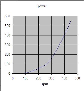

GWatPE
Joined: 01/09/2006
Posts: 2127
Posted: 11:34pm 22 Feb 2009
Hi oztules,
I still have the 24V battery loading at low power levels only. As the wind energy levels rise, and the rotor rpm increases, the generated emf may be sufficient to allow power to feed the 48V grid inverter as well.
So far, for low power levels up to 10W, goes via voltage doubler only to battery. At 80W, 1ADC is via the doubler, and an additional 2ADC is through normal 24V cap coupled rectifiers. At this point the 48V cct just achieves cutin.
This is the measured performance so far.
For each doubling of the generated AC output voltage, there is an 8fold increase in the power to the load. This is sort of what is required from the windmill.
Without the 48V loading, the windmill speeds up more, and the tsr increases. The caps on the 24V system do more work for similar output power levels. I have not fully tested this, as the windmill braking becomes enabled as the battery is fully charged, and the capacity of the grid loading at 24V becomes exceeded at these power levels. This is why I opted for 48V direct loading to the grid inverter as well.
