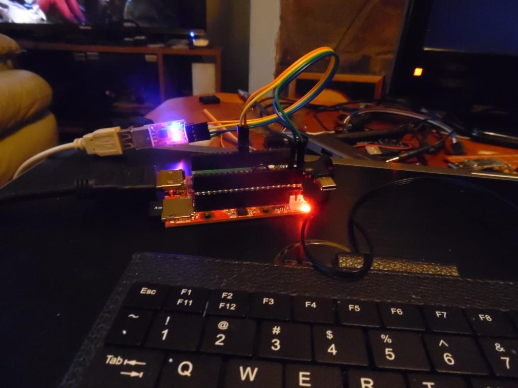

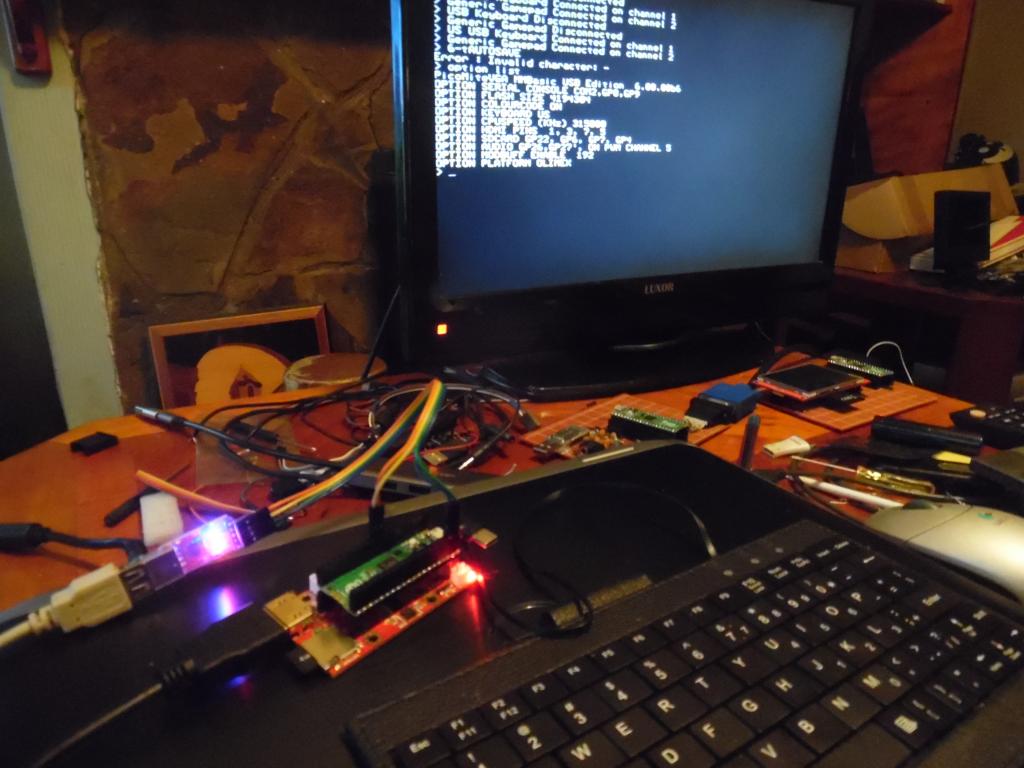

I just got pico2 usb hdmi olimex working.
I used female headers with long leads on the pico2 board and wired the usb to ttl to the header. how to wire the 5V from usb to ttl to vbus to power pico2 and usb keyboard otherwise? asked for feed back... works :)

Posts: 2807
Posted: 06:39pm 23 Sep 2024

Posts: 2807
Posted: 09:19pm 23 Sep 2024
had to wire serial ie usb to ttl to gp8,gp9 . now win mmcc works and mmedit working ok.
pico 2 usb hdmi works... if you got any memory left. mode 3 ok but seems better on vga ie more pixels less overhead for hdmi
