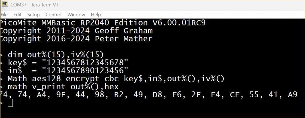

Questions about the new MATH AES128 command
  matherp said  V6.00.01RC9
New MATH command
MATH AES128 ENCRYPT/DECRYPT CBC/ECB/CTR key$/key(), in$/in(), out$/out() [,iv$/iv()]
This command encrypts or decrypts the data in 'in' and puts the answer in 'out' using the AES128 encryption method specified
The parameters can each be either a string, integer array, or float array with any mix possible
The key must be 16 elements long (16*8=128bits)
in and out must be a multiple of 16 elements long.
In the case of out being specified as a string (e.g. out$), the string variable must exist and should be set to empty (DIM out$="")
The maximum number of elements in 'in' and 'out' is 256 when defined as arrays or 128 if one or other is defined as a string
For CBC and CTR versions you can optionally specify an initiallisation vector 'iv'. 'iv' must be 16 elements long (16*8=128bits)
My test:
> list
'TEST aes128 cbc
out$ = ""
key$ = "1234567812345678"
in$  = "1234567890123456"
Math aes128 encrypt cbc key$,in$,out$
Print out$
> run
>ЖCПфdоk
The string input can be ASCII, there is no padding and the correct length must be used. But why is the length OUT so short and does not match the HEX output as on the website https://www.devglan.com/online-tools/aes-encryption-decryption ?
Or should the string also be given in hex?
And is there a BASIC command for base64 conversion?
Matthias
Footnote added 2024-12-21 03:55 by homa
> list
'TEST aes128 cbc
Dim integer out2(15)
out$ = ""
Math aes128 encrypt cbc key$,in$,out2()
Math v_print out2(), hex
'Print out$
> run
5E, 62, B3, 27, 61, C7, 64, DE, 85, 6B, D, 3E, B6, 43, BF, E4
Only 16 bytes? Dim integer out2(31) gives me an error?!

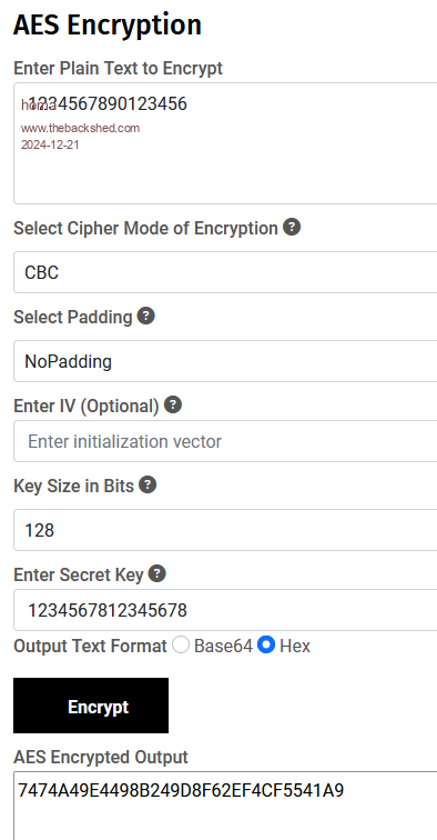

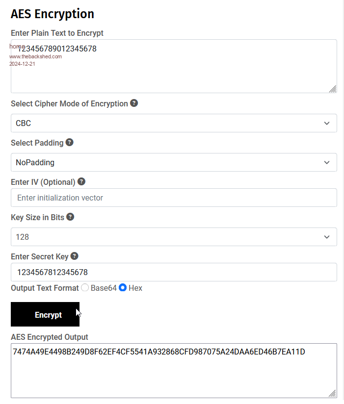

Posts: 11829
Posted: 06:15pm 20 Dec 2024
So many thing wrong
You haven't set an initialisation vector and they seem to be assuming all zeroes - I don't
Trying to print out$ can't work as it contains non-printable values. You would have to take each element in turn and HES$(asc(mid$( it
And then somehow you have got the website to create a 32 byte output from a 16 byte input
My way works
Edited 2024-12-21 04:17 by matherp

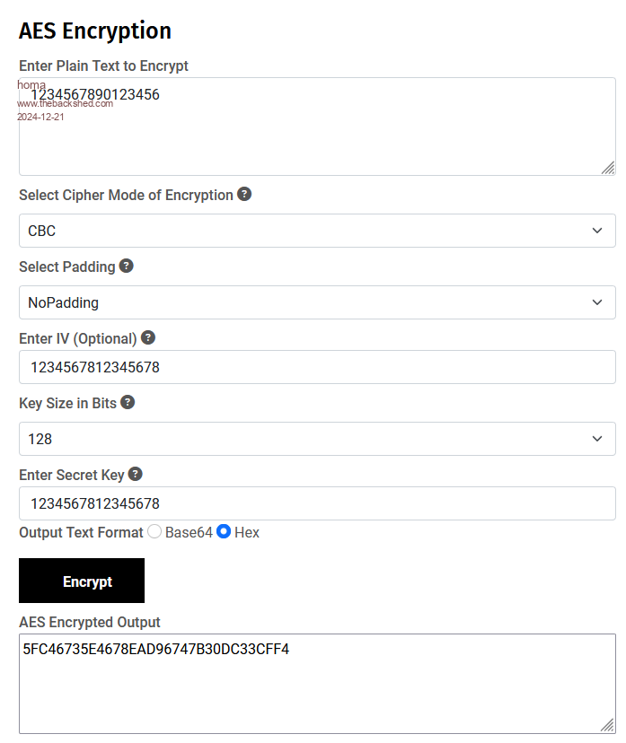

Joined: 05/11/2021
Posts: 685
Posted: 06:37pm 20 Dec 2024
You are right, my first entry on the website was two characters too long.
Here is the correct test1:
> list
'TEST aes128 cbc
out$ = ""
iv$  = "1234567812345678"
Math aes128 encrypt cbc key$,in$,out2(),iv$
'Print out$
> run
5F, C4, 67, 35, E4, 67, 8E, AD, 96, 74, 7B, 30, DC, 33, CF, F4

On the website:
Enter IV (optional) inizialisation vector
And your description:
For CBC and CTR versions you can optionally specify an initiallisation vector ‘iv’. ‘iv’ must be 16 elements long (16*8=128bits)
Why is iv supposedly optional if it is required? Is there a default value that might be missing?
Matthias
Posts: 11829
Posted: 06:39pm 20 Dec 2024
  Quote  Why is iv supposedly optional if it is required? Is there a default value that might be missing?
iv is optional because the firmware has a value built in but it isn't all zeroes as that website assumes. To match the website you have to specify it as all zeroes to override the internal default. Dimming an array iv% sets it to zeroes
