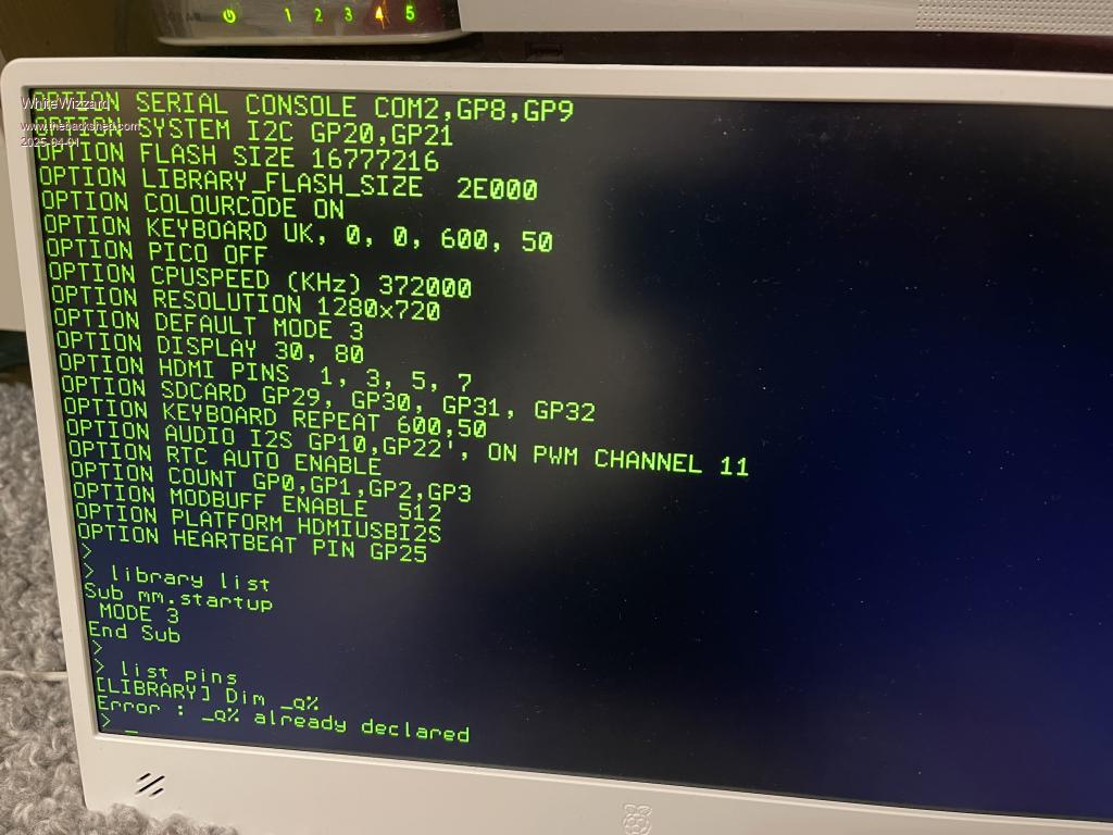

RC8 on one of your  latest ‘reference design’ PCBs (I2S HDMI USB) and am seeing an error (screenshot below) with ‘LIST PINS’.
Note I seem to remember this being reported already so maybe you’ve fixed it but not for RC8?
Edited 2025-04-01 05:52 by WhiteWizzard

Posts: 12068
Posted: 10:03am 01 Apr 2025
Harm: thanks for the report - good news. I just need to post the LIST PINS fix and we should be good to go for 6.00.02

V6.00.02RC9 is available on
Fixes bug in LIST PINS
Removes BIT command and BIT functions
