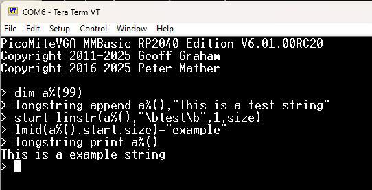

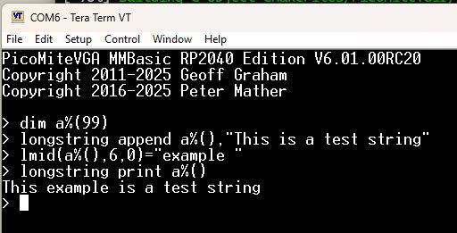

V6.01.00RC20
PicoMiteV6.01.00RC20.zip
Reset the image size in the build making more space available on the A: drive in most cases
Make regular expression processing compatible with OPTION ESCAPE
Changes MID$ command so the length to be replaced can be 0 - i.e. insert the new string at the position specified
New commands:
LMID(array%(),start [,num])=string$
inserts string$ into the longstring array%() at position start replacing num existing characters. If num isn't specified then it is calculated from the length of string$. num can be 0 in which case string$ is inserted at the position specified.
Note how MID$ and LMID together with INSTR and LINSTR can be used effectively to edit text

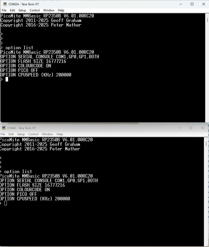

With RC19 and RC20 GP0 and GP1 don't work for COM1: anymore. GP4 and GP5 still work for COM2: though.
PicoMite MMBasic RP2350B V6.01.00RC20
OPTION SERIAL CONSOLE COM1,GP0,GP1,BOTH
OPTION SYSTEM I2C GP6,GP7, SLOW
OPTION FLASH SIZE 16777216
OPTION LIBRARY_FLASH_SIZE  50000
OPTION COLOURCODE ON
OPTION CONTINUATION LINES ON
OPTION CASE UPPER
OPTION DEFAULT COLOURS GREEN, BLACK
OPTION KEYBOARD I2C
OPTION PICO OFF
OPTION CPUSPEED (KHz) 360000
OPTION LCDPANEL CONSOLE ,, FF00,, 20
OPTION DISPLAY 26, 40
OPTION LCDPANEL ST7796SP, PORTRAIT,GP14,GP15,GP13,,INVERT
OPTION LCD BACKLIGHT 20
OPTION SDCARD GP17, GP18, GP19, GP16
OPTION PLATFORM PicoCalc
OPTION PSRAM PIN GP47
Edited 2025-11-26 14:34 by toml_12953
Posts: 11827
Posted: 08:24am 26 Nov 2025
Works for me. Sorry but there is no way I can diagnose a build you are doing with modifications to the source that then doesn't work. I would you suggest you start with my release and do an option reset. and then set OPTION SERIAL CONSOLE GP0,GP1,B
That definitely works on a rp2350B. If that doesn't work you have a HW issue. If is does then you have an issue with your build

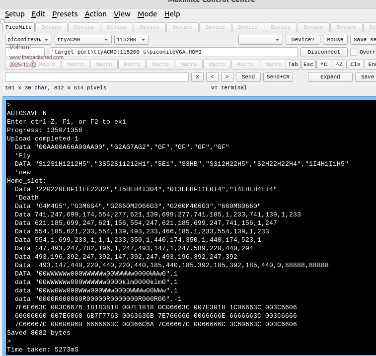

Peter,
I have problems with AUTOSAVE N. Using RP2040 VGA V6.01.00rc21.
When I use MMEdit/MMCC (that uses AUTOSAVE N) to upload a program to the pico, the transfer is very fast. But in many occasions incomplete. And I can't get a grip on it.
When I look at the block counter, it is clear that not all blocks are transferred. And during the transfer, the part that is not transferred is shown in a listing (as if for a part AUTOSAVE was used, not AUTOSAVE N).
It happens at large programs (30+k) but also for smaller programs, such as your recent version of the badapple (in stead of 6k, only 2.5k are transferred).
I have nuked flash, re-installed, this is a standard VGA platform. Using MMEdit on linux, but I did never have these problems before.
Another observation: when I use an older version of MMEdit (5.30) that does not use AUTOSAVE N, since it did not exist at that time, together with the 5.30 MMCC, the transfer of a program is terrible slow. really slow. 300 baud slow. But the setting is 115200 that I always used (I know pico does not obey the 115200).

Posts: 6095
Posted: 07:18am 02 Dec 2025
Hi Jim, Peter,
See below screenshot of MMCC (5.3.7). There is (top) the AUTOSAVE N
Then it transferred 1350/1356 records, and then a piece of the listing of the end of the copied program. I did not invoke that.
The program is not completely stored in memory, and (of coarse) errors.
I will try to replace the genuine pico tonight. I may be the first one to experience flash errors. Note this RP2040 has been programmed at least 1000 times.
P.S. the part of the listing you see is not successive. it is showing blocks of lines that are not successive in the program. But they all belong to the end of the program.
First 8 lines are sprite data, the next 7 are from the music, then there are 4 lines of world map, then few lines of font data. This is picofrog.
Edited 2025-12-02 17:23 by Volhout

Posts: 6602
Posted: 08:57am 02 Dec 2025
The progress counter only prints every 50 lines so 1350/1356 is the last one you will see.
"Upload completed 1" indicates that the upload completed and the pico responded quickly.
Normally seing "Saved xxx bytes" is confirmation of completion.
AUTOSAVE N shouldn't be echoing any lines as far as I know so not sure if it is the pico or my end.
In MMCC.inf at about line 50
Autosave N line delay = 1
change that to 2 or 3 and see if there is any improvement.
