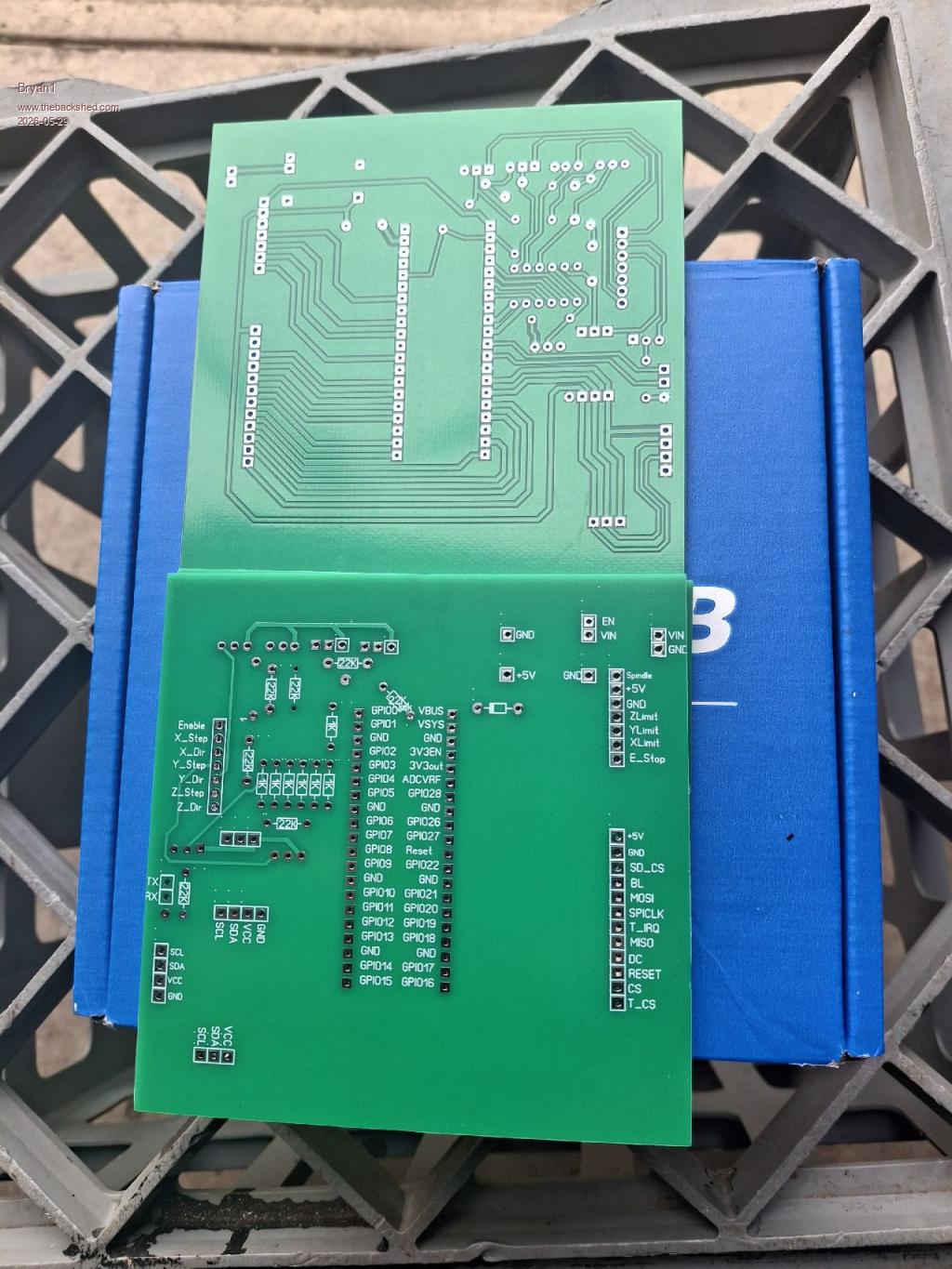

Now the LCD pcb's should be here next week as they are in Melb and should be over in Adelaide by Monday
Well first observations
1. Didn't put in mounting holes
2. The 5V regulator board has to go on the underside
3. With the RTC footprint the I2C breakout has to go on the underside
Now after looking for the scotty diode I just have the Bat46 here which is a 150mA one so would that be enough for powering the pico 2

Now silly me just used Lyles LCD suggestions and I left out the second SPI pins as 2 of each are used. Easy fix got some old 2 pin connectors so gerry rigged up the SPI lines also with the 5 volt pullups on the DM556's I brought all 3 out and did the same with a 3 post connector for them.
So after lunch time for testing this all out.

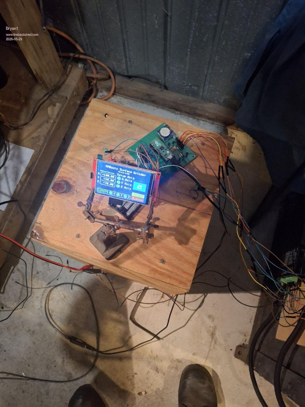

Well I did manage to have another play and put a dial on the Z axis, now I put a grinding wheel on and found with the spring pressure with the wheel 5mm above the magnetic table the stepper can't handle it.
Now go up 2mm and the stepper has no problem   so did the 1mm movement up and down where under the spring pressure the drift is down to 0.03mm or a thou in the old school so I do think we can live with that.
Not sure why these vertical white lines are happening as when I did the last test got close to 15 minutes before they came back and I did find putting the backlight on 5 did make it better.
But when those lines do start no backlight adjustment works so a 10 minute reset is needed.
