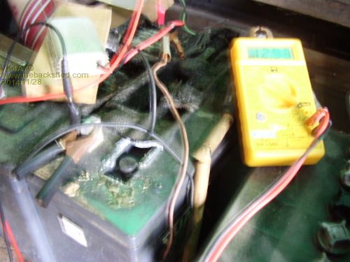

Hi All
A few postings ago I showed you a picture of my batteries that got burnt in the fire in my shed, i had written them off as useless due to their physical condition and the damage to the plate structure and a melted off terminal, after pulling them out from under a heap of junk this week I measured the voltage and got a bit over one volt one each battery, I decided to give them a go at rejuvenation just for the heck of it not really expecting much to come from it.
After cleaning the ashes, melted plastic and lead bits of the top of the plate packs I found they where more or less intact a bit singed and the top membrane burnt away, a couple of liters of distilled water got them whetted down again.
I connected my trickle charger and the desulphator up in 12 volt mode and you can see the results on the photo above after 24 hours, with the charger switched off they hold just on 12 volts so there may be hope for them yet. They look terrible and my wife said "you will never get those batteries working again" a couple of weeks on the desulphator and I might have an UGLY battery but it maybe useful for something. Fingers crossed.
All the best

Hi All
I checked on how the batteries are going this morning, and all is looking promising, the little trickle charger is switching of and on now indicating that the batteries are accepting a reasonable rate of charge, the on cycle is 14 volts and the off cycle is 12.2 volts so that is now enough to keep the desulphator working across the both cycles, so that's a positive. When the batteries get nearer to a full charge it will settle down to a steady 4 amp charge, with a battery of this size that could take a week.
I had a scratch around the plate envelope and found an opening to the plate for an inspection, which looks in good condition considering what it has been through. The plate is 5 MM thick lead so that will give an idea on the quality of the battery, normal automotive plates I have measures are between 1 mm and 1.5 mm on so called deep cycle batteries.
All the best

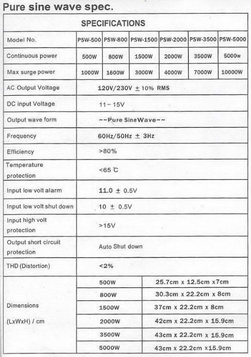

Posted: 03:01am 01 Dec 2014
Hi Madog
Look at this specification this one showing that have pure wavesine and other on ebay state Modify sinewave make me wonder or my mistake if both are same brand
Dwyer

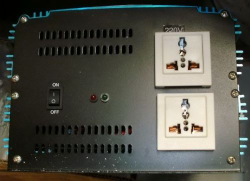

Just dragged it out & had a look, it is a Power Jack PSW-3500, mine says 6'000peak on the sticker.
Supposed to be a Grid Tie Inverter.
Cost me $250 a few yrs ago.
Probably won't work.

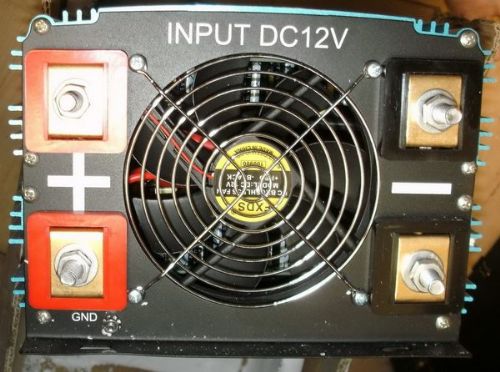

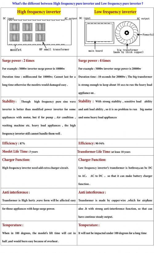

This is what I found;
Looks like there is a big differenc between the Hi & Lo Frequency models.
Mine is 44cm x 23cm x 15cm, has a big Fan, see below;

Hi Madog
The voltage conversion on of unit is done by a large torriodal Tran former which to me is a far more effective way to go, possibly 95% efficient, and gets ri of the horrible HF switching section, also has a sbstancial battery charger built in.
The best quality inverter youcanafford is the best investment.
