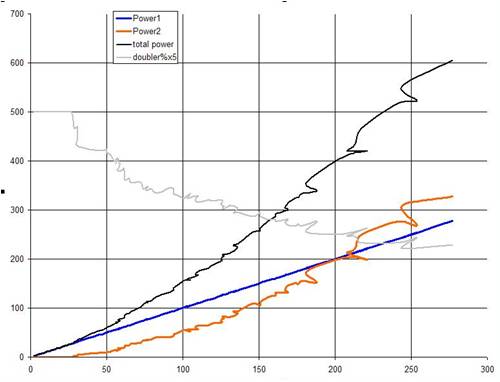

I have prepared a graph of the relative contributions to the output power from Caps in a voltage doubler arrangement.
I have plotted the total power, series caps, cap voltage doubler and relative cap doubler contribution.
The scales are 1.3 times the actual power.
At low power levels, the significant power comes from the cap doubler. As the power levels increases to 200, the relative contributions are the same. As the power levels increase further, the doubler plays less a role.
This is a seamless process without any switches.
The graph is showing that I can increase the series caps still some more, as the loading is still not quite enough at higher power levels.
Gordon.
