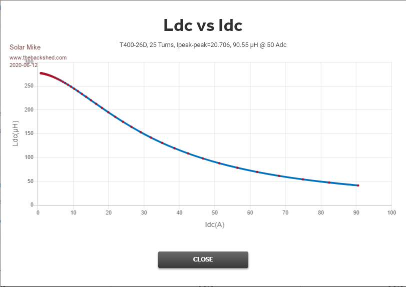

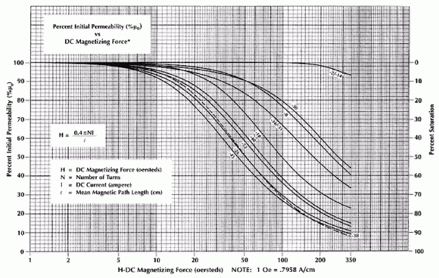

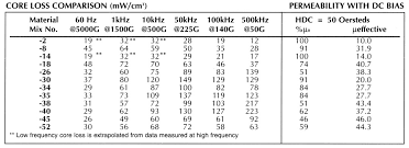

Posted: 11:25pm 11 Jun 2020
This is why T400-26D will not work.
Sorry about the image quality, it is all I could find.
Horizontal axis is magnetising force (ampere turns).
As you wind up the current to perhaps 200 orsteads, the inductance falls off significantly, in fact -26 material, the lowest curve is the WORST possible material for a very high power design.
Now look at -2 material, the highest curve. At 200 orsteads it still has about 98% of its original inductance that it had at zero current. Dash two material is also the least lossy at high frequencies.
With the T520-2 monster toroid I suggested earlier, a workable design is entirely possible, its the only powdered iron material that stands any chance at all of working in this application, and even then it needs 100 or more turns.
Edited 2020-06-12 09:42 by Warpspeed

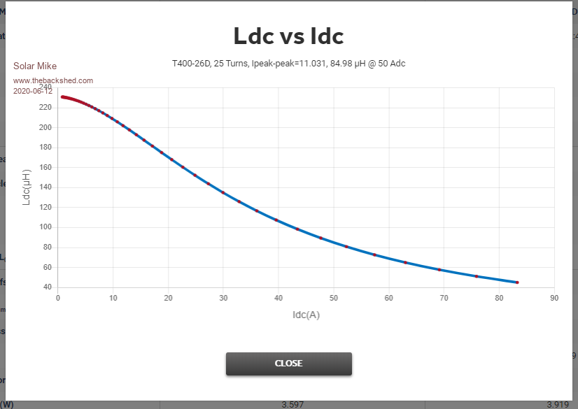

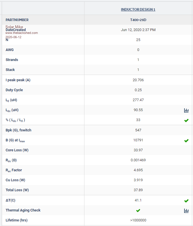

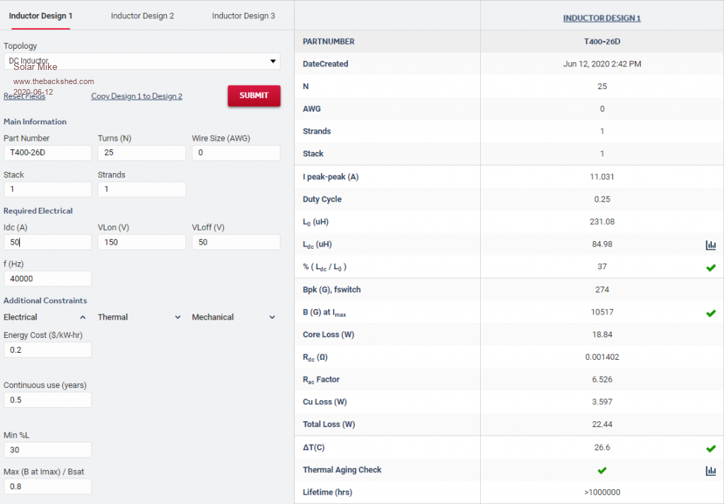

Here is a clearer data sheet on that T400-26D core
T400-26D-DataSheet.pdf
T200 Core
Mike
Posted: 12:22am 12 Jun 2020
Can you come up with a workable design for one or more of those cores ?
150v in
50v out
20Khz  16.7uS/33.3uS  (1,667 volt/microseconds)
50 amps dc
Edited 2020-06-12 10:31 by Warpspeed

From "red column" core loss it recommends about 90mW/Cm cubed max design core loss.
From the loss curves at upper right, 90mW/Cm crosses the 25Khz line at about 350 Gauss.
There is no 20Khz line, but its going to be pretty close.
Now we can work out our minimum turns requirement to reach 350 Gauss at 67 volts and 20Khz.
N min = 67 x 25uS divided by .035T x 685 mm squared core cross section = 69.9 turns.
So we must use at least 70 turns to satisfy the ac loss requirement.
For 50 amps we need 12.5mm squared wire (4mm diameter).
Our toroid hole is 56mm, and theoretically 149 turns would fit with zero allowance for insulation.
Seventy turns plus insulation should hopefully fit.
Initial inductance at zero dc current will be 70 turns x 70 turns x Al value of 262nH/turn. Comes out to 1.283 mH.
Now the dc part.
Magnetising current (H) = 0.4 x 3.142 (pi) x 70 turns x 50 amps divided by 25cm core effective length = 176 Orsteads.
Plotting 176 Orsteads on the magnetization curve we see about 15% of initial permeability.  So we have 1.283mH at zero current, and 1.283 x 0.15 = 192uH at 50 amps.
That is rather a nice result.  Its going to run pretty warm.

I went on to the Micrometals site and used their Inductance designer.
For that T400-26D core, plugged in values 20Khz, 150v in 50v out 50 amps, here are the results:
Their software does all the analysis, with 25 turns we see the max,min uH in the graph at 50 amps, the other details show core losses etc.
Running same at 40Khz is better:
Not the best core I agree, but available, they have much better ones will little losses all about 1 to 1.5Kg and approx $15, however shipping in small numbers would be the killer here.

Posted: 04:12am 12 Jun 2020
They are really pushing the core loss with only 25 turns, 33.97 watts core loss, Wow !
And that is not just flat out, that ac core loss is there even with minimal load.
The data sheet recommends 90mW per Cm cubed, and the volume is 171 Cm cubed or 15.39 watts core loss with that sized core.
With 25 turns instead of 70 turns, that changes things rather a lot.
They start out at 277.47uH and finishes at 90.55uH at 50 amps.
My design starts out at 1.23mH and ends up at 193uH at 50 amps, and runs cooler too, but at anything over 50 amps, its going to be in real trouble with sudden death saturation.
They really pushed the ac side of things to the limit. I went more for max dc and inductance.
But it shows how a different design approach with different trade offs can produce totally different results.
And yes, 25 turns at 40 Khz makes much more sense.
Mosfet switching losses are going to be double at 40 Khz though.
At 20Khz, I would still prefer less heat in both the mosfets and the core with more turns and a much lower minimum current where it finally goes discontinuous.
Anyhow, some ideas for Peter to kick around.
