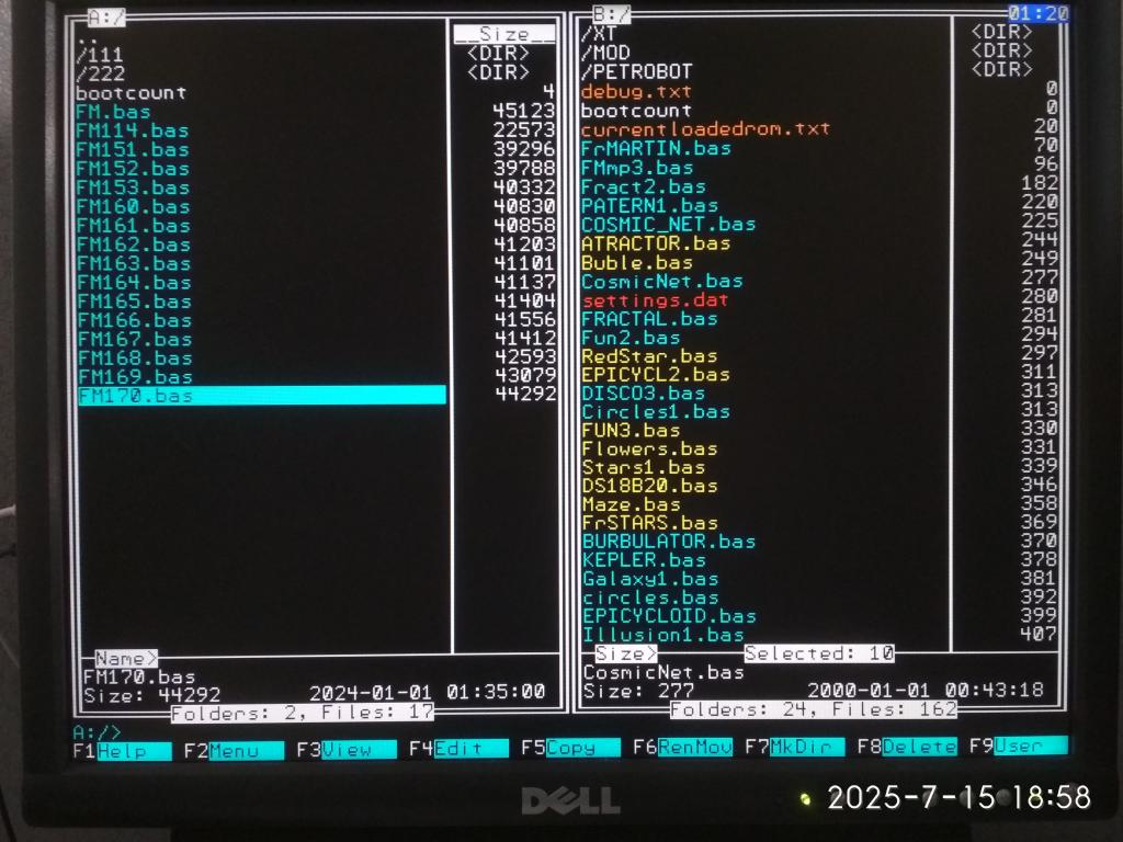

  javavi said  FM v.1.69 For testing!
+ A bunch of minor edits
+ Added display of file sizes on panels
Copying a directory with F5 and move/rename with F6 are buggy. F5 dir copy does not return to the FM but the copy is done. F6 shows a blank page in serial console and nothing happens on local screen.
Left panel does not show a column for file size.
Tested with resolutions 848 and 1280
I cannot see a usecase for the command line, as it does not return to the FM.
What do you use it for?
Edited 2025-07-16 02:29 by dddns

  dddns said  Copying a directory with F5 and move/rename with F6 are buggy. F5 dir copy does not return to the FM but the copy is done. F6 shows a blank page in serial console and nothing happens on local screen.
Just checked on 640x480 everything works.
These are hardware failures of the hardware or MMBASIC system due to overclocking, test on lower resolutions...
I noticed that on high resolutions failures happen often!
  dddns said  Right panel does not show a column for file size.
Wait a second, Coming soon...
But you can also enable it in the program.
  dddns said  I cannot see a usecase for the command line, as it does not return to the FM. What do you use it for?
For example, while in FM, you can type an option or a command and it will be executed upon exiting FM... That's how I save.))

The long-awaited release of File Manager v1.70 from Javavi
FM170.zip
+ Support for all resolutions
+ Switchable panel view (simple wide, with sizes)
+ Added function to search for one file from the current directory.
etc...

Tested FM160, 164 and 169 with OPTION RESOLUTION 640 @252000. With none of these versions copying a directory works for me. A single file is copied without problems. F6 doesn't work for me either. In both cases it does not crash the pico!
I'm playing around with this pico since half a year. Overclocking works rock solid and I never saw it doing things like that..
I would not exclude that it is really my specific setup..who knows
All the best!
With F6, ESC seems to help to get back into FM.
I will check my sd card setup
Edited 2025-07-16 03:15 by dddns
javavi
Joined: 01/10/2023
Location: Ukraine
Posts: 621
Posted: 05:24pm 15 Jul 2025
  dddns said  Tested FM160, 164 and 169 with OPTION RESOLUTION 640 @252000. With none of these versions copying a directory works for me. A single file is copied without problems. F6 doesn't work for me either. In both cases it does not crash the pico
Testing on PicoMite HDMI and VGA v.6.00.02
I just copied the PETROBOTS folder from disk to disk and moved it.
There is a certain period of waiting for copying and it's done without any problems.
The time depends on the number of files in the folder.
A BASIC program should only do what it should do!
dddns
Joined: 20/09/2024
Posts: 924
Posted: 06:01pm 15 Jul 2025
Copy works! I overlooked, that the content is 3Mb and I was not patient enough. It took 1min to copy.
F6 works as well. I found this with an USB keyboard, my terminal software uses F6 as clear terminal hotkey :))
I'm sorry for this bad report!

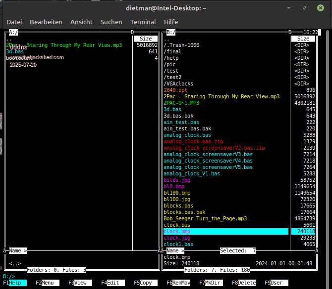

  dddns said  quick&dirty just commented out and defined colours by hand real quick, it runs on a RP2040 and a 7inch LCD ..very nice!
It works in full extent! It works perfect with FONT 1 and 4, all other fonts work as well only the frame is missing. Colours and inverted text work fine as in HDMI. My resolution is 800x480. Your new scaling is solid!
The processing speed is at least as fast as on HDMI and 2350. Very usable!
It looks very nice on a LCD! Pictures are shown in true colour :)

I'm sure, you remember the wonderful set of subroutines replacing print@ provided by @matherp here
I _only_ replaced all COLOR commands by calling this subroutine:
Sub setcolour f%, b% ' set the colour of both the screen and the console
Local integer fr=f%>>16,br=b%>>16,fg=(f%>>8) And &HFF,bg=(b%>>8) And &HFF,fb=f% And &HFF,bb=b% And &HFF
Option console serial
Print Chr$(27)+"[38;2;"+Str$(fr)+";"+Str$(fg)+";"+Str$(fb)+"m";
Print Chr$(27)+"[48;2;"+Str$(br)+";"+Str$(bg)+";"+Str$(bb)+"m";
Option console both
Colour f%,b%
End Sub
It was not more than find&replace and took 15min..:
So I can say, that it runs for me on every platform ..very very nice!
