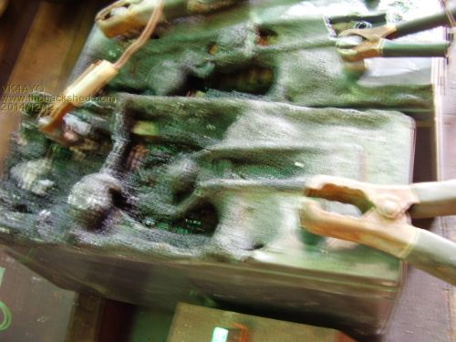

Your battery is undergoing sulphation by age, it slowly builds up on the plates caused largely by incomplete charge cycles due to the equalization charge not being high enough to convert all the sulphate back to acid and plate lead, a desulphator will help but will cost.
The low charge setting for equalization 13.8 to 14.2 is the reason for mosstpremature battery failure.

VK4AYQ
Joined: 02/12/2009
Posts: 2539
Posted: 12:42pm 09 Dec 2014
Hi bob
I have found one of those little 10 watt solar chargers will float the voltage up and keep the battery alive a bit longer, put it in the back window and connect direct to power as most use a cigarette lighter plug that is switched off by the accessories position on the ignition so is never connected to the battery when it needs to be.
All the best
Bob

Back to my burnt battery rescue.
After two weeks on the desulphator the batteries are now at 15.8 volts and balancing well the total destruction and a two year sit will have done some long term damage but it looks like I have a usable 12 volt battery for my troubles. It can sit for another week in the desulphator then i will have to devise a closure over the damage to keep the dirt and rubbish out.
All the best
Bob
