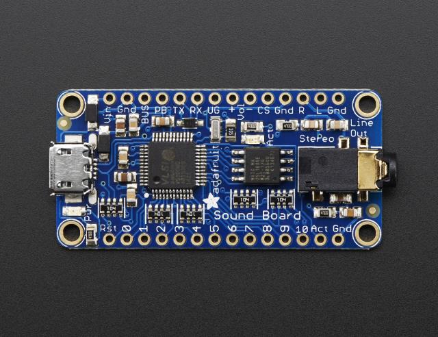

The reason I'm asking is I#m playing with an Explore 100 and its giving me about 9mV instead of 0V

Hi Lew.
You need to start thinking in terms of voltage ranges if you want to look at logic levels in terms of their analogue values. Your 9mV is a very good LOW. logic 0 isn't necessarily 0V and logic 1 isn't necessarily 3.3v, but they will be close enough and here's why:
As an example (and only as an example, you can do the leg work), the sheet I have permanently on my wall next to me is (table 29-8) for the PIC32MX1xx/2xx VIL and VIH. This shows the tolerances for input voltages and tells me Logic 0 on a general purpose input is anywhere from 0V (GND) to 0.2*VDD. A logic 1 is 0.65*VDD, or 0.8V+0.25*VDD for a 5V tolerant input.
So if you are running at pretty much spot-on 3.3VDD, you can expect any input measuring from 660mV down to 0v to be interpreted as a 0 and 2.14V (or 1.62V) and above to be interpreted as a logic 1. In between these levels is classed as "indeterminate" and all bets are off as to how the PIC will interpret the level. Therefore your 9mV is well in this range.
You need to consult the datasheets for the PIC you are using - you are expecting things to be precise and they aren't... ever.

I was "hoping" to use it to ground the pin on an audio board to get the audio board to play
CaptainBoing
Joined: 07/09/2016
Posts: 2171
Posted: 05:06pm 04 Dec 2017
... as an enable? or for power?
will probably work for either... 0.009V is a good 0V. so long as the current requirements don't exceed the pin it will be fine.
A mentor of mine (ex-RAF - long dead, bless him) used to say "It's as near as b*ll*cks is to swearing" Edited by CaptainBoing 2017-12-06
lew247
Joined: 23/12/2015
Posts: 1709
Posted: 05:34pm 04 Dec 2017
It was to use instead of switches on THIS
I could use control it through the serial port but I have no clue whatsoever how to convert Arduino code to Micromite code and the only example they give is Arduino
Edited by lew247 2017-12-06
CaptainBoing
Joined: 07/09/2016
Posts: 2171
Posted: 06:51pm 04 Dec 2017
Yeah, thought so... when they say "GND" they mean "nominally GND" = as near as... we call it logic 0, the actual voltage is usually not important - the datasheet for that device will tell you what it considers as logic 0 in the same way as the PIC data sheet does, but I wouldn't worry about it... all the manufacturers tend to agree and make their stuff "nominally" in the same ball-park so their devices can all talk to each other - makes $$$ sense
So it looks like you need a lo on any of the 0-10 inputs for 125mS to start it:
"When the # pin is connected to GND for more than about 125 milliseconds it will trigger"
Micromite will drive this just fine. Each of the # pins has a 100K pull-up. If the amplifier board is being powered by more than 3.3V you will need to connect them to a 5V tolerant pin on the MM or with a 1K or 1.5K series resistor to any other pin.
But other than that there is nothing to stop you driving this from a MM - Arduino code has nothing to do with it.
for each pin you need this set up:
PIN(x)=1
SETPIN x,DOUT,OC ' need this open collector makes the PIC pull lo but not drive hi
then to trigger each pin:
PULSE x,125 ' read the pulse command - page 67 of the MMBasic manual
or if you don't like that
PIN(x)=0
PAUSE 125
PIN(x)=1
same thing.

The one I have must be faulty, it wont work
Works fine on the computer to load and play files, but wont play grounding any of the pins, through the MM or manually
CaptainBoing
Joined: 07/09/2016
Posts: 2171
Posted: 07:05pm 04 Dec 2017
What are you feeding the output sound into? does that work with another sound source?
What are the filenames you used? It wants names following a specific format - start with "T" then have two digits following.
so "T00FRED.wav" is OK, but "FRED.wav" is not
the xx is the associated pin number.
Also if the files are .ogg, you need at least 200mS low on the pin (not 125ms)Edited by CaptainBoing 2017-12-06

T01.wav, T02.wav and so on
I even downloaded their example sound file to double check and use that to test
lew247
Joined: 23/12/2015
Posts: 1709
Posted: 09:38pm 04 Dec 2017
I've ordered a new module, seems like the one I have is faulty

You cannot run the module if the USB port is connected to a computer. The unit must be powered from a power module only or via the power pins to be in GPIO mode (run using the play inputs).
