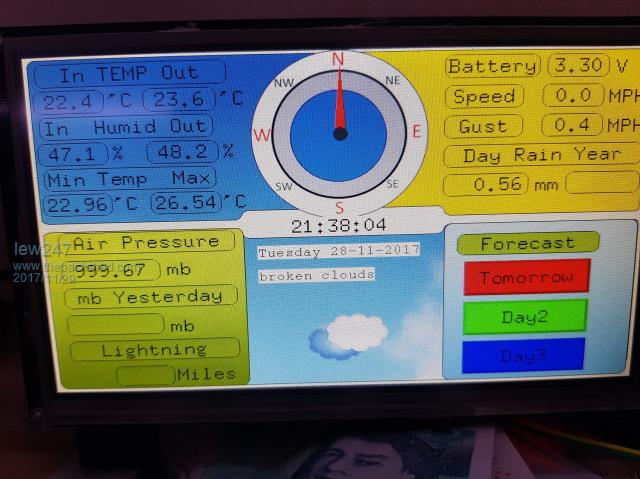

I think the problem is the SERIAL2 routine. you grab what has arrived but it isn't necessarily sane - it doesn't deal with any potential garbage in the buffer. I would like to get things to a more predictable stage. using INPUT$(254,#2) gets 254 bytes from the serial port - do you want this? do you want/Are you getting 254 bytes? I think this may even cause a delay until 254 bytes are available... I may be wrong (no access to manual) but if there isn't that number of bytes ready, MMBasic will wait until there are - how often does a line of data come in on port 2?
EDIT: OK, just read up on this - it will get *up to* 254 bytes, but you are not waiting for the string to arrive fully. The MM is quite quick and serial data can take a "while" to arrive, I think you are not getting a full string and leaving the remainder to arrive after you *think* you've got it... then the next time around, the tail-end of the previous line gets added to the front of the new one. I am fairly convinced this is the root of the problem You could do a quick and dirty pause of 50mS (50 chars) before the INPUT$ in SERIAL2 to try this out.
Think about re-writing the serial handler(s) to accept whatever data is there but build it up in another string and then set a flag which you can see in the main thread when you have received a carriage return. That way the string that you built up will only ever contain one whole line and you only have one character showing a newline which makes thing tidier.

  CaptainBoing said   I think the problem is the SERIAL2 routine. you grab what has arrived but it isn't necessarily sane - it doesn't deal with any potential garbage in the buffer.
EDIT: OK, just read up on this - it will get *up to* 254 bytes, but you are not waiting for the string to arrive fully. The MM is quite quick and serial data can take a "while" to arrive, I think you are not getting a full string and leaving the remainder to arrive after you *think* you've got it... then the next time around, the tail-end of the previous line gets added to the front of the new one. I am fairly convinced this is the root of the problem You could do a quick and dirty pause of 50mS (50 chars) before the INPUT$ in SERIAL2 to try this out.[/Quote]
My thoughts exactly. My example of 150mS delay between the MM deciding there is data in the buffer and extracting that data, might need some fine tuning.
With HC12 modules in FU4 mode @ 1200 baud, I wait for about 2000mS before reading the contents of the buffer.
As our Captain mentions, a better solution would be to read bytes from the buffer one at a time, and add them to D$. This works very well indeed, so long as you have an end-of-message marker byte. I just use CR, then when the loop runs into a CR, it knows it has a complete message string.

lew247
Joined: 23/12/2015
Posts: 1709
Posted: 09:46pm 28 Nov 2017
CaptainBoing
Changing the ICON$ to ICON$ = left$(FieldArray$(2),3)+".ppm" solved the problem, it now appends the .ppm to the icon name and then displays it properly on the tft display
The problem abut the D$ receiving the data twice still exists, I've triple checked and the data coming INTO The com port from the ESP8266 is definitely ONLY Today,broken clouds,04n
this is what print d$ shows
[code]Today,broken clouds,04n
Today,broken clouds,04n[/code]
I can live with it for now as the icon is now displaying properly, however it's really frustrating not knowing why it's doing it
Posts: 10043
Posted: 09:55pm 28 Nov 2017
If you get ONE copy of the wanted data in the buffer, we know there is no problem there then. The issue has to be somewhere in the code, and I suspect you are NOT clearing your D$ at some point, so you get two messages, cos one is sucked from the COM port buffer and added to D$, then that message is acted on, but there is another identical message still in D$ - so when you print it, you get two.
Whenever you suck data from the COM port buffer, CLEAR D$ with D$="" FIRST, then suck your data from the buffer.
That MIGHT be your problem, without reading through the code you uploaded earlier.

Add a DEBUG print in your T1 sub:
[Code]
SUB T1 'T1 Today
desc0$ = FieldArray$(1)
ICON$ = FieldArray$(2)+".ppm"
print icon$
'DisplayPicture ICON$,280,260 'Weather icon
Text 285,310, desc0$ , LM, 2, 1, RGB(BLACK), RGB(WHITE) 'Print the weather description
Print "This is what the com port is receiving - "
PRINT D$
PRINT "DEBUG: D$ FROM T1 SUB..." '<<<--- DEBUG LINE
END SUB
Add the line that says: PRINT "DEBUG: D$ FROM T1 SUB..."
If you then get a response that is along the lines of:
[Code]
> RUN
04d
Today.ppm
Today,broken clouds,04d
[/Code]
This then means that AFTER your T1 sub returns, another copy of the message is being added to D$ then printed again somewhere, or it is just printing D$ again outside of the T1 sub.
To confirm the latter, add the following line: D$="" to your T1 sub:

This is the output after trying that
[quote]> RUN
01n
Today.ppm
Today,clear sky,01n
Today,clear sky,01n
[/quote]
I've just told it not to print D$
it's not needed, I only had it there to try and find the original problem with adding .ppm to the end of the icon name
now its working fine
I#'ll try it tomorrow with the rest of the other 3 days data and not just "Today" but I "think" it will be fine

COM1 uses an ISR, builds a string and checks for a CR/LF sequence.
COM2 uses polling and checks for data using LOC() as if it were a dynamic file.
I think the way you are using LOC() on a serial port could pause problems,
hopefully someone with more MMBASIC experience can clarify.
You could add a second ISR for serial2 to build D$ or if it is working leave with LOC() leave it.
Like Grogster said, you need to clear D$.
You might be able to do that in your main DO .. LOOP like you do for SERIAL1,
you already have a IF THEN END IF for SERIAL2 to add D$="" to.
Screen display looks very nice.

I'm completely stumped again
I now have the data for "today" working properly (albeit ignoring the double data received)
However I'm trying to get the forecast working which involved more detail and this isn't working
This is the sub to find out which day is needed to be processed and this is workin

This is the code to get the data from the com port (putting D$="" at the end does not work it just clears all the data)
[code] IF LOC(#2) > 0 THEN SERIAL2 'If data in Com1 then GOSUB Serial2
END IF[/code]
This is the COM2 routine
[code]SUB SERIAL2 'Com2 ESP8266 Weather Forecast
LOCAL N as INTEGER
DO:LOOP UNTIL LOC(#2) 'Wait for some data to arrive in COM2 buffer
D$=INPUT$(LOC(#2),#2) 'Suck everything available from the buffer
N = GetFieldArray(D$)
IF FieldArray$(0) = "Today" THEN T1 'If the 1st array is "Today" then GOSUB T1
IF FieldArray$(0) = "Day2" THEN T2 'If the 1st array is "Day2" then GOSUB T2 'If the 1st array is "Day2" then GOSUB T2
IF FieldArray$(0) = "Day3" THEN T3 'If the 1st array is "Day3" then GOSUB T3

What is actually printed when I touch the Tomorrow button is a random selection of characters in the com port
Tomorrow touched
Day2,Thu Nov 30 11:00:00 2017
,light snow,13d,-1.07,2.05,1011.81,86,6,338
Tomorrow touched
2,4,357
Tomorrow touched
2,4,357
Tomorrow touched
Day4,Sat Dec 02 11:00:00 2017
,light rain,10d,1.63,7.09,1026.75,98,2,292Day4,Sat Dec 02 11:00:00 2017
Tomorrow touched
Tomorrow touched
TIME,Wed Nov 29 10:00:59 2017
Tomorrow touched
THIS is what the ESP is actually transmitting to the Micromite
