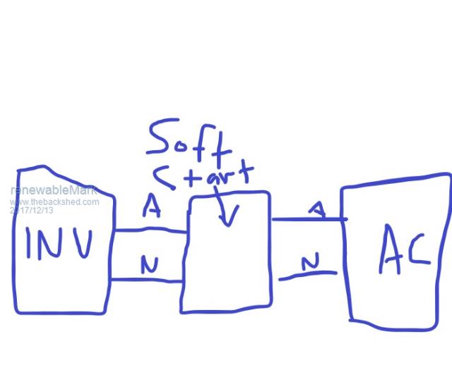

Funny thing is my AC gets run by that Giandel 2800w pure sine inverter and has done for months, sounds like I have been lucky not to let the magic smoke out.
Can you clarify "needs to be connected in after the power trigger"
Can I run the AC power into that board and the output to the AC feed line, or does it get fitted in the AC somewhere?

renewableMark
Joined: 09/12/2017
Posts: 1679
Posted: 06:53am 13 Dec 2017
Like this???
Cheers Caveman Mark
Off grid eastern Melb

Soft start has to have no power to it until you start the device so must go after whatever is switching on the motor, ie trigger on power tool or contactor in the AC. putting in before this will just have it passing power through with no effect. It must only see power at startup, not before.
