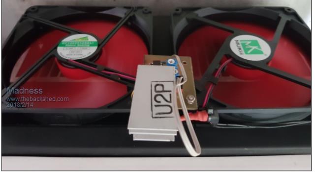

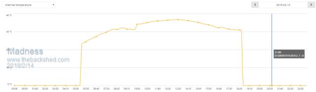

I just added 2 140 mm fans with Oztules control board to the top of my 5KW Zeversolar GTI. The GTI is in a shipping container that is airconditioned, previously it was showing temperatures in the mid 50's and according to the manual, it starts to reduce output at 45 degrees.
Since the fans are on there it now does not get above 35, I don't know if it has much of an effect on the power output but I am sure the lower running temperature won't do it any harm.

I just put together my auto fan switch yesterday.
Small 40oC temp switch, relay and a tiny transformer. The switch will do 5A but as I want to put it on the side of the inverter I didn't want 240 running through it.
I used the little 9V 300ma transformer ( $1 ea from fleabay) to run through the switch and go to the low voltage side of the SSR to switch the 240.
Mounted it to the side of the inverter with a bit of heat paste and duct taped it firmly in place.
Seems to be working well and exactly as I wanted. Don't think It will be doing much today though, too much cloud.

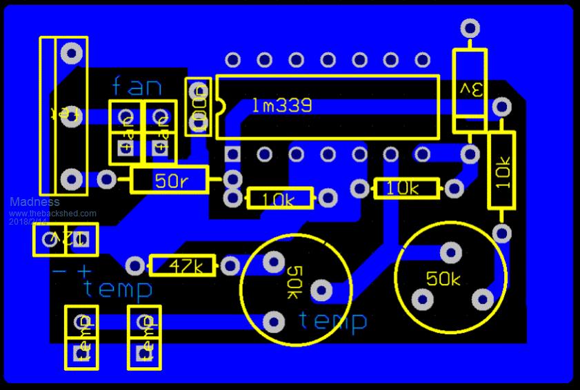

I have got all mine inside, I know GTI's are designed to go outside but I prefer inside. My fans are and control are powered by a 12V plug pack. The control board above comes on gradually so the fans only run as fast as required.
This the control PCB.
Further details here.

I prefer having the inverters indoors as well.
Makes it easier to keep them out of the sun which is a big factor in cooling in itself.
Lack of water around connections is another big plus to me.
The variable speed of the fans in your design may be an asset in some instances.
I thought about this using different temp switches and activating relays with different resistances to the fan.
To me seemed overkill. I have a speed control on the 240V fan I'm using atm and have found a setting where it supplies adequate cooling at low speed and minimal power consumption. Turning it up make no diff to the inverter temp as the ambient air is usually pretty warm here being summer anyway.
Spose there are trade offs to every approach lot easier for me just to wire some components together than make up a board and put all the components on it.
If I go to 12V fans, the power they use is so minimal I won't be worried about saving a few watts slowing them down. As mentioned, they can be pretty hopeless with resistance and backing them off makes that far worse.
Not really worried about noise either. They are in the shed and the car radiator fans in the window make a hell of a lot more racket.
I'm going to get some smaller radiator fans next week and see of I can set up the ducting with the tub. Other thing I thought of was using some large PVC pipe Cutoffs and mounting the fan in that then using a heat gun to shape the other end rectangular to fit over the inverter. Used to make a of of ducts like that back when I played with fast cars for cold air intakes. Worked well with large pipe and as cheap as chips too.
If I can do that I'll hook them to my broken panels that still seem to work great and have a totally self sufficient system with no control at all. Just direct wire the fans to the panels in series. Leave one in the window and the other blowing on the inverter.
Brighter the sun shines, more power the inverter makes, More power the broken panels produce, the faster the fan spins.
I'll probably get some much lower temp switches and use the rest of the setup I have now for turning on lamps to keep frost off my veggies in winter. :0)
