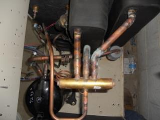

@chronic -- I suppose I could jury rig almost anything, but that's not what I'm trying to do.
I installed this abortion back in 2012 in order to curtail the $10,000 per year cost of fuel oil. It did that admirably well but something, probably too much flux residue left in the system by a really sloppy soldering job by the original assembler, caused it to fail.
Now, 5 years later, I'm interested in even higher efficiency. I'm thinking about larger heat exchangers, variable speed or multiple smaller compressors, and less electric consumption pumping water through needlessly inefficient heat exchangers.
Specifically I'm trying to find out what the efficiency will be for a condenser or evaporator coil immersed in a tank of water which depends on convection to move heat into or out of the coil.
This thing has still been using about 28 MWhr of power a year at a cost of nearly $3400! I should be able to do better than that.

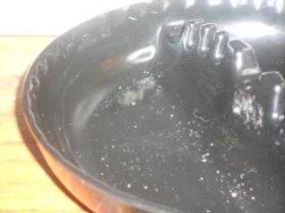

I doubt flux residue was the problem, more like if the superheat setting was wrong, air conditioning compressors rely on the cool gas coming back from the evaporator for cooling.
To use that amount of electricity this thing must run almost continuously.
You could move to a better climate.
Paul.
Edit... I just calculated that your electricity cost is about 12 cents for 1 Kwh,
here in Oz it is about 25 cents, and we call this the lucky country.Edited by palcal 2018-01-15

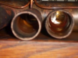

@Paul -- The idiots who assembled this heat pump were slobs. Back in 2013 I had to replace the freon reversing valve which had jammed. Look at this wonderful soldering job they did with the overheated copper turned purple and the excessive flux.
Look inside of the old reversing valve, that white stuff looks like crystallized flux to me.
I shook this white crystalline stuff out of the old reversing valve into an ashtray.
Do you still doubt that flux residue was the problem?

Well, I'm finally making progress here.
I bought a slightly smaller Freon compressor, 54,000 btu instead of 70,000 btu, together with a new reversing valve and they will be brazed into the system sometime during the coming week. I will take care to make sure that there is a continuous flow of nitrogen gas through the system while I am brazing to make sure that no internal oxidation of the copper pipes occurs at the brazing temperature. I will be using a "silfos" filler material containing 15% silver + 80% copper + 5% phosphorus at a temperature above 1300°F (700°C) when brazing.
http://www.silfos.com/assets/product_support/technical_data_documents/silfos-brazing-rings/Sil-Fos-15.pdf
I acquired a Little Giant 2-MD-SC magnetically coupled pump and used it to circulate an ester based cleaning solution, Comstar's CF20, slowly through the two stainless steel brazed plate heat exchangers, and the thermal expansion valve, for about 30 hours last week. I was also able to disassemble the thermal expansion valve and clean it mechanically.
http://littlegiant.com/media/130762/995752.pdf
http://www.comstarproducts.com/cf-20
The heat exchangers have 80 plates where each plate is about 4 x 24 inches and provides 20 tiny passages for water circulation and 20 tiny passages for Freon circulation. In other words there are 1600 individual paths for the water or the Freon to take in passing through the heat exchangers. That provides A LOT of opportunities for carbonaceous crap from the motor burnout to hide! When I finished the 30 hour slow flush the CF20 was staying pretty clean so I think I've got all of the crap out of the system.
The reversing valve is not really cleanable so it is being replaced. It is a pilot operated valve. A small 24 vac solenoid vents a tiny amount of the high pressure Freon from the compressor into one of two tiny capillary tubes which then shoves a large (1 inch diameter) sliding valve body one way or the other. Those capillary tubes are so small that any carbonaceous junk from the burned out compressor which gets pushed into one of them will not be removable.
When all this brazing gets finished I should have a working heat pump again. Then I will have to re-start my two year old project designing a control program for the heat pump system using MMBasic. It's just as well that this project has been on standby for the past year. I see that the Explore 100 board is up to revision 1D which provides an optional 1455 USB connection to the MMBasic console, built in ICSP, an on-board SD card slot, RTC and MEMORY modules, and it will interface with a piggy backed LCD module. All these whistles and bells will make programming this monster quite a bit easier.
