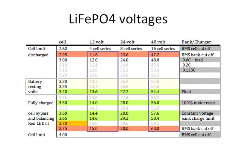

Posted: 02:06pm 24 Jan 2018
Hi Finn,
I made a chart a few years ago to help people get their head around the numbers.
nowdays I set the voltages a little bit lower
boost at 3.49 or 3.4875
float at 3.35
HVD 3.75
boost reconnect 3.25
LVD 2.95
the green section between 3.6-3.65 is for a top balancing BMS.
not sure why you cant lower the HVD maybe you have to lower another setting as well.
regarding the voltages at the bottom, well it is all about how much load you are drawing and how confident you are the cells are even at the bottom. at low loads the cells can get very empty while staying at higher voltages. a typical solar system load is not that high compared to an EV pack.
if you are going to run them really hard then you can balance the cells at the bottom and set the LVD to 2.5 there is no danger of one cell being driven in reverse if they are all flat at the same time, they dont have the energy to do any damage. thing is you shouldnt chop and change either balance at the top and stay away from the bottom or balance at the bottom and stay away from the top (if you know one cell is smaller in capacity than the others). I know active balancing all the time is trendy but if there is one cell with different capacity than the others it will be out of sync with the others every cycle and get corrected at the top and bottom every cycle.
I wouldn't get to hung up with balancing once you have them set up and even. I done a test with 8 400ah calb cells.
after 589 days cycling without a balance I had to transfer 0.6 watts out of two cells into the rest of the pack.
cheers
