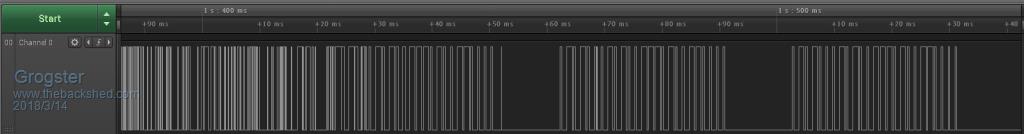

Ah, those logic analyzer plots look familiar. Indeed, I have a bunch of bits scattered on the desk in front of me related to just that.
Years ago, we used Visonic transmitters and receivers in a product we sell. These used a 12 bit protocol: 8 bits for the address, 4 bits for the data. The length of the pulse determined whether a bit was 0 or 1. Then they stopped making the transmitters.
We found a somewhat suitable replacement transmitter from China that our existing stock of receivers could understand and production continued. These new transmitters send 24 bits of data so the firmware had to be rewritten to understand both types of transmitter. All was well until our supply of receivers was consumed.
I tried the cheap receivers that came with the transmitters but was stymied by the noise output when there was no transmission. The firmware worked without changes, but was slow to respond to signals because it was trying to decode the noise and needed more good signal to purge the old rubbish.
I reverse engineered the original receiver enough to identify a squelch circuit with op amps to zero the output when the incoming radio strength was low. Hmmm.
In the end, I went with a better quality receiver from Linx Technologies, part number RXM-315-LR. (They make a 433MHz version too, RXM-433-LR.) These cost a lot more but we need the quality. The nice part is the they output both the 'noisy' signal of the cheapies _and_ an RSSI, the radio signal strength. Turns out I could just feed to RSSI signal through a comparator then to the firmware and it worked fine.
As far as decoding the received signal goes, my code runs on a PIC24 microcontroller (originally on a PIC16F627) and needs to receive the same code three times in a row before accepting the signal. The firmware measures pulse lengths to generate a sequence of zeros and ones and stores them in an array. A long zero indicates the end of a packet, at which point the number of received bits is counted. 12 and 24 bits results are decoded and acted upon.
TL;DR
During testing, I fed the wonky pulse train, as seen in Grogster's logic analyzer plot, straight into a UART receiver set for different baud rates. At some (random) baud rates, very consistent characters were output, an amazing case of garbage in good data out! However, this will only work if you can get a squelch circuit going. Otherwise, the UART will spit an unending steam of nonsense.

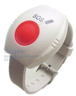

Remotes are SOS watches for emergency use.
Single button.
Predetermined as per the 1527 chip. You CANNOT choose the code as sent, other then the last four bits of the 24-bit word.(not counting sync bit) Most of these either have all four data bits set at zero or one. The 20-bit transmitter address code bits are hard-coded from factory, and you cannot change them. Each physical chip has a different address code, so every chip sends a totally different code word.
Roaming - fixed to arm of wearer.
All in proximity of each other.
Multiple units transmitting at same time - could happen, but generally not an issue.

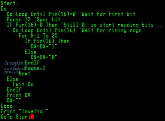

This was my first attempt:
That was a total failure. Just with the white-noise it was outputting all kinds of code, none of which were valid ones. I was trying to detect the long-low and go from there, same as you suggest, but I was doing something wrong cos it did not work. I tried playing with the pause, but it made no difference.
Admittedly, this was just my first attempt.....
EDIT: Here is a screen-shot of the white-noise vs the data:
The white-noise is on the left, the sync and data words start from about the 50ms mark. This image shows TWO copies of the wanted data on the right, and white-noise on the left when the transmitter is off.
EDIT: Forums have squished this image. If you want a clear GIF image, let me know and I will externally link to it.Edited by Grogster 2018-03-15
