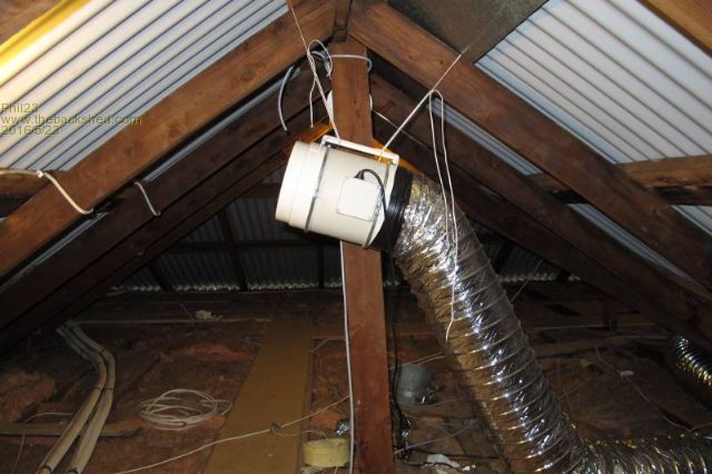

  yahoo2 said   I have found a guy that has done it.
Quite a bit different to what I've done, that is detailed in the thread from 2 years back.
The fan draws 105 Watts on high & displaces 840 cubic metres of air per hour.
The main living area, plus adjoining Office/Spare bedroom have a total volume for 215m³, so air turnover is about 4 times per hour.
There's a few more pics in the original thread & it's evolved a bit more now with a better control board; 8 relay etc & now runs 2 fans & 3 damper valves.
Phil.

You'd certainly pull some heat out of that roof space with the tin being uninsulated!
I know how much heat my uninsulated Shed roof radiates when I'm standing on the floor and it's fully ventilated and covered in panels as well!
Do you have any filtering of the air you pull from the roof?
I'd like to have a filtered air supply Running into the house to try to pressurise it a bit to push the air out of windows and doors so the dusty air was not as easy to get in. Cleaned the return air Filters yesterday and was horrified at how dirty they had got in the 3 months since I did them last.

  George65 said  Do you have any filtering of the air you pull from the roof?
The filter is a 1200mm length of decorative perforated flue tube wrapped in Dacron type material, so static electricity comes into play.
You can't quite see it in any of the pics as it is still on the Work-in-progress shelf, 20m away in the shed.
