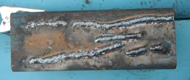

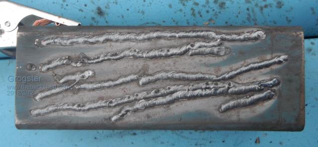

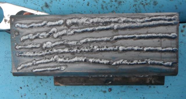

OK, I think I am actually making progress.
I still suck compared to a professional, but I think I am a little less sucky then before.
23 electrodes later(I only ruined one, so I burnt 22), here are today's line tests:
First attempt:
Second attempt:
Third attempt:
Forth attempt:
This was about an hour or so of playing about. I THINK I have mastered the art of striking the arc. By the end of today, I was only ever sticking on the odd occasion. When I first started, the electrodes were sticking all the time.
I start the arc using a feather-light brushing motion. Trying to plop the electrode onto the work-piece and quickly flick my wrist back - which is how Dad used to strike arcs all his life - just did not seem to be working for me. Brushing the electrode on the work seems to work for me every time.
The auto-darkening helmet is a thing of beauty. Dad just used to use the old ones that were permanently dark. How the hell welders knew where they were actually starting the arc is beyond me. I remember seeing Dad do it all the time - get electrode in roughly the right place, nod his head, helmet came down, strike arc and go. I guess as with all things, practise, practise, practise.
Something that became VERY obvious to me today, was that you have to teach yourself to get a feel for how slow or fast you feed the electrode into the weld. Too slow, and the arc grows to a massive size very quickly. To fast and you end up pushing the electrode into the weld and snuffing the arc - and the electrode then promptly sticks and stops.
All the seasoned welders on this forum will know all this already, I am just sharing my learning experience.
I learned today that there is an optimum distance and arc size such that you can see the weld pool below the arc, and as others have said - this is what you need to watch, and not the arc itself. Although, you do need to keep the arc the right size too, so I guess you have to watch both.
Start-stop welding seemed to work well for me. If the electrode and work are cold, this is when the sticking seemed to happen - for me. When the work has heated up, I could stop and start on the same line quite easily without sticking.
When I next get a chance, I will do more. I need to get some various bits of scrap steel to practise on, cos I want to do two bits together after a few more goes at lines.
Posted: 05:42am 12 Aug 2018
Its like learning to walk, learning to swim, learning to ride a bike.
Its not just something you can be absolutely perfect at the very first attempt.
But pretty soon your brain, your eye, and your hand, will all become coordinated after a bit of practice.
A bit of theoretical knowledge comes next if you are really serious.
A TAFE welding course might be worth thinking about, and its good to do that fairly early on before you start developing bad habits.

EDIT: Oh, I forgot to mention that once I got OK at striking an arc, and with the work hot, I tried playing with the current. The packet said 70-100 amps, so I tried again at 70 amps. Even with hot work, this was still too cold, and the electrode just started sticking again. 90 amps was a good value. I then also tried at 100 amps, and it also seemed to work well. Is there any rule of thumb for the current or do you just use what they say on the box, then tweak it within that to best suit yourself?Edited by Grogster 2018-08-13
Bryan1
Joined: 22/02/2006
Posts: 2300
Posted: 07:35am 12 Aug 2018
Good to see your getting there Grogs, now there is a process called pad welding which would also be a good way to learn. Basically do a run say left to right with the angle of the rod about 60 degrees. Now when the first run is done just switch over and do the 60 degrees the other way and weld 1/2 of the previous weld. Keep welding until you reach the starting point and switch again.
Now to start a rod I just hit the rod on the material and raise it quickly to get the arc going, now if you aint happy with the start of the weld just swing the whirlpool back over it and start welding.
Like others have said it's just like riding a bike and practice practice practice did I say practice
Now to do a vertical up weld it's basically 1,2,3 where one is to the right, 2 is in the middle plunging in and 3 is on the left. Rinse and repeat until done.
Cheap welding rods do tend to leave sl*g inclusions which should be ground out and rewelded. With TC16's they just don't happen and who ever says they are hard to use just don't know how to weld. There is a good reason why TC16's are industry standard as they do make a stronger weld and a 1" weld will lift a tonne. Now try doing that with a garden variety rod.
