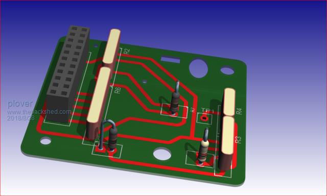

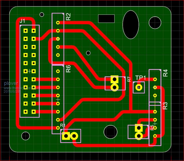

Posted: 12:05pm 28 Aug 2018
Andrew_G
I am trying to become familiar with AutoTrax DEX, experimenting with a number of different things. When I saw your layout that offered an opportunity to try and do a little bit of reverse layout, using guesswork and scaling etc
I have almost finished by exercise when it occurred to me that I that it might be a simple exercise to add gerber files.
I do not need boards manufactured but here is an offer. if you help specifiying what should actually go on the board, exact size, holes etc, then I will try and make it a finished board and you can have a set of gerber files and do with them whatever you like.
When I am finished I will place the project here in the topic and hopefully we can get somebody that understand that manufacturing end of the system to help out. I am not much chop at that yet.
As I needed components I have just taken what was nearest to fit the pattern. So if it is not a trade secret you will need to come up with some more details about the board.
Even if you just want a pretty picture of your design, just fill in some more details of what you would like. I will post a 3D picture of the result.
The holes in the board was my latest struggle to figure out, should have been dead easy but turned out not just like the manual said, I even had to read that.

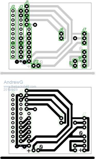

Posted: 05:26am 29 Aug 2018
Hi Plover, good suggestion and I'm happy to help your testing (but I will probably use DIY PCBs for this current project, rather than gerbers to China) - but hey, I might learn something too...
(this is the second time I've typed this as I hit the "Reset Form" instead of "Preview Post" button).
The layout is still a moving feast but here is the latest from Diptrace:
What I'm doing is interfacing Big Mick's "Serial Backpack" boards (here) onto a 1.8" 128x160 LCD display (I have 3 versions of this display - each pinout differs from Micks - I'll settle on one type, with the smallest footprint) and make say six boards.
Here are the main features:
J5, J6, the single pad between J6 and J7, J11 and J12 are all female headers to accept pins from BigMick's serial backpack, their spacing is important to match Mick's board.
J2 and J8 are 11 holes through which the long pins of a female header (11 pins) on the Cu side of the board pass. The long pins are soldered to the pads on J3 and J9.
The 11 pins on the LCD display are inserted into the female header J2/8.
J1 and J4 (5-pins) are the connections to a female header for a HC-12 (lying flat on the top side, spring antenna to the right).
J10 is a 90 degree male 4-pin indexed male console connection (Gnd, Rx, Tx, 5V)
J7 is a 90 degree male 3-pin indexed connection to a DS18B20 (there is a built-in 4K7 resistor in Mick's board) (5V, data, Gnd).
The pad to the right of J4 is in case I subsequently want a connection to pin 5 (Set) of the HC-12 (unlikely).
The three pads below J9 are in case I want a resistor to reduce the voltage to the display (unlikely) - drill out the centre one to break the circuit, solder a resistor to the other two pads.
The locations of J2/8 and J3/9 are important to fit the whole assembly, including the LCD, into the jiffy box and J1/4 need to be as far left as possible to accommodate the spring antenna in the box.
If the holes in J3 and J9 were through plated then J2 & 8 could be omitted and the board shortened.
The MM code is 90% done as I have a number of test modules (Veroboard) around the house (I'm happy to share it all but am not normally an exhibitionist . . .)
Does this make sense?

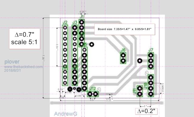

Posted: 02:03am 31 Aug 2018
Andrew_G
Been looking at the dimensions of the board, working backwards from scaled version for the fun. Your picture is actually on the schematic page in my system and I have placed 'guide lines' then from knowing a few unit points like the headers a 8 way header 0.7" and where I have a circle another check point.
Happens that the sale must be close to 5:1, however what size is your boards actually.
One more question, J2 and J3 are 8 way headers with a 3 way header added? What are the names?
I probably should be able to figure it from the description, but will cheat and ask?
