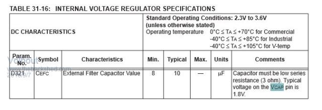

Posts: 6118
Posted: 01:07pm 07 Sep 2018
I am not sure if anyone mentioned this already, but can you check if C10 is correct?
The symptoms you mention could also be caused by stability of the core voltage regulator (internal 1.8V).
You could simply parallel another 10uF ceramic capacitor to it (not electrolytical).
The capacitor at the Vcap pin should be minimum 8uF and 3 ohm max ESR.
It is possible that due to spread in component tolerances this is critical on your board.
Ceramic capacitors typically are +/- 20%, so 8uF is within possible values of a 10uF capacitor.
If you don't have one, take the one from the second board.Edited by Volhout 2018-09-08
KeepIS
Joined: 13/10/2014
Posts: 2265
Posted: 10:35pm 07 Sep 2018
Thanks, that was the first thing I thought of, it means that both new boards would have had to be supplied with a faulty or incorrect part, I find that unlikely, unfortunately due to a serious accident I'm in no position mentally or physically to keep at this. I will just have to accept what I was supplied with and test them at 100 MHz in the CNC device I designed, hopefully it will be ok. Thanks again for suggestions.
