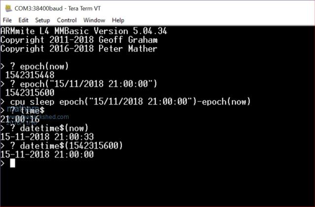

Posted: 03:12pm 15 Nov 2018
Hi!
Is there a way to wake up the controller at a certain date/time (RTC)?
(After playing around with the board for a while, the RTC suddenly went wrong by a few minutes - but unfortunately can't reproduce the error...)
I also had a problem with the editor: I wanted to append a few "0" to a number whereupon the editor suddenly moved or deleted any other places in the code - leaving and calling the editor did not change anything. The code was displayed corrupted. Only a restart of the µC brought remedy - but the code was still intact...
Frank
Posts: 11881
Posted: 04:33pm 15 Nov 2018
  Quote  Is there a way to wake up the controller at a certain date/time (RTC)?
No, but perhaps I'll include it
  Quote  I also had a problem with the editor:
What terminal are you using?
Can't remember if I've posted a version with the new console code. Try this version
2018-11-16_032337_ArmmiteL4.zip Edited by matherp 2018-11-17

Posted: 10:59am 16 Nov 2018
Hi Peter,
thank you so much for your "cpu sleep epoch"!
It works very fine! Have you measured the power consumption during that time?
(I am using Tera Term as terminal program.)
Do you think there is a way to write a Basic driver for an Adafruit LS013B4DN04 display?
...then I'd be a lot closer to my Micromite wristwatch!
Updating with the ".bin" didn't work for me - I had to flash the controller again...
