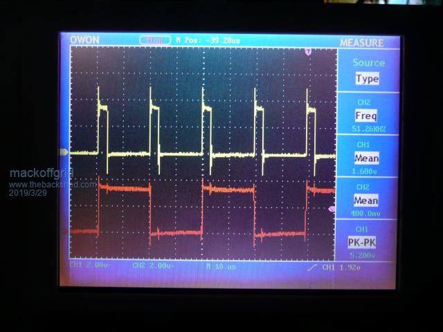

PC14 (red) toggles in the timer interrupt and PA4 (Yellow) is set High on the start of the timer interrupt and cleared at the end of the proc_nextOutputValue() which finds the next voltage level and load the value for the outputDriver.
As you can see it does it comfortably.

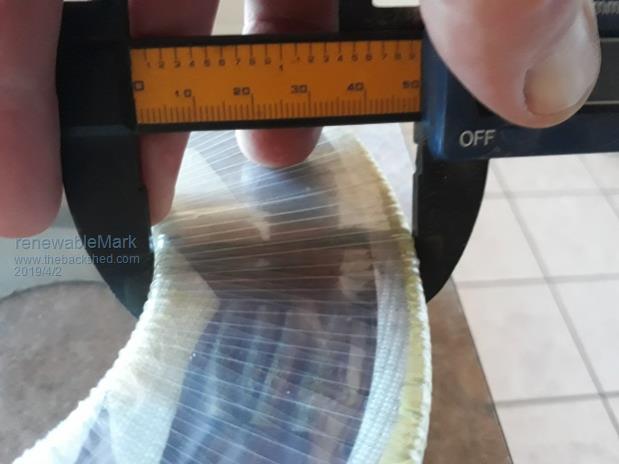

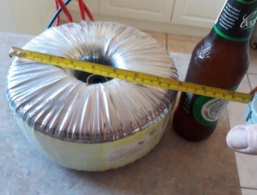

renewableMark
Joined: 09/12/2017
Posts: 1679
Posted: 05:49am 02 Apr 2019

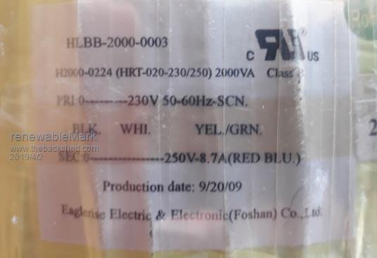

OK got some wire on the way for the primary of No1 toroid.
No 2 toroid will be a 2kw aerosharp.
Those windings are going to be useless, so a strip and rewind is in order.
I have fixed No 1 toroid to have 128 turns, waiting on cable for the 25 primaries.
What numbers would be best for the No2 2kw Tony?
Poida, let me know which toroids you want for your machine, there is enough for you to do a double stacked 2kw (4kw) for No1 and then use 1500w for the other three.
Or make a smaller machine and have just a 2kw for no1, which will be a lot less winding.
Double stacked you'll need to completely strip and rewind, but it's not that bad.
It only sends you a little bit crazy, if you are already cracked in the head it's no big deal.

Posted: 06:14am 02 Apr 2019
O/k Mark for the number two 2Kva transformer.
First I need some information.
I need to know the magnetic cross section of the core, and you won't be able to measure that until the core is stripped completely naked.
Also need to know the diameter of the hole.
And what copper wire diameters you have available on hand there to rewind it with.
And lastly, I think your big toroid had a combined secondary wire size of around 7.5mm squared (for thirty amps). We need this secondary to have about a similar combined wire size to end up with a similar current rating.
If you can come up with all of that, I will have a go at a possible design and explain step by step.

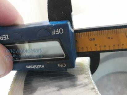

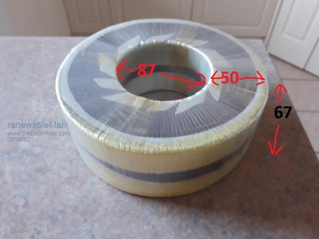

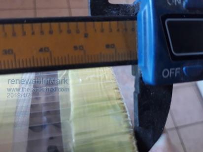

Joined: 09/12/2017
Posts: 1679
Posted: 07:25am 02 Apr 2019
That was fun, do you need it stripped completely to metal, or is this ok?
Height 67mm
ID 87mm
ID to OD 50mm
Cheers Caveman Mark
Off grid eastern Melb
renewableMark
Joined: 09/12/2017
Posts: 1679
Posted: 08:10am 02 Apr 2019
Forgot to say the wire I am using is the 1.6mm 2mm2.
That is what I used on the bigger 6kw toroid too.
Edited by renewableMark 2019-04-03

Posted: 08:19am 02 Apr 2019
O/K we are off to the races.........
The first step is to work out the minimum possible number of secondary turns that will give us a flux density of 1 Tesla with a core cross section of 67mm x 50mm to support 75.0 volts at 50Hz.
This is not strictly correct for higher frequency square waves, but all the errors will be on the generous safe side. And I want to keep all this as simple as possible.
So we go to our trusty transformer flux calculator and we plug in some trial and error numbers.
75 volts
.00005 Mhz (four zeroes) 50Hz
100 turns
33.5 cm squared (67mm x 50mm)
Hit "calculate"
And we get an answer of 10,084.71 Gauss (10,000 Gauss = 1.0 Teslas in metric measurement)
https://daycounter.com/Calculators/Max-Flux-Density-Calculator.phtml
So we require a minimum secondary turns of 100.
Our transformer ratio will be our (Mark's) minimum dc input voltage of 44.0v up to 75.0v on the secondary.
If we have 100 secondary turns and we multiply that by 44/75 we would require 58.6666 primary turns.
So we go up to 59 primary turns and try that 59 x 75/44 = 100.56 turns
60 primary turns x 75/44 = 102.27 turns
61 primary turns x 75/44 = 103.97 turns.
lets make it 61 turns primary and 104 turns secondary.
The circumference of our hole will be 87mm x 3.142 = 273mm circumference.
If you want to do it with 1.6mm wire, that has a cross sectional area of 3.142 x 0.8 x 0.8 = 2mm squared, good for only about 8 amps. You would need four layers of that for 30 amps.
Now we could with luck fit roughly about 170 turns of 1.6mm wire onto the first layer.
A second layer would be six turns less in theory, or 164 turns
Third layer six turns less than that 158 turns.
Fourth layer six less still 152 turns.
So there is going to be heaps of room to fit on 104 turns and four layers of 1.6 wire.
Its best if you can spread the turns around evenly on each layer if possible to use the whole width of the available core.
Actually three layers of thicker wire might be better if you had the wire to do it, but four layers of 1.6 will definitely do the job.
Secondary will be four layers of 2.0mm squared wire 104 turns.
Primary will be 61 turns of 8 x 104/61 x 8 = 13.6mm squared wire (or whatever comes close).

I had some thoughts on approximating the core size of an existing wound transformer like mark has.
- Measure the wire size, of each winding.
- Add a temporary winding (say 10 or 20 turns) and determine the turns of all windings.
- Weigh the transformer.
- From here use a spreadsheet for Calcs.
- Estimate the copper lengths and weight deriving from above details. This will give us the steel content.
- Using the dimensions like Mark has taken, we know the weight of silicon steel, we can play with the spreadsheet until we have a descent approximation for the core size.
I realize this is a bit like bush mechanics but ...
This is kind-of what I've done
Andrew
Posted: 08:44am 02 Apr 2019
Commercial transformers operate at a much higher flux density than is desirable for an inverter, so we really need a slightly larger sized core for any given power.
But we gain some, because manual winding allows far more of the hole to be used up than would be the case with a commercial toroid winding machine.
If we start out with a commercial toroid rated at 2Kw (or whatever) we can pretty much get all of that, but do it at a far lower flux density and idling current.
No need for bush mechanics when it can all be worked out properly.
