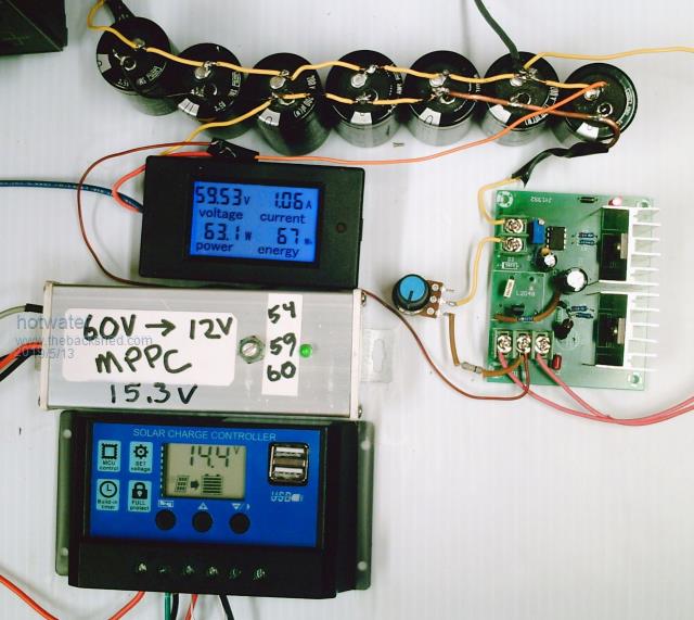

Here is a low cost linear current booster setup that charges batteries and also heats water on a 60V array. The water heater green board allows the use of the water heaters mechanical thermostat to switch the high current DC without any issue with contact arcing.
Thank you!
The half bridge inverter board is a brilliant idea to get the AC like zero crossings!
In your picture I see:
1. Input from PV comes in and there are two parallel paths - the modified MPPC 12V buck converter and the series PWM charger
2. 7x 1200uF, 100V DC Caps for a total of 8400uF are connected via a diode to stop inrush backfeed that can damage the PWM charger
3. This cap bank sources power from the array when the series PWM charger is open and feeds the modified MPPC 12V buck converter, which powers the 12v half bridge inverter board on the right
So there are 2 ways you can wire this up:
i. feeding 12v DC to your HWS
The 2kW 120V elements that are cheap and common should present a current draw of 2000/120 = 17A.
To draw 17A@120V, the nominal resistance needs to be 7E.
At 12V, a 7E element can let through 12/7 ~= 2A. This would generate 4 * 7 = 28W.
Unless my calculations are absolutely off, there's no meaningful effect on heating water with 28W even if I had sun for 10 hours. so this is not what you're doing. which brings me to....
ii. Other way being the 12V buck converter is there JUST to power the 12v half bridge inverter board and that switches the 60V PV array voltage directly to the 2kW 120V elements
When the buck converter sees that the panel voltage is dropping below set threshold, it turns itself off, turning off the inverter board in turn.
This option has a lot more potential feeding the 60V panel voltage directly to the 2kW 120V elements
At 60V, a 7E element can let through 60/7 ~= 9A. This would generate 81 * 7 = 567W.
With that power, a lot of hot water can be generated on a good day!
However, I cannot see how that 567W can be sustained - as soon as the cap bank is discharged, the elements will be essentially directly connected to the PV array.
This would shutdown the buck converter and the elements would have no power. This allows the caps to charge until they reach buck's threshold and the whole process repeats.
A lot of oscillations and stress on that cap bank I think?
Maybe that's how all linear current boosters operate and I have to take that into my stride buying caps as they die but I wonder what the effective power delivered would be?

NO diode (I don't see one)unless you want to put one in. It is generally not needed unless the heater is in parallel with a PWM controller directly connected to the panels. In that case it harvests only when the PWM is in the off cycle.
I have 30 gallons of water at the camp. This is enough for showers and dishwasher. This also runs the heated dry on the dishwasher. This year I am also adding another 30 gallon tank for clothes washer this year. I do have excess power that I am not able to use because of 60V panels I have. 6 gallon tank was to show how even a vary small camp system can have hot water for free. A wasted effort since no one can understand the theory of operation. The water heater circuit could run a DC pump just as easily as a linear current booster.
The green board is completely self powered from the 60V array and it only takes 15ma. The board has under voltage lockout so a very clean startup. The mechanical thermostat is between the panels and the capacitor bank and has about a 400 ohm resistor bridging the contacts. This keeps the capacitors always at the power point voltage. The heater control acts like a shunt regulator. Therefore, the differential voltage is never more than 30V not violating any laws of nature. This is the when the contacts open.
In theory, both FET in parallel operate half the time and share any heat dissipation usually less than 2W. At low light level it favors one FET due to startup. It is constantly checking any time the voltage on the capacitor bank drops and that is around a quarter volt with a 60V panel. It can be made any voltage depending on FET.
This was just a stock photo for how someone can get into solar cheaply. (90% of benefits of a full MPPT for $10. Small camps generally don't need any more than 10A. Big panels allow the system to work even in cloudy weather.

  hotwater said   NO diode (I don't see one)unless you want to put one in. It is generally not needed unless the heater is in parallel with a PWM controller directly connected to the panels. In that case it harvests only when the PWM is in the off cycle.
Yes, for the harvesting to work, the cap bank has to be in parallel to the PWM controller right?
Also, since the cap bank stores a significant amount of energy, we need to ensure it does not backfeed into the PWM controller or the PV array, right?
So, how is all of this being achieved without a blocking diode or a power rerouting switch?
I won't say it's a wasted effort - you're assuming a lot on the part of the reader.
If the reader was competent enough to understand the whole design from pictures and an explanation, they won't need the pictures and an explanation to begin with: they could have come up with it on their own.
In that case, the pictures just verify what they came up with.
For someone who lacks the deep understanding necessary to come up with your design from scratch, a blueprint of the complete system is critical.
A schematic of the complete system really helps understand what's going on.
If you have a schematic of the picture you showed, that would REALLY help.
My brother who's been in construction for over 20 years can guess down to the studs how a house is setup just by standing outside the house. A blueprint verifies what he had in his mind.
For someone building a house without construction experience, the opposite method is necessary - the blueprint helps them take the path and leap forward.
what is the buck converter doing there then?
If the green board is independently powered, a TL431 based comparator could tell it when to stop feeding the elements when the PV voltage starts to drop below threshold, right?
Is this checking being done by the green board or the buck converter?
At what voltage?
10A from 12V nominal panels produce much less power than a 10A, 30V nominal grid panel vs. a 10A, 3x 30V nominal grid panel
Thank you for the details and I hope to plug in the gaps for someone trying to reproduce the useful system you've designed.Edited by LadyN 2019-05-16

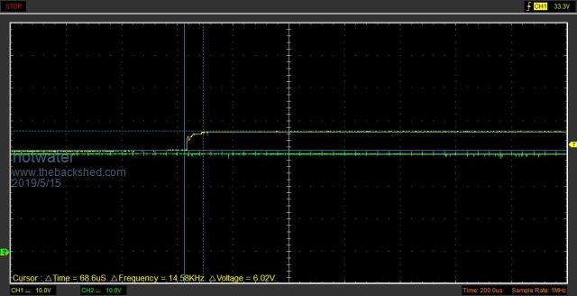

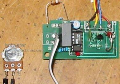

I've posted so much that I am unaware of what is posted where. It seems like the schematic should be on this board somewhere. Given the worldwide audience on several venues it is disappointing that only one person has been able to build a system. That was a farmer with absolutely no technical training. I've sent several working semi assembled systems to people and none they have ever put them into a system. Yea, by any measurement it has been a wasted effort.
The buck converter is only for the PWM controller and it acts like a LCB with a voltage limit. There are a lot of 48V systems out there with just a PWM controller that water heating could be used with as long as there is an isolating diode to prevent the capacitor bank from dumping into the battery. One of my heaters operates off a "36V" string that provides about 50V. With battery voltage elements it could even be used with a 12V system.
My camp with a fridge hardly ever goes above 12A charging. Typically it is far less than 5A most of the day 500W of panels is a good match for a camp like that. Bigger panels are bought so the system can still work in cloudy days when only 100W can be produced. So, a $4 charge controller is all that is needed with a $5 modified buck converter and super cheap grid tie panels. Few analyze what is actually needed for a working system.
The green "300W inverter" $6 board is a convenient breadboard for making a nice looking system. It used to come with 75N75 FET which were good for a 60V system. This FET is likely still available from vendors offering a 24V version. Now the boards come with a 50V FET requiring replacement. Still not a bad deal for everything else you get. The picture below is one I built from an obsolete out of production bare board. A little perf board would be an easy build. Getting the heat sinks, terminals etc would probably run as much as the $6 board.
A TL431 is used in each to shut the devices off when panel voltage drops. The heater needs about 25ma to keep alive and the capacitors at the set voltage. At that point is is a shunt regulator using the resistor across the thermostat. Edited by hotwater 2019-05-16

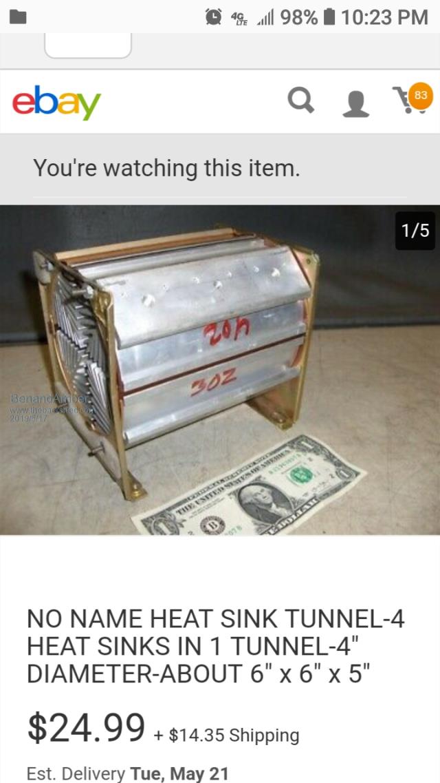

A
Warpspeed check out this heat sink it reminded me of you
What would be wrong with using real high amperage mosfets like the 360 amp ones
I know they won't do the 360 amps in real life but could you not get by with fewer of these so would have less paralleling
And could a person submerged the whole inverter board in Transformer oil to keep it coolEdited by BenandAmber 2019-05-18
