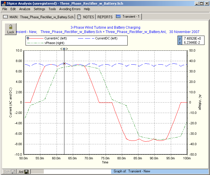

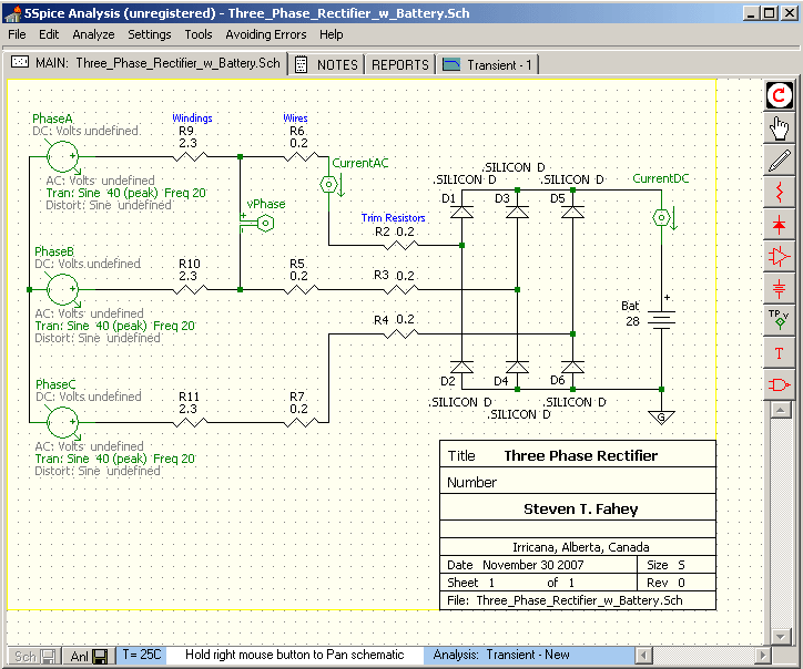

Could I suggest you try modelling this in WinSpice?
I used Spice to model the basic windmill system a while ago, and it really improved my understanding, rudimentary as it is.
Have you tried calculating the reactance of the capacitors at different frequencies (=rpm's)? Wouldn't that help illustrate how effective they are at different speeds?

I am not familiar with Winspice. I might suggest that you publish some output graphs and some assumptions you made when you did the model.
Gordon.

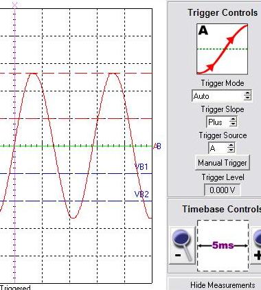

The std rotor has 56 magnets. There are 28 full flux cycles per revolution. For an individual phase, 60rpm or 1Hz rotor gives 28Hz AC output frequency. On a std 100S in delta with 230uF capacitors, cutin of 26V was measured at AC cycle wavelength of 14mS. Std 50Hz AC cycle has wavelength of 20mS therefore 14mS gives 71Hz, or 2.55 x 60 RPM = 153RPM.
How does this compare with this stator in delta without capacitors? What RPM would a 100S in delta need to produce 26V?
I hope to measure outputs at higher current levels when more winds come.

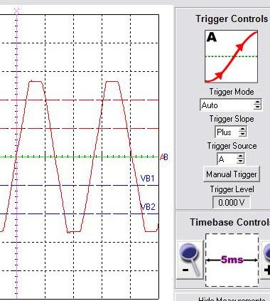

I have some oscilloscope graphs of the outputs.
This is at cutin 26V
This is at an output at 2A.
Note the flat top of the sine wave output and the straightening of the sides.
The mill increased 5 RPM at the 2A power level. The normal unloaded output of the system increased 1V per 5.9RPM. There was an effective 0.85V extra to produce 2A. The capacitor combination gives an effective delta wiring resistance of 0.42ohms. I have not measured the DC resistance of the delta combination of 100S windings, but another reader may have done this for comparison.
The current was a total of 2A for the 3phases. The RMS current that was output per phase occurred during a very short time interval. This shows the problem I have mentioned with sine waves and peak currents with a battery load. The wire has a much higher current than the average current. This is most probably why generators, including axial flux machines and iron cored machines that produce sine waves dissipate more heat than calculated when supplying a battery load.
It will be interested to see how the rpm continues to increase with higher power output? I suspect that the peak currents in the coils generate a substantial voltage drop that lowers the relative loading of the mill at higher power levels and allow the blades to sort of track windspeed. The sine wave output has a similar effect to adding resistance to the transmission line to increase power output, by allowing rpm to increase and hence reduce the chance of blade stalling. I think this was the sponginess I described earlier.
I may be wrong, but, in this case blade efficiency seems to be increased at the expense of alternator losses at higher power levels.

I suggested WinSpice because as I experimented with it, I found that it has plenty of modelling and graphing capabilities, plus it looks really nice...
Bear in mind, it only models the electrical parameters - it's up to you to figure out how the windmill system actually behaves under these conditions.

Hi sparweb,
The graphs I have presented, are actual measured outputs between phases.
On the simulations you present, I see no inductance values for the coils.
I used a spreadsheet to get graphs like the ones produced by winspice. RFsim99 gives more frequency related information.
