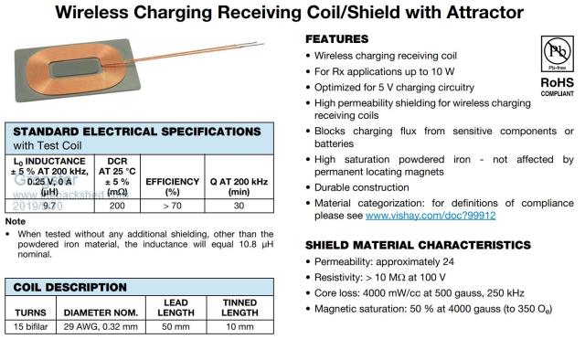

It is all explained in the data sheet for
VISHAY IWAS-4832FF-50
You young blokes never listen
Peter
Posts: 10042
Posted: 12:04am 30 May 2019
Seems my guess was correct - it is a shield to protect the inductive coupling used in the wireless charging concept, from affecting nearby electronics.
This one also has an 'Attractor' - a little bit of iron in the middle of the coil to help the coupling.
Therefore, I expect the little black pad things go on top of the coil, with the coil sitting on the charger base, to stop any radiated magnetic field perhaps annoying nearby electronics. That would seem to be the situation.
EDIT: "You young blokes never listen." - sometimes we need a prod from the older wiser members! Edited by Grogster 2019-05-31

The little shields DO make a big difference to the charging current.
Without it, charger current is 230mA or so, with the little shield placed on top of the charging coil - which is on the charger pad - the current jumps up to around 520mA or so. This is using a 5v @ 2A USB plug-pack/wall-wart thing.

I have to say, that the little "ferrite" sticker seems to make things worse. And beware the voltage collapse as you start to draw current from them. I think to be on the safe side, you need to limit your current expectations to about 500-600mA, above this they start to behave quite oddly with no clean o/c shutdown (and it gets hot). Even with a moderate load (200mA) there was about a volt of noise - 20%! It needs some good Smoothing & filtering.

I think your "little ferrite sticker" is probably meant as extra shielding between the receive coil and other electronics. Looking at the waveform does indicate a lot of noise.

@PeterB I agree with you - it is effective enough as a shield to stop the inductive coupling completely - i.e. when placed between the two coils, no (appreciable) energy transfer occurs, so yep I think you are spot on. Just didn't expect it to "steal" 20% of the transferred energy when simply close to it.
