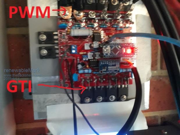

Arthur, you can feed the Ozinverter, or Warpinverter's AC or "mini grid" with AC from a GTI being fed by it's own panels.
Problem is it will keep pumping out as much as it can as that's how a GTI is meant to work.
Feeding one of our systems like that will boil the batteries and stuff them.
Solution is to use a Mad GTI control board.
The dc output from the panels goes through the GTI controller and only feeds the GTI with as much power as your settings will allow.
IE it throttles up and down the DC input to the GTI.
They are in THIS THREAD toward the end somewhere.
BTW it will also PWM (dc60v in my case for 48v system) to your batteries too (top fets) bottom fets are for GTI input/output.
As you can see I'm only using the PWM currently.
Of course, that power from the GTI is only available when they are making power in sunny conditions.
If you need 10kw or so at night you'll need to come up with another idea. Edited by renewableMark 2019-06-12

Hi Mark.
I will read this topic now.
That is a very good idea. But didn't know that ozconverter was able to 'accept' grid tie outputs on its input.
How it is possible that the batteries will be charged? I can understand how a H-bridge inverter works, but can't understand how grid tie can inject AC on the inverter, rectify them and convert again to DC to charge the batteries.
Anyway, very nice to know!
I've just bought some boards from Madness (that includes the GTI board), i will be using them for sure to limit my grid tie. My power consumption during the day will be 1~2kW with peaks of 8kW.
At night, just some 500W loads.
Thanks again for your help!
Madness
Joined: 08/10/2011
Posts: 2498
Posted: 09:36pm 11 Jun 2019
Connecting GTI's does indeed charge the battery via our off-grid inverters. It also has the advantages of utilizing the GTIs MPPT and high efficiency for running loads during daylight hours. Combined with the GTI Regulator PCB you can also charge your battery correctly. Also the Regulator PCB can be used to control things like hot water heater with power that would otherwise not be used. I also use to control an air conditioner for the room where my inverters and battery is.
There were some teething problems with earlier versions, but it now runs very reliably. Mine has been running perfectly for well over a year now.
