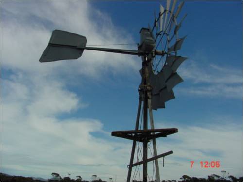

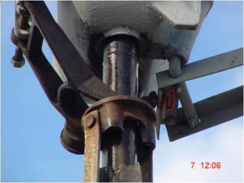

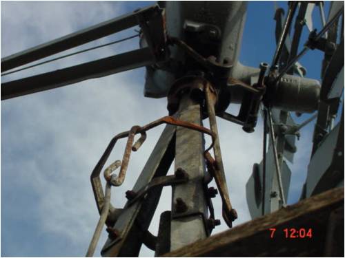

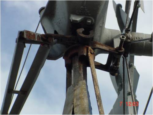

Now for the Furling ,
You said:
"Yes, the key on the back is there so I can install a disc brake on it, as Bruce has done with his F&P. I like the idea of 'belts and braces' safety. Furling plus a way of mechanically positively stopping the blade. This would also be handy during raising and lowering of the tower. I'm also keeping in mind Oztules' method (rather: Southern Cross method) of furling/stopping the windturbine, but at the moment I'm partial to a braking mechanism. "
And I said, ..... hell I had better go outside and take some pics of the furling as promised. The furling stuff is just loosely assembled to take some pics. But you should get the idea.
Here we have no imposed furl position. It is free to self furl, but we have no control in this guise.
Now I have pulled the handle down from on the ground (this thing is only 12 feet tall)
and it has pushed the forks up towards the body, This in turn pushes the tail around a bit. It can still furl by itself further,
but I have now hobbled it from full power. At best it will always be 30 degrees off the wind
Now we have pulled the handle all the way down, and it furls it up fully. This machine has no load on it at all. I am currently building a pump for it. So it is left in the fully furled position. Yesterday we had 60-70km winds, the mill was mostly still unless a gust from a different direction turned up. Then it re-oriented and was still again. No stress or strain on anything.
The handle is the steel horizontal bar about a foot below the triangle wood platform. To furl it just pull the handle and hook the hook onto one of the horizontals of the lattice.
I hope that is enough to get the feel for it. If you need further detail/pics of it, then just say so.
........oztules

Thanks for the detailed pictures of the Southern Cross furling/stopping mechanism, it's much appreciated. It's beginning to make sense to me how it works.
Clever mechanism, since it still furls normally as it's (partly) manually furled. Now I'm thinking about ways of adding something like that to the 'normal' (Hugh Piggot e.a.) furling system. Could probably be easily done with some steel cable and a pulley. Let's see... 1) normal furling 2) manual furling 3) manual brake. There's no better kill than overkill, especially when dealing with a turbine you want to stop ASAP.

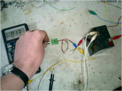

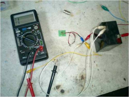

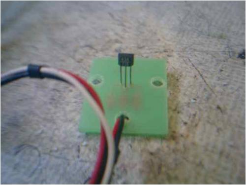

Was looking around in the parts bin with Hall sensors and found two identical ones on a piece of print with wiring. The wires were colour coded so a piece of cake to connect it.
Nearest power source was a 6V battery. Quickly wired it up. Digital multimeter (DMM) is set to diode test. With no magnetic field present it measures infinite resistance:
Grabbed the nearest magnets to test. With a magnetic field:
Ok, seems to work perfectly up to a distance of about 30 mm with these tiny magnets, and it only responds to one particular magnetic polarity, not just the presence of any magnetic pole.
BTW, about 1/2 a year ago I tried to test these same Hall sensors. I expected them to give a high/low output in the presence/absence of a magnetic field, i.e. a digital signal and didn't see anything. Didn't realize they had open-collector outputs...
Current plan: mount both Hall sensors in the stator (one spare sensor in case something 'happens' to the first sensor). That magic smoke is just waiting to get out and I know myself too well... I'll likely also add a pickup winding. Better have it and not need it than the other way around. And a temperature sensor, of course.
As far as stealing my plans goes: I'd consider it an honour if you stole them! Edited by Dinges 2008-07-16

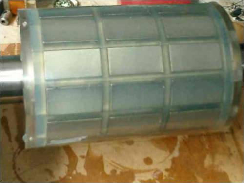

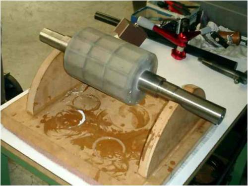

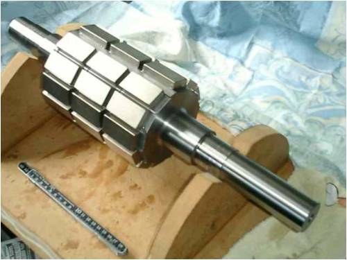

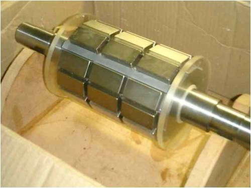

Work has been progressing on the rotor of the 10 hp conversion. All the magnets have been glued on. 36 pcs. of N42 50x25x12 mm. Glued on 6 pieces at a time, so 6 glueing sessions in total. All in all it went pretty well considering my initial fears. The ridges that were milled on the rotor were a very big help when glueing the magnets, as one only need to worry about locating the magnets in the longitudinal direction.
After the magnets were glued on they were degreased, sanded and degreased again (to remove any amine blush from the epoxy, and to provide better mechanical adhesion). A piece of glasscloth (80 gram/m^2) was cut to size and wrapped around the rotor. The start was fixed with a few dabs of cyano-acrylate glue. Epoxy was then applied to the glasscloth so the cloth would be attached to the magnets on the rotor. The glasscloth is some extra insurance against the magnets flying off. I don't really think it's needed but if I didn't, Ron said he'd no longer be my friend. The things one does to keep him happy...
I don't have a picture of the glasscloth laminated to the magnets. You'll have to take my word for it that it's really there.

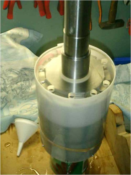

The epoxy was left to cure for two hours and then the mould was added to cast the entire rotor (yeah, right, the *entire* rotor... read on) in epoxy.
The mould is made from two endpieces of 8 mm plexiglass, turned to size. Over the endplates a piece of plastic was attached.
The mould was installed after the glasscloth lamination was partially cured, the rotor was stood up vertically. Then the casting began. Thanks to proper preparation this went pretty smooth.
Except that halfway during the casting I began to notice the supply of epoxy was diminishing rapidly. But, no worries! I had calculated beforehand how much epoxy I needed and I had twice as much as I needed. Or so I thought. Till the last drop of epoxy was used, and the rotor was only 2/3 cast. *sigh*. Why doesn't reality conform to my calculations ?!
I still don't know what went wrong. I verified my calculations again and I *should* have had plenty of epoxy to finish the job, but the picture tells another story.
It's not a big deal, it will just delay finishing the rotor some more (I had hoped to turn it to size this weekend). It means that after this epoxy is cured it'll have to be cleaned and sanded again (in all the tiny nooks and crannies) before the last bit can be cast. I'd have preferred to cast the rotor 'wet on wet', it'd give a better endresult and take less effort. The extra cleaning and sanding that will be needed now is work that shouldn't have been necessary. Either way it shouldn't have too much detrimental effect to the endproduct.
Bugger. It all could have gone so perfectly smooth. Things like this annoy me to the core as it's extra unnecessary work.

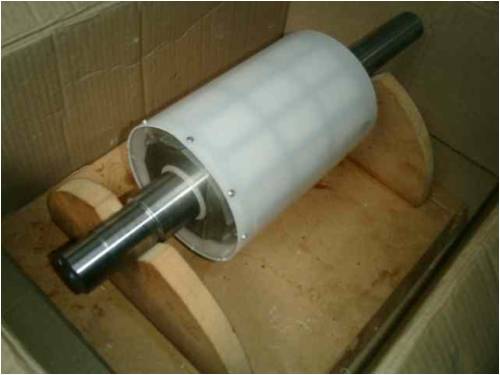

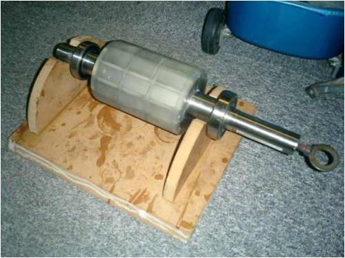

Guess it's about time for an update on the 10hp conversion as it has been a while. Didn't have much time to play with it due to other priorities, but finally got a chance to finish it. Casting the epoxy had already finished a few months ago. There are some air inclusions ('foam') present where the two castings touch (I wanted to cast in one piece but ran out of epoxy, so the last part had to be cast after the first part had set and was prepared/cleaned again), but the air pockets are much smaller and less of an issue than I had feared, so I didn't bother to re-touch them as I initially planned. Below is a picture of the rotor after casting but before machining to final size.
After a hiatus of a few months, last week the rotor was finally turned to size, see image below. The outer diameter is now 129.0 mm, just as the original (induction motor) rotor was. The inside diameter of the stator is 130.0 mm.
The next step is getting 2 new bearings (6308-2RS), installing them and then carefully inserting the rotor into the stator for a test run. A single-turn testwinding has already been installed in the stator, to determine RPM/V of the rotor-stator combination. I'll admit, not much got done over the past few months. But the above report should satisfy the curious. (you reading, Vawtman ?)

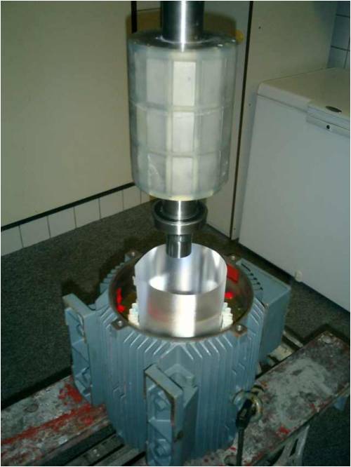

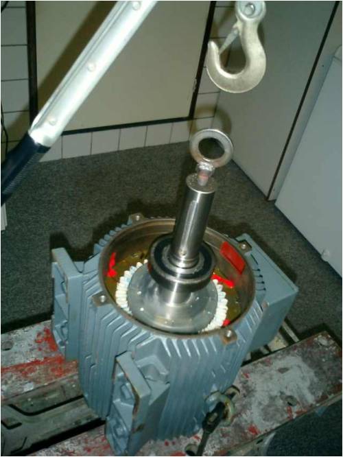

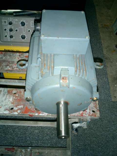

Some more work got done on the 10 hp motorconversion 'Blue monster'. After the rotor got turned to final dimensions a few weeks ago I installed fresh new bearings: 2 pieces of 6308-2RS1. 40 mm shaft diameter, 90 mm outside diameter. This took a bit of effort heating them with a hotplate and persuading them to move with a large hammer but I got them installed in the end.
Then, as I was about to insert the rotor in the stator, I had a good look at the endbells... and noticed the bearing houses were not the same size ! . Despite all the preparation and care I still managed to miss this. Argh!
So, out came the trusty puller. Removed one of the bearings and replaced it with the proper one, a 6208 (80mm OD). (I may pull both bearings and swap them later, so that the largest one that will take all of the axial load will be at the rear. This means swapping the endbells too but that's no problem.)
Next step was inserting the rotor. With a manual hoist this went relatively easy but there was definitely a lot of pull from the rotor: the stator was literally trying to suck it in. This is NOT a rotor that I'd want to 'throw' into the stator. Maybe I'm just a coward... but considering that there's for 300E worth of magnets, 100E of steel, 100E worth of bearings, and a lot of manhours invested in it... You'll probably get the point.
After installing the endbells was the moment suprême: testing it for cogging. For the past few days I was worried about this. I *knew* everything *should* be fine... but what if I missed something ? What if the theory isn't correct ? A calculation error? A machining error? Etc.
I think Zubbly was right when he told me I worried too much... because it didn't cog! Not even the slightest little bitty bit of cogging was detectable. Hurray!
No cogging, but of course there is quite a bit of iron loss; the rotor turns pretty hard, I'll be making measurements of this later to determine the exact amount of iron loss. It's not like an axial flux that, when you give it a swing, keeps rotating for the next minute. But I have little doubt a 4-5 m prop will have trouble starting it up.

Steven, thanks. Yes, it's always an exciting moment when you spin that shaft for the first time; will it need a pipe wrench to turn, or just two fingers...
As I was inserting the rotor I tried to take my weight off the workmate, but the rotor immediately tried to lift both stator and workmate (total weight ~55 kg) off the floor...
  Steven said  Then again, who DOESN'T need a variable frequency drive setup in their own garage?
My thought! Every house needs at least one!
Looking forward to published results of your model. Would be a nice way to predict generator voltage and power of conversions. I now use 100W/cubic inch as estimator of power output for conversions. None of mine have attained Zubbly's 150W/cubic inch so far. Maybe my airgaps are larger, or I'm testing/rating them at lower RPMs than Z.
Oztules, I just checked a bit more... of the 1.5Nm startup torque, 0.3Nm is caused by the bearing seals. But yes, should be easily overcome by any prop.
[QUOTe=oztules]just don't repeat the "blueboy" calculations..... hopefully the bearing mismatch is the last of the gremlins for you with this.
Darn. You have good memory. And I was only off by a factor 4 too... Seriously, that's why I'm glad I did that small conversion first, as it allows one to learn before investing major time and effort in 'the big one'.
You should have seen the look on my face when I noticed I had installed the wrong bearing. Mr. Murphy is always looking over your shoulder... Too much attention for detail (calculating bearing loads, C0, P0, lifetime calculations, seal friction, etc), too little attention for the basic things (like correct bearing size...). . I should have measured *both* endbells. And if the original bearings still had been in place when I got the motor I'd have easily spotted the difference in size too. So looks like Murphy was really lurking in the background. (I find that idea more comforting than blaming my own incompetence )
  Oztules said  Voltage?.......Turns?...... thickness??....
Preliminary results yield 125 RPM/V/turn (for 6 single-turn coils). More accurate measurements to follow when I've build a small measurement setup.
