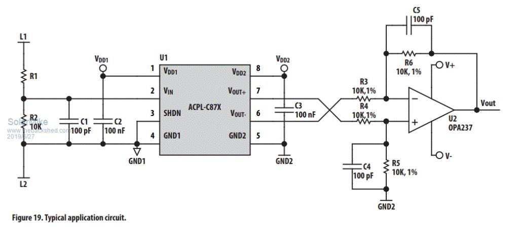

OK, the first issue I have is the High voltage isolated sensing of the main capacitor charge voltage, we need to measure changes in this value so the switching points for the mosfets are set. When the dump mosfet turns on the capacitor bank rapidly discharges and drops in voltage; we want about 0.1(RC time constant) duration for a 10 volt change, so the measuring of this has to be quite fast.
Seems to be a number of options to do this:
1: Use an optically isolated voltage sense chip like the ACPL-C87B, it has a linear voltage input of 2 volts and a 100 KHz bandwidth.

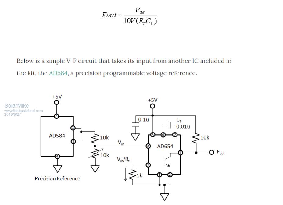

2: Convert the voltage changes to frequency variation, good chip to do this is the AD654 voltage controlled oscillator, it has a linear frequency increase with voltage input, the output square wave can be isolated by an opto-coupler; the only BUT here is a CPU on the other side has to measure the frequency and convert this to voltage trip points.
3: Convert the voltage changes to Pulse width , ie 1volt = 10us pulse, 100v = 1msec, 200v = 2ms etc, the pulse can be isolated by the opto coupler and decoded direct by a CPU.
#1 seems easiest to use, the output is a dc voltage that can supply the adjustable comparators, #2,3 would bypass the comparators and decisions made by a control CPU. Depends whether a CPU in the mix is desired....

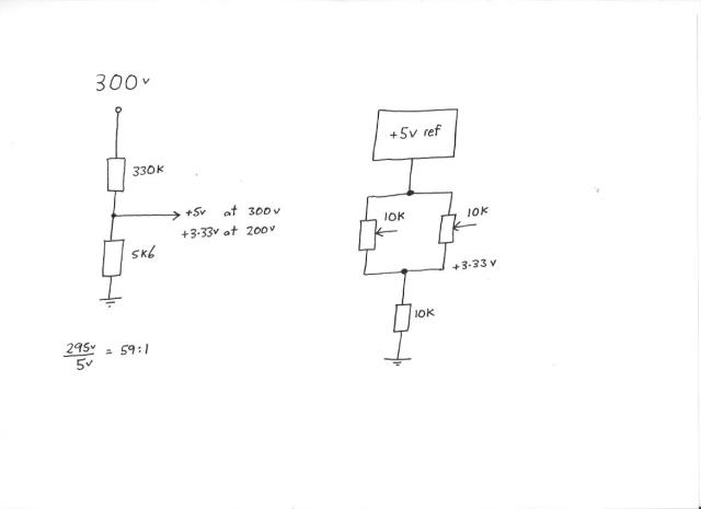

It all seems very complicated Mike.
Why not just a simple voltage divider and comparator ?

Posted: 04:13am 27 Jun 2019
  LadyN said
A voltage divider would "hardcode" the set point.
Not with a potentiometer.

Posted: 04:43am 27 Jun 2019
You can buy knobs with numbers on them:
For a system with a 230 volt heating element we could have the numbers on the knob correspond to 0=200v and 10=300v and scale a voltage divider to give us that range.
Eight 24v solar panels might have the maximum power point roughly in the 30v to 32v range per panel.
That corresponds to 240v and 256v for the max power voltage.
That would be around four and five point six around the middle of the knob range.
You can then tweak the set points above and below that over roughly a +/- 50v range.
The previous test I did suggested +/-5v per panel set points only lose about 7% of maximum power at the peak. With eight panels that might be +/-40v.
I don't think we would need to go much wider than that, so a +/-50v adjustment range should do us quite nicely.
In fact closer set points should raise the efficiency, but not by very much.
The system will also then cycle faster, especially if the electrolytic is on the small side.

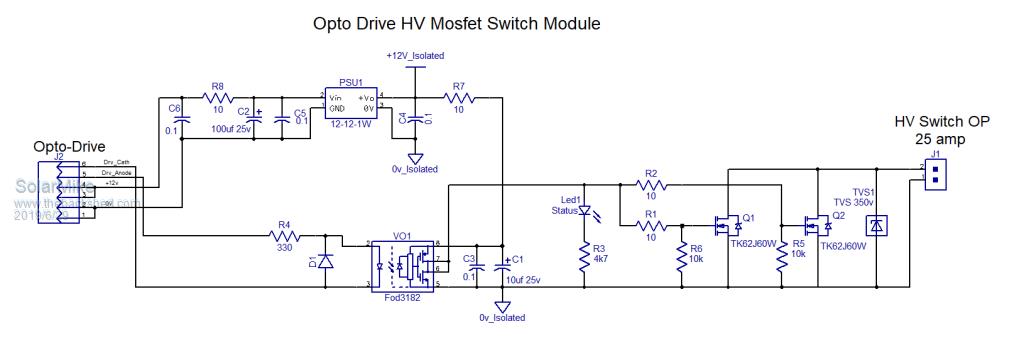

I like to modularize stuff, be it software or hardware design into re-usable components; so have made a start on the pcb design for this project.
First up is a simple High voltage switch module, using opto mosfet driver and an isolated 12-12 volt psu, Have allowed for two parallel mosfets, switching rates will be around the 50 - 100 hz so design is simplified somewhat. This module can be connected to the main dump capacitors and a driver to power the element. Sorry about the smd components, don't use anything else for low power stuff...
One of the things I would like to experiment with, is to make a full bridge using 4 of these modules and allow the polarity of the HWC element be switched to further prevent arc's forming on the thermostat contacts. I fear if the on duty cycle gets too large using a single mosfet switching the element, then there won't be enough time when the switch is off to suppress an arc.
Mike

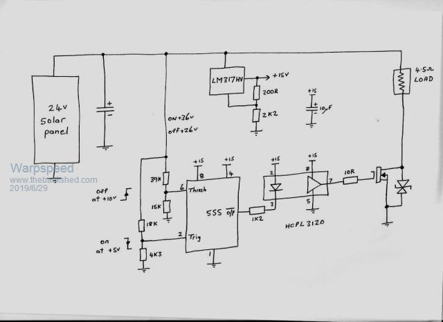

Posted: 08:19am 29 Jun 2019
Davo,
Mike's original circuit uses a pair of voltage comparators and a flip flop to switch a mosfet on and off. That is really all that we require.
Thinking about all this, a light bulb came on in my head that the popular hobby LM555 chip uses two voltage comparators and a flip flop
That will work, but the LM555 output goes logic low when on, and logic high when off.
So we require a second chip to invert the gate drive to the mosfet.
One other requirement is that at sunrise and sunset, the system will go through a miserable state of being starved for power and probably operating very erratically.
So it must have a proper under voltage shut down system to ensure the system starts up and shuts down very cleanly without the risk of frying our mosfet in the half on condition.
So I looked around for an inverting mosfet gate driver chip that has under voltage shutdown and could not find one. Then another idea... Many of the opto isolated gate drivers such as HCPL3120 or the FOD3182 that Mike prefers, have under voltage shut down built in.
Looking back at my testing of a single 200 watt panel, threshold voltages of 26v and 36v seemed appropriate for that, and I bread boarded this:
The only change to the above circuit to make a "full power version" would be the resistors that set the voltage thresholds, a suitable small Chinese +15v (0r +12v) dc power supply, and a few more mosfets.
Its fairly primitive with absolutely minimal parts, but all the essentials are there.

The above circuit is for a single 24 solar panel just as a basic prototype to test the whole circuit concept.
Something more practical would be more like eight 24v 250 watt panels in series (2Kw) with a 2Kw or 3.6Kw 230v heating element.
I will never build or test anything like that myself.
But the problem interests me, and I can throw something quickly together with parts I already have here, but it will only be with one small 200 watt solar panel.

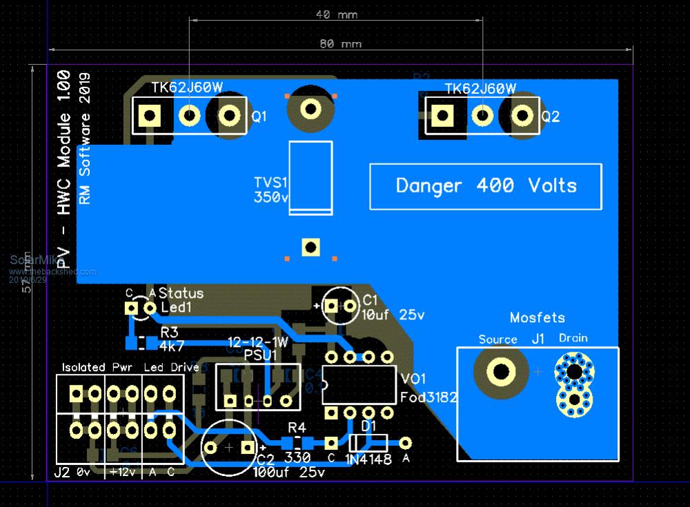

If anyone wants to make the power mosfet board here are the gerbers.
2019-06-29_195036_Gerbers_PowerModule101.zip
Mike

Posted: 01:06am 30 Jun 2019
Connected it all up and it works exactly as expected.
With 15,000uF and a 4.5 ohm load it cycles at around 7.8Hz in clear sun with a long discharge time.
With a 2 ohm load and 15,000uF its about 25Hz, and charge/discharge times are much more even.
That is probably more like how it might look with eight panels in series and a 16 ohm load.
In full shade it slows right down to less than 1Hz, but its still pumping power.
Mike's estimate of 10,000uF looks to be right on the money.
This all looks very encouraging !!!!!!!
