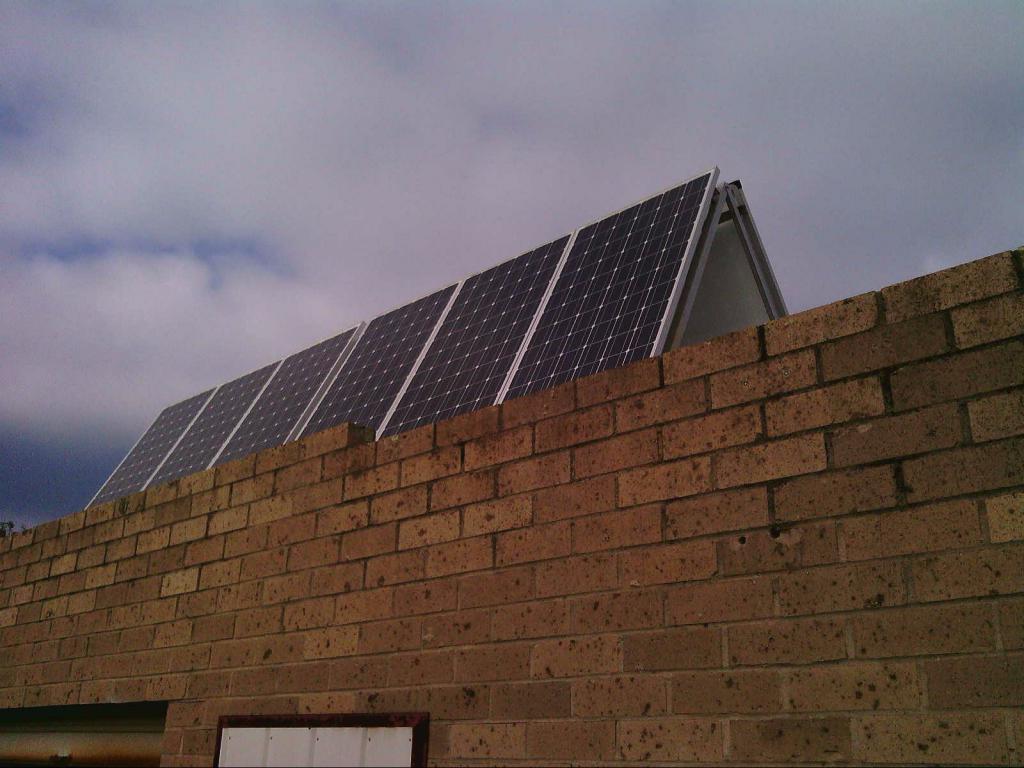

Posted: 08:02am 12 Oct 2019
  Quote  Was it you Tony that came up with the 60O east west panel configuration to deliver the most consistent output for battery charging?
No not me, someone else invented the "passive tracker" but it sure works very well.
Here's mine, 60 degree elevation facing due east/west on the garage roof.
Its only 1.2Kw + 1.2Kw but it gets going a good half hour earlier than the big north facing system, and hangs on for another half hour late in the afternoon (in summer).
The power comes up pretty fast at sunrise, remains almost constant all day long, then drops away rapidly at dusk.
In fact this might be more useful where there is no battery, or for grid tie where the max power that can be fed back into the grid is limited.
For battery charging or heating water, easterly facing panels might be best, where you want big power for bulk battery charging, or rapid heat recovery early in the day.
For airconditioning, westerly facing panels should give their max power in the afternoon and early evening.
Its best to think the whole thing right through, as different solar applications can benefit in different ways from most suitable panel orientation.
Davo99
Joined: 03/06/2019
Posts: 1586
Posted: 11:13am 12 Oct 2019
Exactly why I have put up an array on the west roof of my house.
Although not wonderfully insulated, The place does not get hot till 2 pm or later even on 40+ days. Once the heat permeates the walls and insulation though and gets low enough to come in the windows, watch out!
I suggested growing some seasonal Vines on the back west wall of the house the other day to provide summer shading and much to my amazement, The mrs said yes.
  Quote  Its best to think the whole thing right through, as different solar applications can benefit in different ways from most suitable panel orientation.
Exactly except most people won't do any homework on things and just want to follow the parroted mantra's or worse still, what a salesman tells them.
