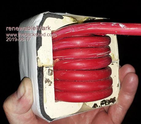

I have another choke for it, the same size as the one I did at your place, but this one I took my time on and got another two turns on it.
Probably wasted on such a small inverter but hey it's just sitting here.

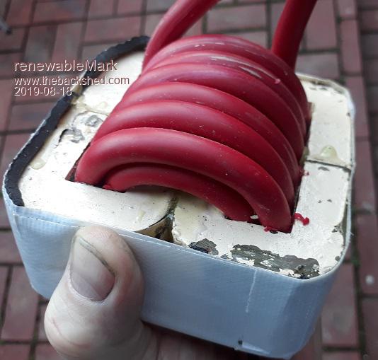

Posted: 10:02pm 17 Aug 2019
Mark, what is the sq mm of that wire, and how many turns did you manage to squeeze in?
renewableMark
Joined: 09/12/2017
Posts: 1679
Posted: 10:18pm 17 Aug 2019
There is two layers there of 25mm2 14 turns.
It's made from two of the bigger Aerosharp chokes glued together side by side.
Needs a proper clamp made for it yet.
Here is a better pic.
Cheers Caveman Mark
Off grid eastern Melb
Posted: 10:57pm 17 Aug 2019
  mackoffgrid said  Mark, what is the sq mm of that wire, and how many turns did you manage to squeeze in?
That is Tycab cable part number ABC136403.
Its 26.45mm sq and 10.2mm outside diameter, rated 168 amps continuous.
Tycab are the manufacturer and they do not sell direct to the public, but their sales rep will tell you who stocks it near your locality.
https://www.tycab.com.au/battery-starter/
The slot in those large Aerosharp cores (from memory) is 75mm x 20mm.
And with a 1mm air gap, and 12 turns it had about 175uH at 135 amps saturation.
Its difficult, but 14 turns are just possible if you try really hard.
Its as full of copper as is possible with round wire straight off the drum.

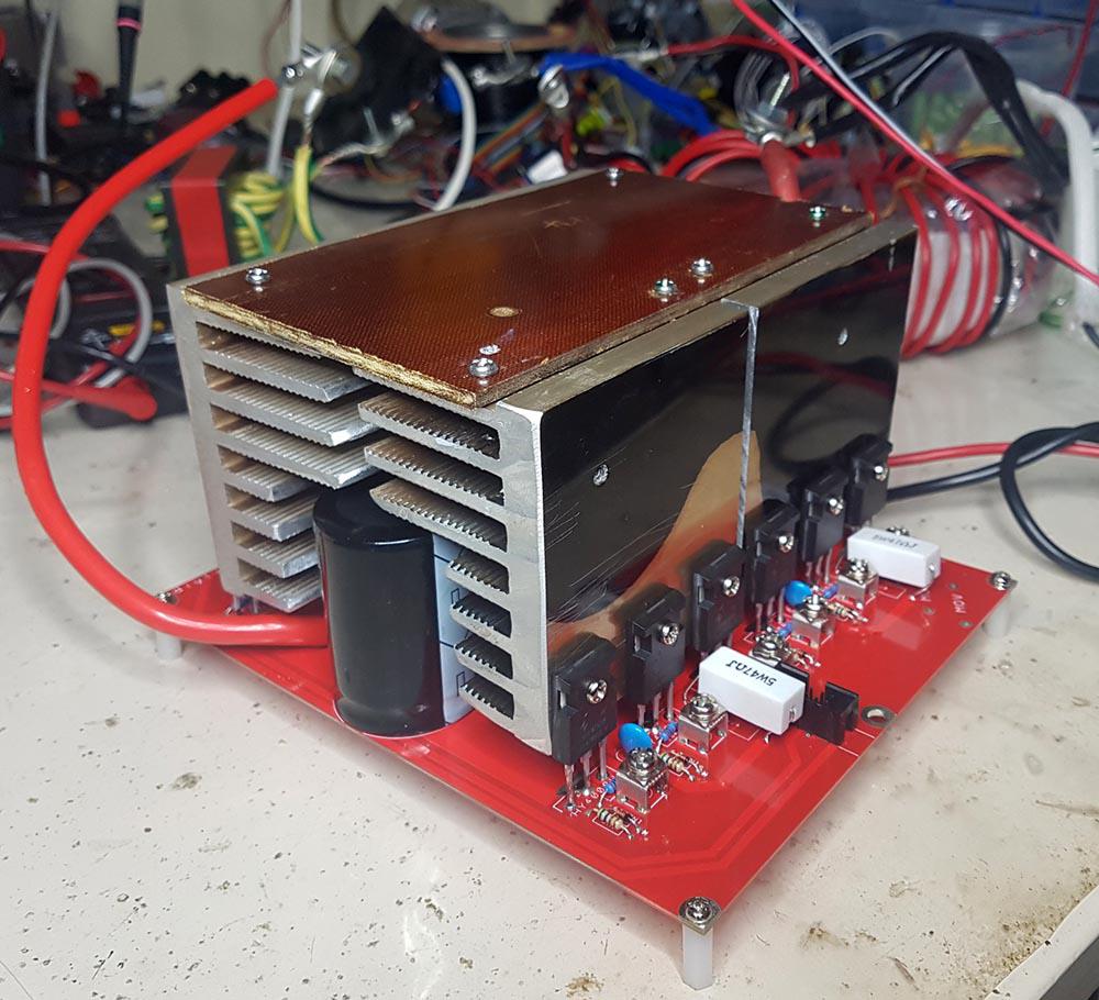

Mark and Madness:
I've just built my power board using the smaller version that Madness designed and sells (the 12 FET 4kW board)
Advantages:
fast to build, not needing lots of parts either. just 12x resistors,diodes and 4x snubbers.
Compact too. It's a good soldering PCB as well.
I used the offcuts from the large Mad board I built for heat sinks and
it works out perfectly (one 3kW Aerosharp heat sink can do both power boards)
problems:
none at all. The 4 10,000uF caps are a bit tight to fit but I ended up using only
3 of them, to permit the 4.7uF cap to fit in there as well.
I will refit the 4.7uF on the bottom of the PCB, then all 4 bulk caps will fit.
Here is how it ended up:

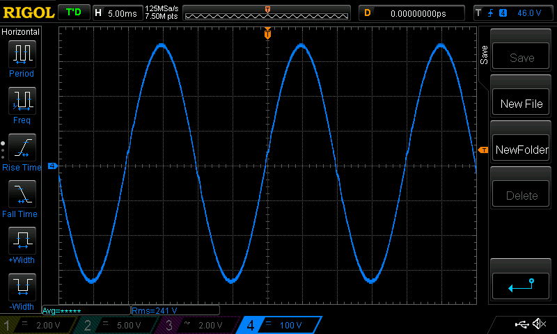

Waveform at idle is very clean and under 200W load becomes a perfect sine.
Here is idle:
I estimate efficiency (51V DC supply, 200W load) to be about 93.5%
With the 3 bulk caps fitted, under the 200W load I saw only about +/- 250mV ripple
on the DC supply. These caps are doing a great job.
I like this board a lot.
And my measure of quality is idle current. (I am obsessed with shoot through...)
When driven by the nanoverter, this combination has the lowest idle current
of anything I have here. This means smaller shoot through and/or better gate drive rise and fall times that minimise switching losses.
I think I can make a 1500W 50V inverter that uses only 10W at idle.

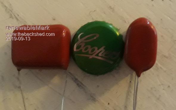

I'm good for the 4.7uF
I use the yellow $12 each ones from Jaycar.
I've since soldered it on the underside and it fits exactly right.
Not only do all 4 10,000uF caps fit but the 4.7 when on it's side
is the same height as the 3mm plastic posts I used, so I get some automatic
mid PCB support too. The weight of the heat sink bends the board a little.
What value is the Green cap you got there anyway?
renewableMark
Joined: 09/12/2017
Posts: 1679
Posted: 07:24am 13 Sep 2019
That greencap is 4.5%

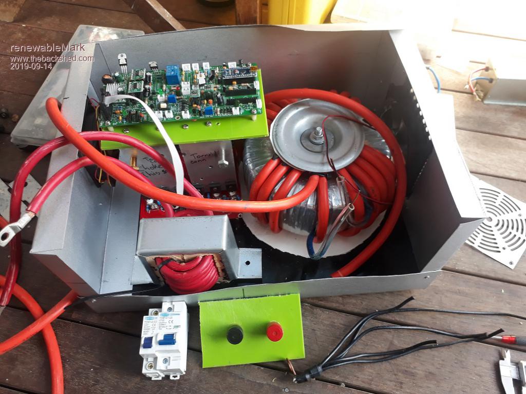

This sucker is going in the caravan, so I didn't want to use a big heavy aerosharp box.
Ended up making this ugly thing, needs a front and lid yet.
Anyway, I was going to do push pull fans like the standard vertical type layout normally has, but with this all sitting flat I was thinking both fans coule push inwards against the torroid and heatsinks.
Then fit some grate at the top lid area to let the heat out.
What I have found over the years is air blowing directly at something seems to work better than trying to extract hot air from a space.
Any brighter ideas?

Posted: 09:03am 14 Sep 2019
  Quote  What I have found over the years is air blowing directly at something seems to work better than trying to extract hot air from a space.
That is definitely true.
But two fans facing each other, may also result in bugger all total airflow.
Only way to know for sure is a practical test.

It probably won't matter much with this unit as it will have a very easy life at 200 watts or so load with the occasional microwave use, or the rangehood fan when using the gas top stove.
Heating is with a diesel unit.
Fans will probably see little use anyway.
It's a really crap layout, but it was done with little care due to knowing the very light loading it will have.

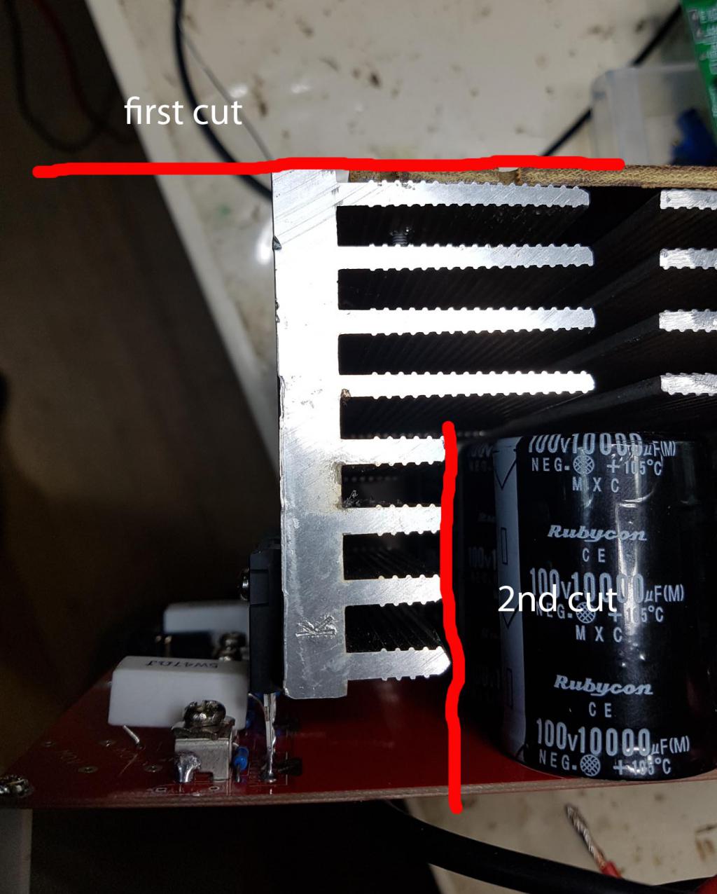

poida
Joined: 02/02/2017
Posts: 1497
Posted: 09:29am 18 Sep 2019
Mark, I sliced the 3kW heat sink lengthways, "1st cut" in the image.
Then I shortened the lower 4 fins, "2nd cut", cutting the now two narrow slices.
This gave me 2 long heat sinks that fit well and leave ample room
for cooling air and bulk caps.
I needed one long and 2 short lengths of this stuff for the large totem pole Madness power board. Some remained after I cut what I needed.
Two lengths of about 150mm remained.
These two lengths are enough to fit the 12 MOSFET smaller power board Madness sells.
renewableMark
Joined: 09/12/2017
Posts: 1679
Posted: 09:54am 18 Sep 2019
Yeah OK, you sliced it in half, so you ended up with 8 fin high heat sinks from one heatsink.
I used the full heat sinks and cut the height down to 13 fins or so from memory, then split them into their respective parts.
Yours was probably a wiser use really.

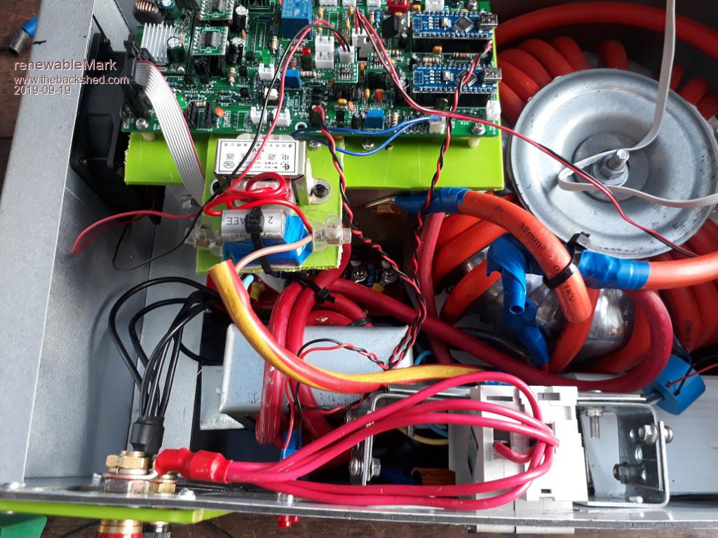

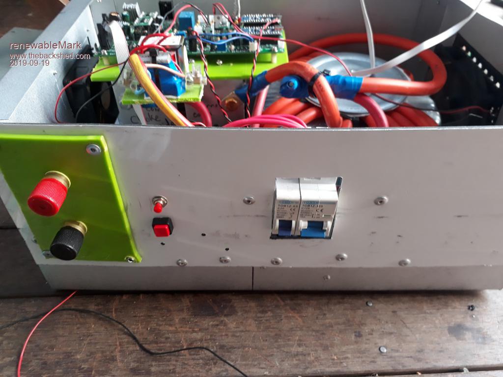

renewableMark
Joined: 09/12/2017
Posts: 1679
Posted: 07:28am 19 Sep 2019
Ready for testing.
The left breaker powers 2x 33 ohm resistors in series to the pos line (for charging caps) But without the caps fitted first this will be used for restricted power feed for testing the unit.
Right breaker is for + battery connection.
Square momentary is scr reset and round momentary is on/off
LOL when I had the idea to build a small one the idea came to mind it would be so, so much easier......... Nup all the same bits requires just a smaller power board and a bit less winding on the torroid.

Revlac
Joined: 31/12/2016
Posts: 1309
Posted: 11:44am 20 Sep 2019
Looks good Mark.
When charging the Caps, will you have a voltmeter/display, to show that it has reached full voltage, or will the nano show that?

renewableMark
Joined: 09/12/2017
Posts: 1679
Posted: 09:20pm 20 Sep 2019
Hi Rev, thanks, she's pretty rough but hopefully it will do the job fine.
The nano screen shows that voltage, haven't fitted that yet.
Need more short standoffs.
You can see the white ribbon cable above the torroid for it, but screen is out of the shot.

Bugger me, got a machine running without blowing a fet this time.
I did stuff around for a while thinking there was a problem, then found the oscilloscope probe wasn't on properly
Need to calibrate the nano screen yet.
