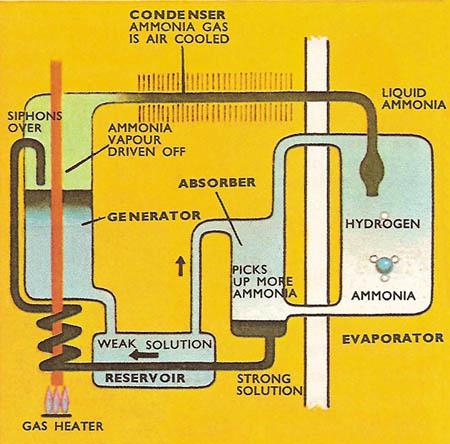

There is also the old technology of water ammonia absorption refrigeration.
Back in about the 1930's to 1950's people were buying refrigerators powered by a gas or kerosene burner. This was after the old melting ice block domestic coolers and before the electric age and grid connection and mechanical refrigeration.
Its basically a completely sealed system, without any moving parts, you heat one part of it with a flame burner, and it gets really cold in another part.
When I was a Technical officer working at the Victorian Solar Energy Council, we (the Victorian State Government) sponsored an experimental solar powered absorption airconditioning system.
It worked quite well in a mid summer clear blue sky, but even the slightest cloud and it would stop working.  It was also a very expensive installation, and was eventually scrapped  as not working consistently enough to be practical.
But it told us one thing. Something can be successfully engineered, but it may be just too expensive and too complicated to justify its existence.

They are still using the old ammonia cycle fridges for caravans with 3 way fridges (240v/12v/lpg), but with modern soft-start fridges and solar panel/lithium batteries becoming the standard, they are being dropped in favour of 'standard'household fridges on inverters instead

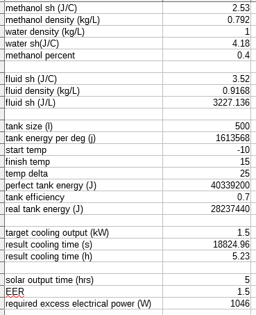

Davo,
Feasibility of implimentation aside for a moment. Here are my calcs on your methanol based idea using just a temperature deta and no ice. Actaully works out better than I thought it would truth be told. Some of the numbers I've put in might be a bit different in real life and I think getting even 70% efficiency out of the storage is probably a bit high, but at least it's in the right ball park.

Those old three way fridges are nifty. It nearly broke my brain when I was a kid and someone told me you could keep food cool using a fire.
Doesn't really solve this problem though. You're still getting the cooling in the middle of the day when batteries aren't a factor.

That's a much more scientific way of calculating things than I did it but still looks good.
I thought my numbers might have been a bit High but then I saw you were working on a temp differential of 40 being -20 to +20 which would go a long way to explaining the difference.
Mulling the idea over more, I have also had the idea to Bury an IBC for the storage tank. I have a suitable location in a presently disused garden bed I might just grow over with lawn anyway and if I inked the hole with coolroom panel or building  foam block, that  should provide insulation and lower the temp differential to outside the tank than if the tank were located above ground by a substantial amount.
If I used the tank for heat storage in summer, then again the temp differential is for the most part going to be less than if the tank was above ground especially with the sub zero winter temps experienced here even less than a fortnight ago. Never know it today being over 25 and bright sun.
Does highlight what I was talking about though, Miles of excess solar. I noticed your calc works on a 5.2 KW output. If I doubled that for 1000L capacity and added another 50% to allow for a 40o temp difference, call it 15 Kw Input, I still have power to spare well and truly above what the rest of the demands are in summer at least.
