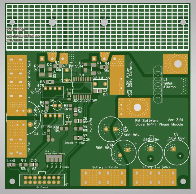

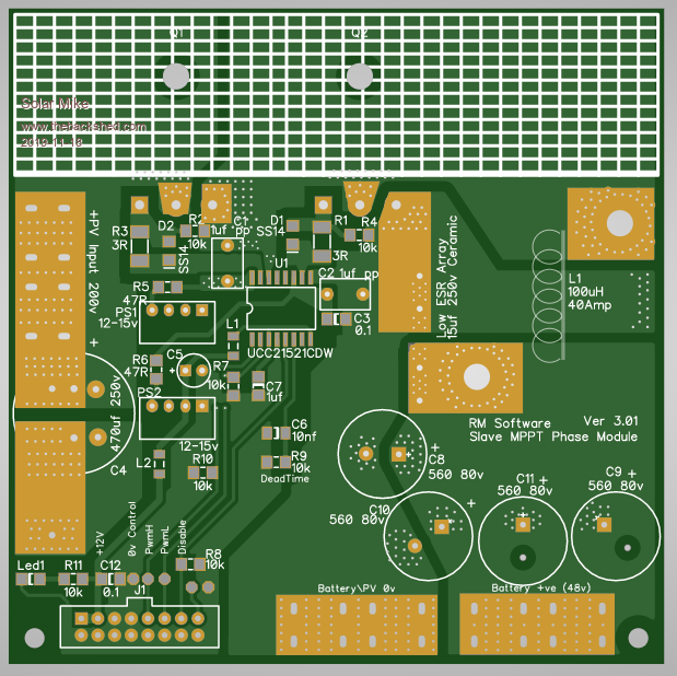

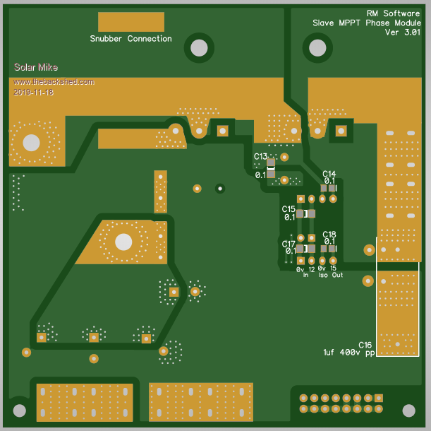

Module PCB completed, its been a bit of a mission to get everything inside a 100 x 100mm board. I don't have a schematic for this yet, will do this in the next few days in between renovations tiling the bathroom and kitchen, as a way of checking there are no errors.
The white hatched area is covered by a nylon insulator then an alloy right angle for mounting the two mosfets, the 4 phase boards are stacked above each other bolted to a common heat sink - each designed for 30 odd amps.
High PV and Battery current connections are made with bus bars bolted to tin plated brass right angle pcb connectors that protrude from the edge of the pcb.
Buck inductor is wound on one of  These Cores.
The ribbon cable connector with control power (12v) and drive signals plugs into all modules, note its 0v line is isolated from the modules high current lines. Edit: (Just noticed an error on this cable connection, will fix it)
Top:
Bottom:
I need to make a mother board now with CPU etc, This will also have some larger Bulk input capacitors on the PV side, output ones don't matter so much here as the battery is a near infinite capacitor.
Mike

How many turns do you need on that core for 100uH?
Solar Mike
Joined: 08/02/2015
Posts: 1255
Posted: 10:05pm 17 Nov 2019
  mackoffgrid said  How many turns do you need on that core for 100uH?
You can work it out from their spec sheet, about 25T, waiting for items to arrive so haven't tested with my Inductor saturation curve tracer.

Posted: 10:33am 18 Nov 2019

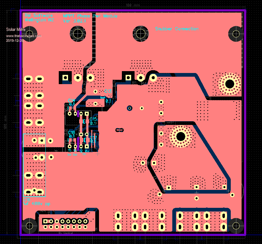

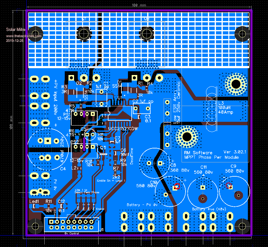

Fixed my input stuff up, all 4 PWM phase signals are now on the ribbon cable, solder blob link on the pcb selects wanted input; this is fed into InA on the chip, InB is switched by a mosfet to get an inverted input, the chips dead time fixes any crossovers.
All changes on the top layer.
Note if the DW version of the UCC21521 is used, the PS1//2 can be changed to 12-12 volts, I'm using CDW variant as the DW doesn't seem to be available in small quantities.
Time now to draw up a schematic.

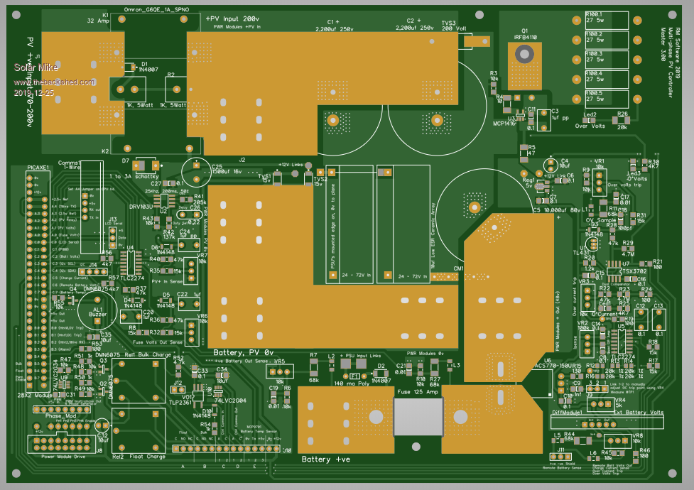

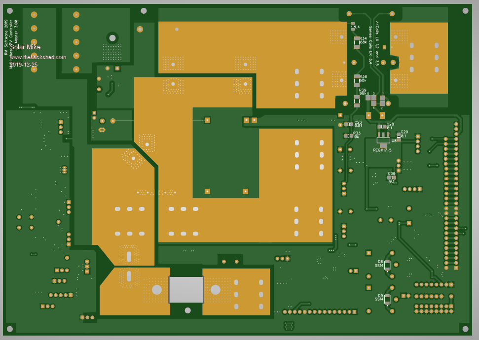

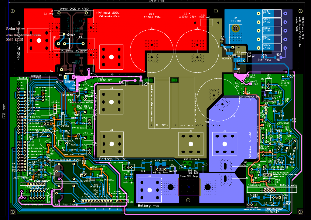

About time I got back to this again, the host multi-phase controller pcb has finally been designed, 4 phases have been implemented allowing use of 1 to 4 mppt buck converter boards mounted above the main pcb. Vertical copper bars bolt to the 120 amp connectors on the host pcb, the power boards connect to these via right angle connectors.
Host board has a Picaxe 28X2 cpu module via plug on connector, allowing a swap out with another cpu for experimentation later, the 4 phase PWM output runs at 62 Khz at 10 bit resolution, with a solder link on the power modules to select the required phase drive. I have added modules for remote battery voltage sense and 1-Wire local area network.
Multiple controllers can be slaved to a master for common control of voltage and charge end points. I2c and serial outputs can be connected by wire headers. Added a couple of relays for activation when in "Bulk" or "Float" charge states.
Will post the circuit soon as I get it done.

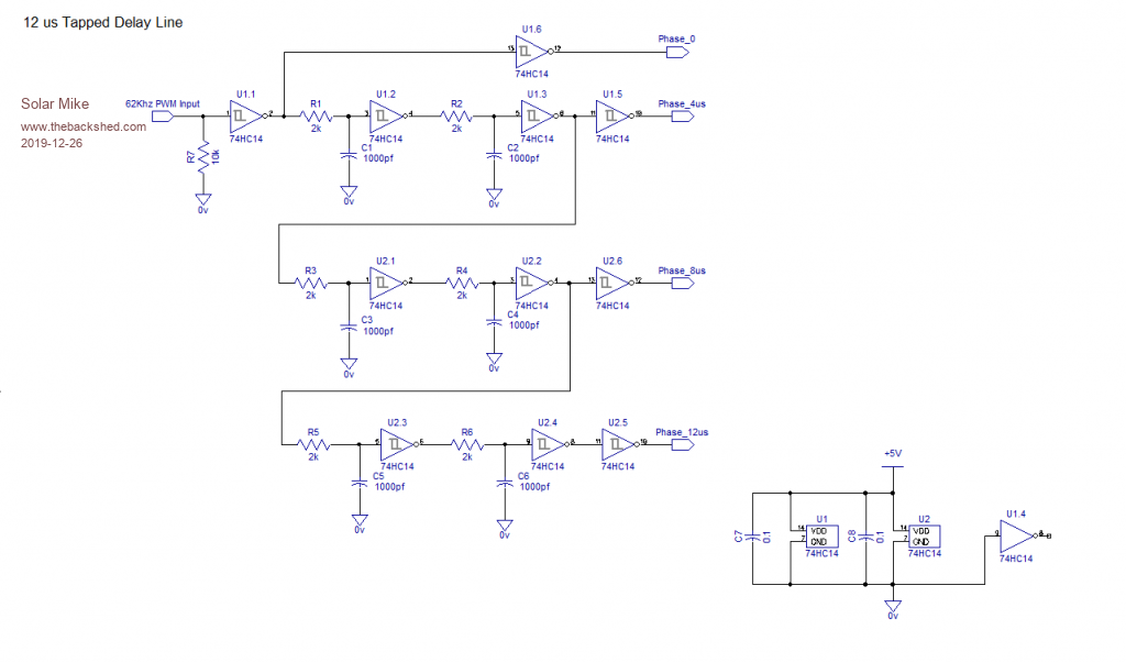

Will make a start on the schematics:
The 4 phase circuit has a number of Schmitt trigger inverters acting as 2uS delay units, with delay taps at 4,8,12 uSec. Implemented on a small pcb that plugs into the main controller board. Such a simple circuit means the minimum PWM duty cycle cannot be smaller than 2uS, with PV voltages approx 2-3x the battery voltage, this shouldn't be a problem as long as the PWM frequency sits around 62 kHz; any higher and the delay sections will need reducing in time, possibly requiring more of them.

Gerbers have been sent to JLCPBC for the host pcb, phase delay and mppt power boards, hopefully will get them back early in the new year.
Here are some details on the design.
Referring to schematic xxxx_P1.pdf:
PV array power connects to the bulk supply caps C1,2 on the host main board via two high current Omron G6QE 12v power relays, contacts in parallel, the contacts are bypassed by pre-charge resistors to allow near fully charging of bulk caps prior to energizing the relays, this prevents excessive arcs.
A specialized PWM relay driver chip is also used here to lower the coil power dissipation, all under control of the CPU; have gone down this route for controlling the PV isolation from the battery rather than use of several paralleled mosfets, as I consider it to be more reliable, especially when subjected to possible high voltage spikes from lightning or similar; costs are similar either option.
Common output current sensing is done with a ACS770-150U, the circuit also allows for the bi-directional 150B, depending on what is available. These sensors get hot up around 150 amps and perhaps not the best option for higher power, will see how they go, one of the ones that clamp around a copper bus bar would be a perhaps a better solution.
There is an over current trip circuit with an interrupt signal to the cpu; may or may not do anything with this; originally I was going to wire it to a logic gate to turn off the PWM drive, independent of cpu.
The over voltage trip circuit is there to protect the components should the battery connection open (fuse or breaker popping etc) when under high charge currents. A clamp circuit is activated that shunts a 10 amp load across the output and concurrently interrupting the cpu; this should protect things from excessive voltages whilst the cpu is still processing to shut down the output.
Referring to schematic xxxx_P2.pdf:
Rail to rail op-amps used for cpu voltage sensing, each connected as a low pass filter to reduce switching noise and present a low impedance input to the cpu adc inputs.
An opto-coupled isolator is used to allow one way communications from a master controller to others connected to the same battery bank, this will allow all controllers to switch state at the same voltage and current control points, eg. bulk charge voltage, float etc. Some commercial units have this feature and seems like a good idea.
Two output relays, one for bulk charge state, other for float are there to allow external circuitry to use these control states for application of external battery loads etc.
A differential instrumentation pcb module is used to sense the battery terminal voltages for more accurate measurement by cpu, the 1-Wire module is used for network comms to allow any site external devices to monitor the charge controller status (future requirement).
Two headers on the main board have I2c and serial data for connection to some sort of local LCD display.
For battery temperature sensing, have used an MCP9701 chip, rather than say the 1-wire DS18B20 sensors, they are accurate and reliable; if using the Picaxe cpu, it has to dynamically change its cpu clock to communicate with the 18b20 sensors, completely stuffing up the PWM drive output.
More on the mppt power boards to come...
Mike

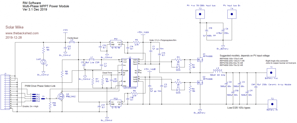

Posted: 12:03am 28 Dec 2019
Finally drawn the schematic of the power module, and to my relief, it does match the pcb layout, as the gerbers have already been sent off to production...
Starting on the LHS ribbon cable connector, all 4 PWM phases are input, a link selects the required phase.
Heart of the circuit is the UCC2152 half bridge chip, its inputs are 5v logic compatible and fully isolated from the output power stages, output dead time set by R9 and is guaranteed under all input conditions, allowing input "B" to be created as an invert of the "A" input by using a mosfet. This makes driving the buck inverter power stage much easier and way less prone to spurious inputs blowing up the mosfets.
Different versions of the chip have differing under voltage lockout sensing for the power stages, one I'm using here requires 15 volts as I couldn't get any of the 12v versions, think they are available now though, simple change the PS1,2 switch supplies to 12-12 type.
The enable input when taken to logic High turns on the output stages, so in conditions of discontinuous PWM drive, the CPU can simply turn off the mosfets so preventing any large reverse currents flowing in the output buck inductor.
The buck outputs from all power modules connect by copper busbars to the host controller board, this board also has larger bulk supply and output caps to augment the ones on each phase module.
Note: This circuit is all theoretical, none of it has been tested and relies heavily on cpu software yet to be written.
Mike
Posted: 10:53pm 28 Dec 2019
Mike, if you do an analysis of what happens when the MPP solar panel voltage is well matched to the battery voltage, the controller should only ever be seeing very high duty cycles during bulk battery charging.
When the battery hits full voltage and the controller goes into absorb mode, both the duty cycle and current through the controller taper off.
In other words, the lower mosfet can be replaced by a shottky diode with minimal penalty.
Under heavy loading the shottky diode conduction period and losses are absolutely minimal.  As the system throttles back, the shottky duty cycle certainly increases, but the current through it also decreases.
Using a diode instead of the lower mosfet eliminates a lot of potential problems and blow up modes, while having less effect than you might expect on total heat dissipation at full power or efficiency. I believe the slight tradeoff in overall power dissipation is well worth the long term reliability gained through eliminating some really nasty potential failure modes.
