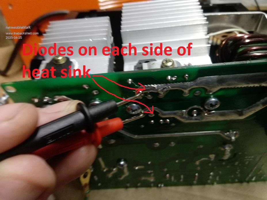

Mike there was another two connections, total of 6 ends, so 3 coils.
OK so the common connection on the right is the one that goes to the negative output on the welder.
That common connection has continuity to each of the other two ends.
Those two ends go to the left and have a diode on each side of a heatsink.

Ok, pull out the two ends going to the diodes and add 2 more turns to them and terminate the new ends in the same holes - wont matter if they cross over (swap sides) in the process it is a full wave rectifier.

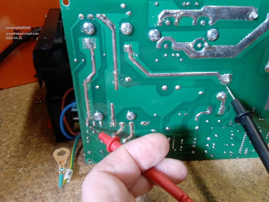

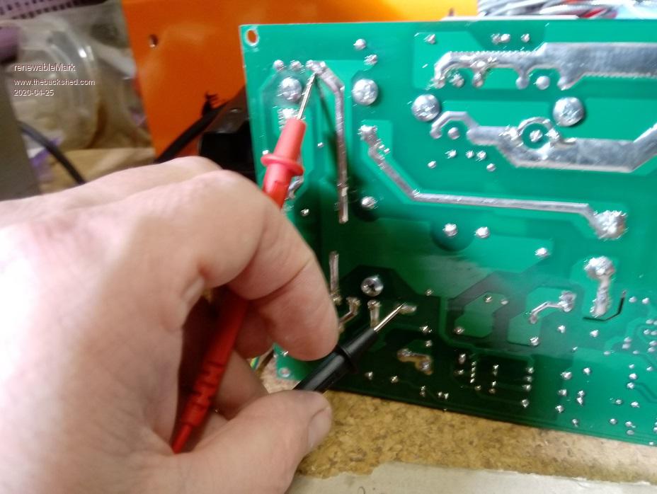

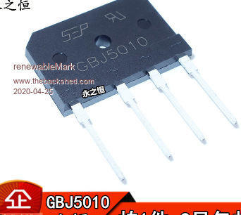

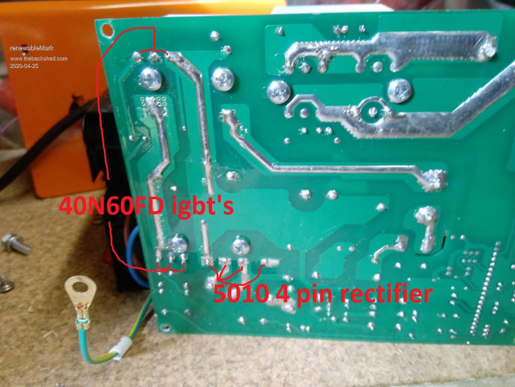

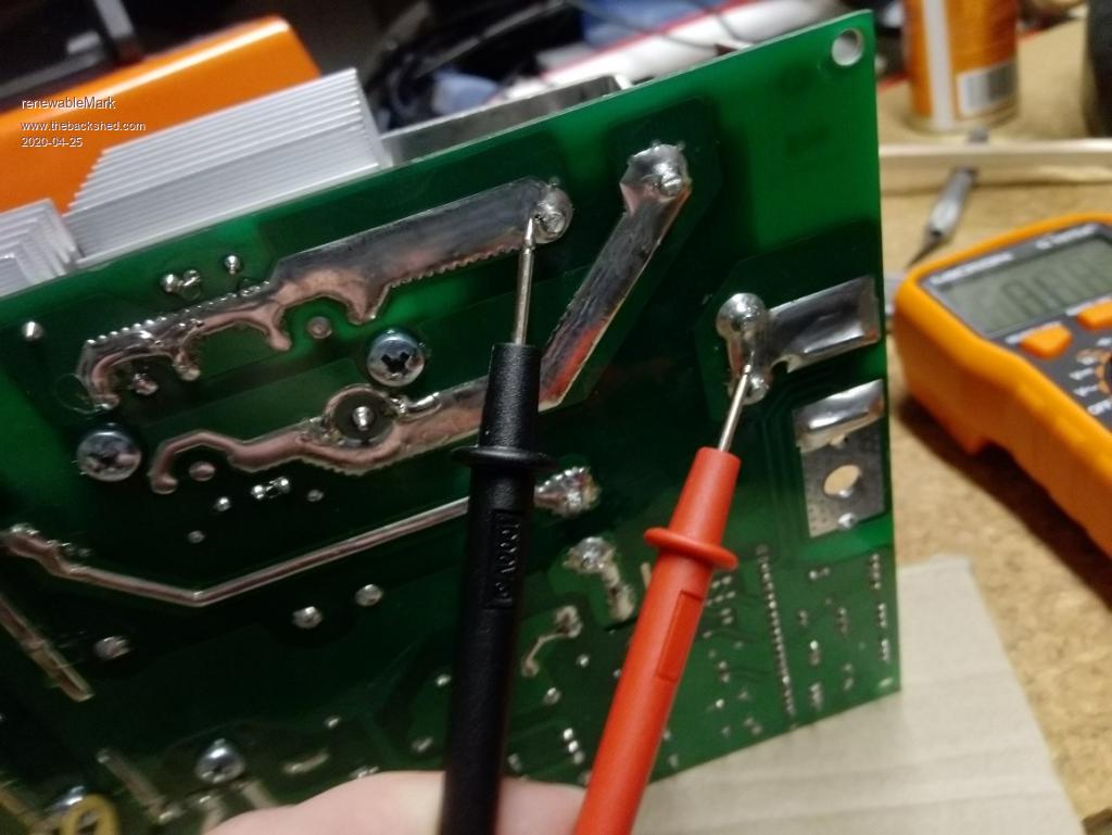

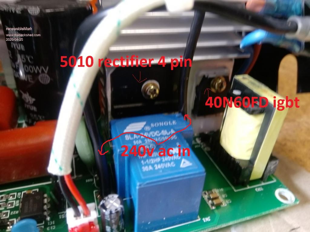

Did a bit of tracing back to see where things go.
Where I'm holding the probes there is continuity.

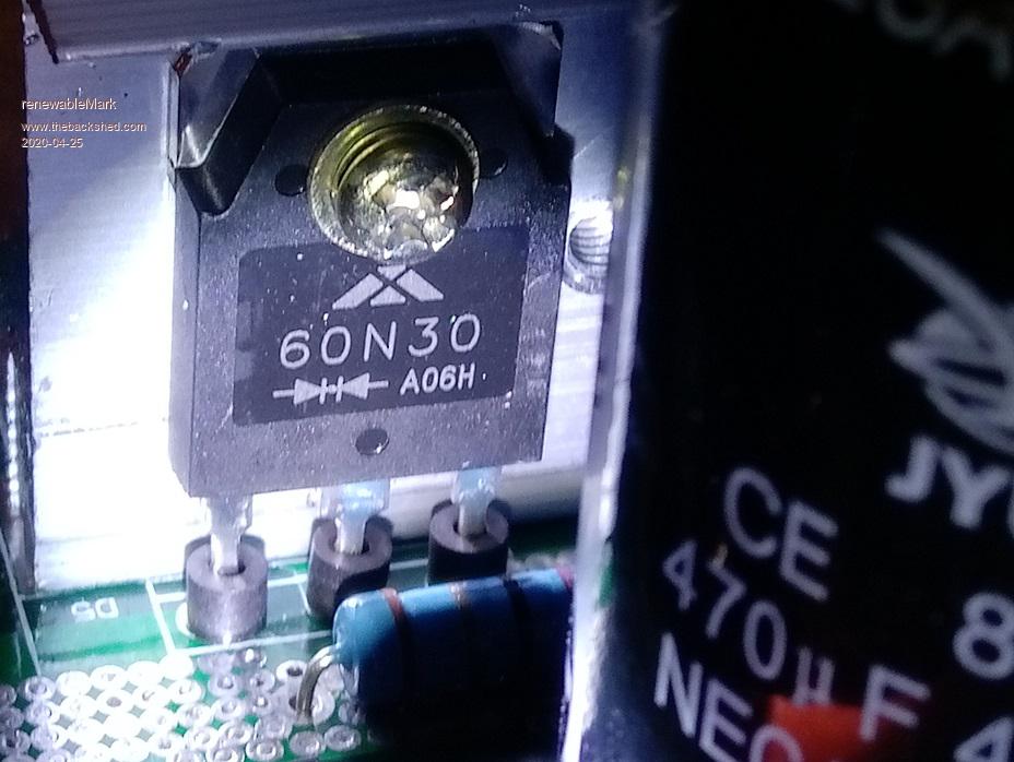

So it looks like the 5010 rectifies the 240v and the IGBT's control the feed to the HV winding (where the two connections are in the centre)
Then the two windings connected to Neg and diodes pick up the lower voltage.
Edited 2020-04-25 09:48 by renewableMark

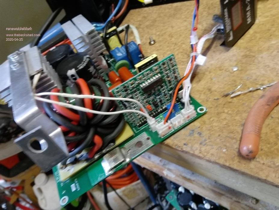

Well done Mark good detective work.  It appears to have 2 x IGBTs making it a half bridge drive to the output toroid.  The Other side of the power winding appears to go through a one turn current sense transformer (the little thing marked by small single arrow "here" in your third picture) and then through a big film capacitor (reddish thing) back to probably the negative side of the 470u capacitor.
Open circuit voltage can be misleading I see yours uses a snubber across the diode - this may be the reason for your lower voltage.  The 75 - 90V measured by others may not be a "real" voltage and have little current available behind it.
