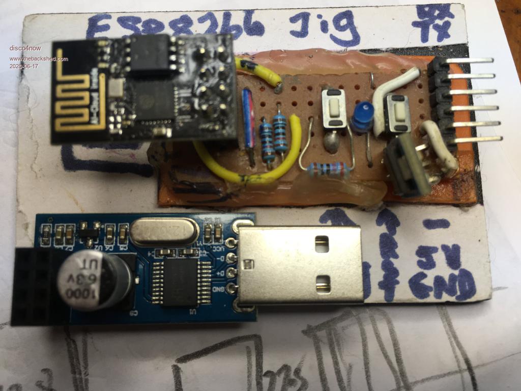

disco4now
Joined: 18/12/2014
Posts: 1151
Posted: 10:57am 17 Jun 2020
I use this circuit
from here. You connect to it with a USB to serial adaptor.
Hold the flash button down and reset to get it in programming mode from memory.
Using 5V to power the ESP-01 could damage it beyond repair. My USB adaptor had 5v out so I put a 3.3v regulator on the adaptor board.
Also one from Banggood that has USB inbuilt. You need to add the buttons to it I think.
Edited 2020-06-17 21:12 by disco4now

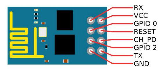

Posts: 3881
Posted: 11:55am 17 Jun 2020
I use a breadboard version of disco4now's circuit (but without the regulator--I power it from 3V3 off of an 18650 battery). I would not be certain that 5V off of a USB/Serial module would always be beefy enough (but if it works, it's "good to go".)
I also use the adapter with mods shown here
It allows you to flash the Annex firmware to the ESP-01 without the RST and FLASH buttons.
Grogs--The AT commands you need are likely to work on the ESP-01 out of the box regardless of what version the device has been flashed with. I don't know, though, whether greater range or stability or lower current usage can be had with the Version 2 software.
You can hook up 0V, Rx, Tx, and sufficient 3V3 to a usb/serial module, connect at 115200 with puTTY or other, and test AT commands from your PC, e.g., AT<Enter><Ctrl-J>.

Chopperp
Joined: 03/01/2018
Posts: 1131
Posted: 12:12pm 17 Jun 2020
Thanks disco4now & lizby
Great stuff.
I checked my USB to serial converter. Although it says it was the 3.3V version, the V+ was at 5V. Sig lines at 3.3V. Definitely use a regulator
Good pinout image.
