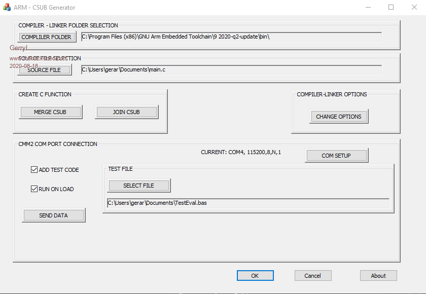

Hi All,
Attached is my prototype Windows application I use for creating CMM2 CSubs you may find useful as the C source code file to be converted can be in any folder and easily selected using the standard windows GUI. If wanted it will also send the created CSub to the CMM2 SD card over the console link, and if selected and you have a MMBasic file containing test code for the CSub it will append the just created CSub to the test code, send it and then automatically run it on the CMM2.  Essentially it allows me to create and test CSubs without leaving the comfort of Windows. I can now efficiently lockup my CMM2 in half the time due to my bad CSubs. javascript:AddSmileyIcon('') I have included some instructions as well.
Gerry
CSub Gen Instructions.zip
CSUBGen.zip
