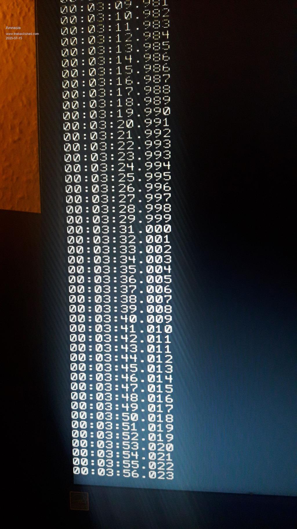

just to be pedantic run the following:
option milliseconds on
do
pause 1000
print time$
loop
is the time incrementing by 1 second +/- 2 mSec?

Posted: 10:05pm 14 Jul 2020
  matherp said  just to be pedantic run the following:
do
pause 1000
print time$
loop
Here it is...
Posts: 6602
Posted: 10:38pm 14 Jul 2020
Your timing looks good so that is not the problem.

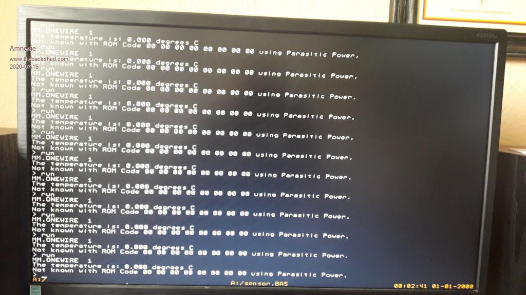

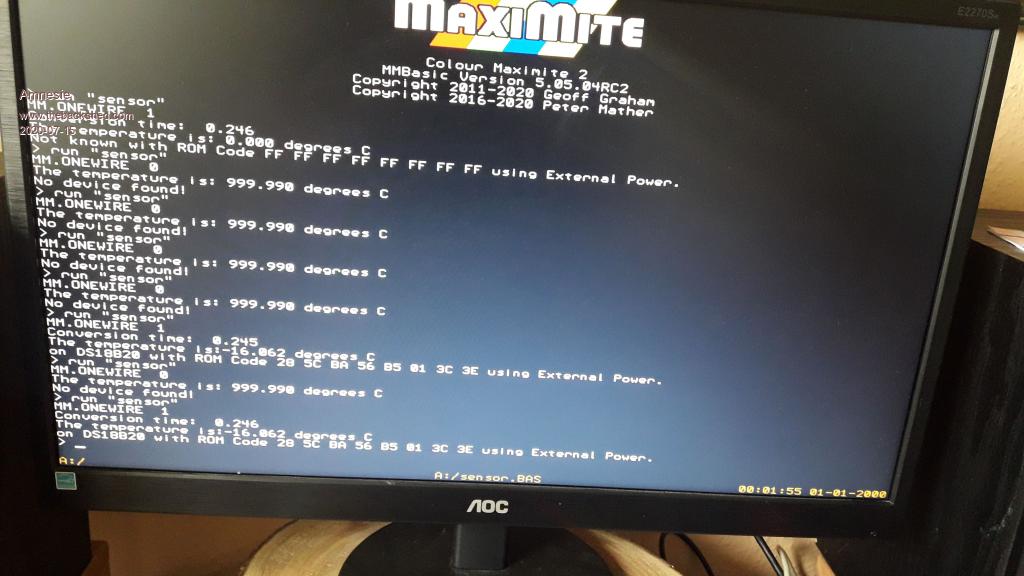

Amnesie
Joined: 30/06/2020
Posts: 763
Posted: 09:55am 15 Jul 2020
Hi,
thank you Jim for the help, my ds18b20 is reacting every time different. On the image you can see all kinds of errors. :(
I attached my ds18b20 libarary, which works for all my sensors on the atmega328p below (maybe anyone can spot a difference?)
@ Volhout, no I am using just one ds18b20 at a time. I am used to this sensors from my atmega328 projects, so at least, I know how to work with them on the atmega328p (there all three work). I just mention three because I have got all the tested individualy with the maximite. None of the works all the time.
On the image, you can see 3 different "states" / possible readings (I don't know how to call it), over the time, all those redings are repeating in a coincitential sequence.
I took a picture, so you can see all three  possible readings.
It is interesting, that with this program, the temperature isn't correct (if it has found the sensor). -16,062°C? Also the ROM Code appears to be whether FF FF FF ...
or 28 5C BA 56 .....
Now
With this library for my atmega328 all three sensors work! Just in case you can see some differences...
Edited 2020-07-15 20:09 by Amnesie
Posts: 6602
Posted: 10:08am 15 Jul 2020
The conversion time should be about 600mS.
It looks like the data being returned is very unreliable.
Do you have a CRO that you can monitor the data line with?
Can you change it to parasitic power and try again.
That way the program waits 750mS rather than interrogate the device while waiting for the conversion to finish.
