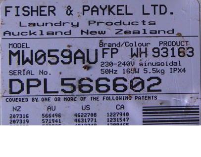

I post this photo from another thread.
It would seem that a F&P machine is rated by the manufacturer at 165W only for this model, but we push the stators to 300W.
I would suspect that there may be a particular wind energy level where the efficiency approaches levels described by Dr Chalko, but at the extremes that occur with wind energy and the inability to load precisely with so many variables that the efficiency probably is around the 50% level for most windmill installations.

Gill
Joined: 11/11/2006
Posts: 669
Posted: 03:54am 31 Aug 2008
Gordon,
I note most (80Series) F&P Smartdrive are rated at 165Watts, from the 5kg washer through to the 7.5kg machine which I think is odd as whilst all machines use the same motor, the load of wet washing being spun varies greatly.
I have one that varies from 165W, a 5.5kg, rated at 200Watts but this has the 60Series motor.
I have no 100Series in a washer to check what F&P rate them as.
Cheers Gill _Cairns, FNQ
