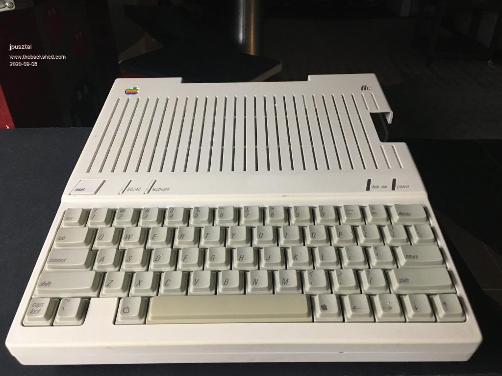

[B jpusztai]- Awesome case idea!  The Sol-20 and Apple //c were both on my mind as I was designing my case for the CMM2.  I'm a southpaw, so I decided to put the card slot on the left.

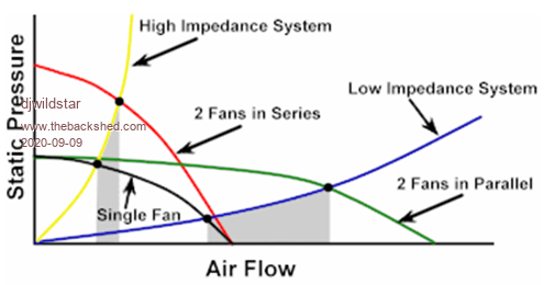

@vegipete - Air intake filters and positive case pressure are great at keeping dust and lint (and cat hair) out of the inside of the case.  If you're going to use air filters, positive pressure is the way to go -- it is otherwise impossible to put filters over all of the possible air-entry-points in the case.
If you want to set up the fans in a series configuration (one blowing in and one blowing out), I'd suggest moving one of them.  It wouldn't be hard to place them on opposite sides of the back panel and arrange a baffle that directs incoming cool air over the CMM2 and ensures that outgoing air is drawn over the amplifier.
I went with a parallel configuration because that provides for a nearly-linear relationship between the impedance of the case and the overall airflow (the green line between the yellow and blue lines in the attached chart).  It also made it easier to direct where the cool air went, since I could drill intake holes in the bottom directly underneath the CMM2 and amplifier rather than having to set up baffles inside the case.

I would have thought the TI 99/4 was also one of your inspirations - I always thought that was a sexy design. And the Sol-20 is such a classic look - love that Teletype keyboard and painted blue metal! Wood side panels are making a big comeback, BTW - they are practically de rigeur for contemporary analog synthesizers.

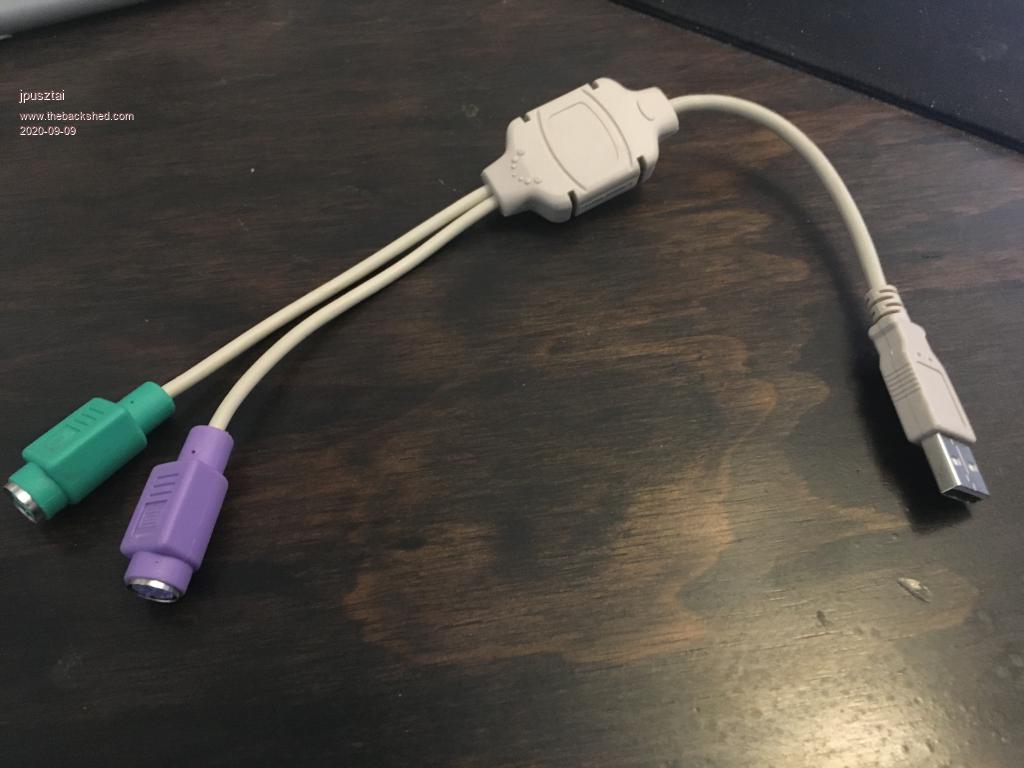

Will PS/2 to USB work in the CMM2?

I can only give you the "Works On My Machine (TM)" guarantee, but yes.
Unfortunately, it has no identification on it, but FWIW, mine looks like this:

  Nimue said
  jpusztai said  As far as hobbies go, retro-computing is one of the cheapest and most mentally rewarding - 0% to be guilty about :) And, if you are on eBay, you can find vintage IBM keyboards from the 1980s that are better and cheaper than anything you can buy new, IMO. A cheap PS/2->USB adapter will do the trick if you need one.
A lot of the adapters are simple converters with no logic in them.
IF your keyboard is designed for both USB and PS2 and you have the correct adapter, Yes.
Most keyboards are NOT designed for both USB and PS2.
If you want to use a standard PS2 keyboard on the CMM2, you will need an 'intelligent' converter.
