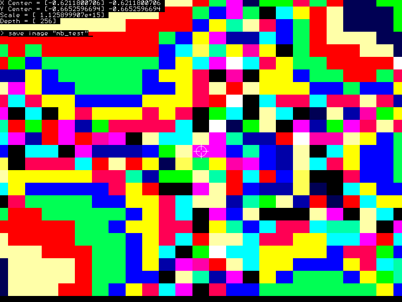

It looks like numerical limits to me. I had the depth set at 200. 'Pixels' were becoming huge blocks on the screen. (800x600 mode)
Here is another sample, depth even deeper:
(I notice x and y coords are listed twice.)

  vegipete said  It looks like numerical limits to me. I had the depth set at 200. 'Pixels' were becoming huge blocks on the screen. (800x600 mode)
Interesting!  I wouldn't have thunk it possible.  I guess I've never zoomed in to 1,000,000,000,000,000 X before?  I'll do some more playing with this later.
The coordinates in brackets are for the current view and the second set of X,Y coordinates is for the current cursor position.
