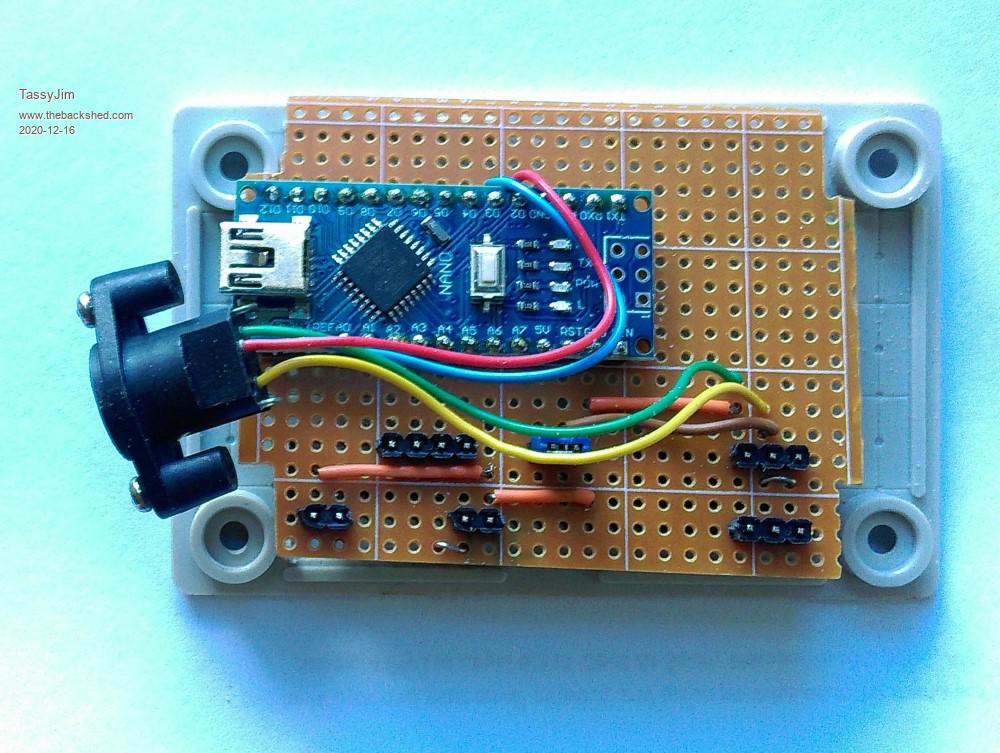

Mouse mark 2.
PS/2 mouse to HobbyTronics converter using an Arduino Nano
Also includes joystick to HobbyTronics mouse converter.
If you are only interested in the mouse function, all you need is the Arduino nano and a couple of connectors.
For the joystick option, you need 4 10k resistors and a joystick post connector.
A switch to change from mouse to joystick is also required or you could use a shorting jumper instead.

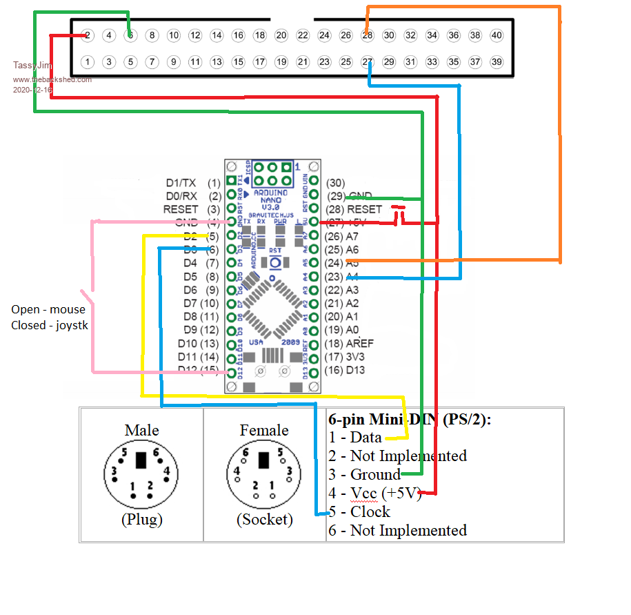

For the mouse this is all the required connections:

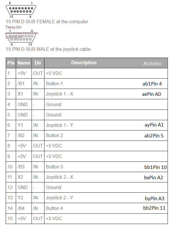

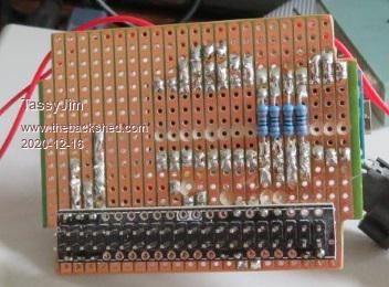

If you want the joystick, there are 4 10k resistors connected from
A0 to D9
A1 to D8
A2 to D7
A3 to D6
These pins were chosen to make it easy to connect using a breadboard or stripboard.
The joystick port is connected using the following table:
PS/2 mouse only
Underside with 10k resistors added.

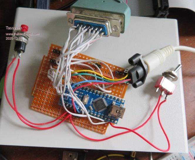

Complete with external reset button, mode switch, joystick port.
When programming, remember to isolate the 5V from the maximite so the two supplies don't get tied together.
The system runs happily with the Arduino power coming from its USB port.
To use with a PS/2 mouse, leave pin 12 open (Internal pullup)
To use with a joystick, ground pin 12.
You should be able to switch between the two modes with power left on but will need to re-initialise using CONTROLLER MOUSE OPEN

Hi Jim.  On the mouse only diagram, what is that symbol on the line from pin 2 on CMM2 going to pin 27 on nano and 5+ on ps2 port? Is that for a momentary switch normally closed? I am going to build this today and want to make sure I got everything right.  Thanks.

  mclout999 said  Hi Jim.  On the mouse only diagram, what is that symbol on the line from pin 2 on CMM2 going to pin 27 on nano and 5+ on ps2 port? Is that for a momentary switch normally closed? I am going to build this today and want to make sure I got everything right.  Thanks.
That is a jumper so you can remove the 5V from the nano when programming it via it's USB cable. If you don't disconnect the micromites 5V, you will have both 5V supplies tied together and that is not a good idea.
You could always unplug the device from the micromite every time you want to reprogram it but having a jumper on the power is much easier. That way you can use the Arduino IDEs serial port monitor to watch what is happening while using the mouse. I certainly needed that while developing the program.

Thanks, Jim.  that makes sense.  I was just going to unplug each time but now I think I will add the jumper.  I am having trouble getting the fine soldering on the salvaged PS/2 port I ripped off an old PC motherboard. I hope to get it going soon.  I also took most of the day trying to get my PC to see the com port and it turned out I had way too many USB devices and Hubs plugged in and it just did not have enough system resources to add the USB serial port.  That was a first and I didn't know that was a thing. I will drop a line if I get it to work.  OH, where is that mouse testing program you had in early versions of the zip?  I looked back to all the downloads I made of it and this one is the most recent one.  Will it work with this?

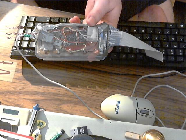

Well, I finally made my mouse interphase.  This is my FrankinMouse setup until I get the parts to make a tidy one.
The scroll wheel is not working from your second test program.  Not sure if that is an issue with the mouse.  I get all three buttons and a smooth mouse movement. Thank Jim for a wonderful option and I love that it is open source and so affordable. because I had all the parts but the NANO it all cost me $1.30 shipped.  That is very cool and I also did my first Arduino project and got some soldering practice.

  mclout999 said  Well, I finally made my mouse interphase.  This is my FrankinMouse setup until I get the parts to make a tidy one.
Good to see it up and running!
I did the second program with the cube before the scroll wheel code was fixed by Peter so that is why it doesn't do anything.
I might change so the wheel does the zoom in and out instead of left clicking.

Joined: 05/07/2020
Posts: 514
Posted: 08:45pm 17 Dec 2020
  Quote  I did the second program with the cube before the scroll wheel code was fixed by Peter so that is why it doesn't do anything.
OK, thanks.  So most likely the scroll is working and will be available. I will check out the new test program when you post it.  I wonder if matherp made a test program somewhere for the wheel maybe when he announced the HT upgrade. I am going to go look for that.
I might add that I have several MS optical mice that have USB to PS/2 adapters and none of those work. They light up but have no function at all. I wonder why? I have been checking out some of the programs that would not work without a mouse and it is nice to see them running. It is very cool to have a mouse.
