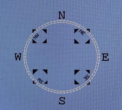

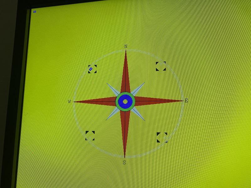

If you see this post, have you any idea why I'm getting the black triangles around the intermediate directions?
I've quite possible made an error when adapting your code.
There's also a "spare" blue rectangle in the top left corner, not sure if that's related to the code or not, it doesn't appear when I run the weather code that doesn't have the image rotate section in it
I made it yellow so it's easier to see the artifacts, and it's an up close shot of the screen

yock1960
Joined: 18/08/2020
Posts: 167
Posted: 10:39pm 08 Jan 2021
What's the background color when those texts are printed? Image rotate copies those pixels, but then they are rotated and those black portions are they underlying background (I think). Play around with the colors. Peter added a flag, which is in my code, but not yours (the 1 at the end), to not copy black pixels. Perhaps that's not available in your 'super special' version of MMBASIC. You can try IMAGE ROTATE_FAST, which did have the option, but the text quality after rotation is a bit less.
Steve

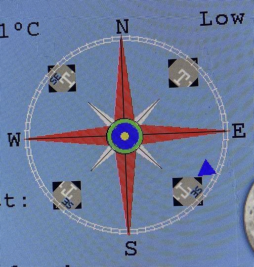

lew247
Joined: 23/12/2015
Posts: 1709
Posted: 10:00am 09 Jan 2021
The background colour is CLS RGB(42,117,198)
I can't figure out why it's doing it to be honest
and when I update the colours so it's the right ones it becomes this
I've made a set of images with the intermediate directions rotated to the correct angles on them
I don't suppose you know a formula to work out where to place them on the screen in the correct place without doing it by trial and error?
cx% = 785
cy% = 238
wid% = 105
ang! = 0.087266463
rad90! = 1.570796327  '90 degrees in radians
I'd like to place the intermediate directions outside the compass as in the cardinal directions, and then possibly place the next intermediates (nnw etc) inside the compass

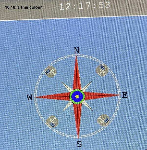

lew247
Joined: 23/12/2015
Posts: 1709
Posted: 10:06am 09 Jan 2021
Peter:
Have you any idea why this happens?
The image rotate when it's redrawn always uses the colours located around 10,10
If I use any other location to write the text as in the examples below I get this
As you can see I tried using 540,110 to do the text so it got the background from there but  as you can see it doesn't work
Also the black corners I can't remove
Any suggestions?
 text 540,110,"NE",L,7,,RGB(BLACK),RGB(134,174,230)
 image rotate 6,4,30,30,cx%+(wid%-16)*cos(.785),cy%-(wid%-16)*cos(.785),45
 text 10,10,"SE",L,7,,RGB(BLACK),RGB(134,174,230)
 image rotate 6,4,30,30,cx%+(wid%-16)*cos(.785),cy%+(wid%-16)*cos(.785),135
 text 540,110,"SW",L,7,,RGB(BLACK),RGB(134,174,230)
 image rotate 6,4,30,30,cx%-(wid%-16)*cos(.785),cy%+(wid%-16)*cos(.785),225
 text 540,110,"NW",L,7,,RGB(BLACK),RGB(134,174,230)
 image rotate 6,4,29,29,cx%-(wid%-16)*cos(.785),cy%-(wid%-16)*cos(.785),315
 text 540,110,"  ",L,7,,RGB(BLACK),RGB(134,174,230) ' clear text
EDIT:
The reason it's getting the grey is because I have a box in the top panel
BOX 0,0,mm.hres,mm.vres/16,1,RGB(WHITE),RGB(162, 160, 160 )' top panel
Edited 2021-01-09 21:34 by lew247
Posts: 11873
Posted: 11:12am 10 Jan 2021
Try the attached - note the use of the dontcopyblack parameter and non-black text to get rid of the rotation artefacts

lew247
Joined: 23/12/2015
Posts: 1709
Posted: 11:29am 10 Jan 2021
This is the result, much better but still the triangle artifacts
Posts: 11873
Posted: 12:00pm 10 Jan 2021
  Quote  This is the result, much better but still the triangle artifacts
Not for me - did you try my code exactly as posted on the latest version of mmbasic attached below

lew247
Joined: 23/12/2015
Posts: 1709
Posted: 12:23pm 10 Jan 2021
Sorry I spoke too soon
Once I incorporated it into my code it's still picking up the colour from 10,10
I tried using 540,110 hoping that it would pick up that blue shade but it still uses 10,10 but with no written text nw,ne etc
