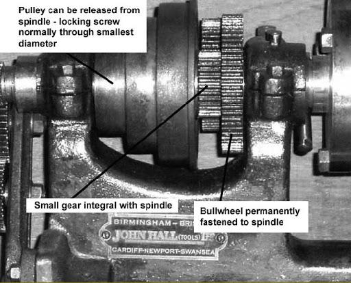

Good Morning ,
This topic interests me ,,as I have a very old (11 days older than myself) South Bend lathe that needs a new belt.
Oh, I'm 76 years ,if you are puzzled),
The belt runs on flat pulleys, they may have a slight curvature crown ,but the belt is original fibre/canvas composition that had steel fastenings .  These made some clicking noises I removed the steel fasteners and stitched it up with my old sail makers needle and palm and some paraffin wax on the waxed stitching thread.
Worked perfectly for some 15 years, .
Question is ,  does anybody know of a distributor for fibre 1 inch (25mm) flat machinery belting ???.
Bearing service and those big machinery parts stores have helped, but no luck with the supply of belting.
I can buy it from south bend in America , buy would you believe the freight starts at 50 dollars US .. (maybe close my eyes and just buy it).
I',ve tried those grooved car timing belts , but matching the pulleys is the hard task.
I read where you guys apply stuff to belts ,  well, I once had a can of resin liquid, that could be used on machinery belts, fairly sticky stuff . suppose you can't get that stuff today ,be nice in a spray can ? -I think resin is made of stuff that comes from gum trees ,you know that sticky red stuff that oozes out when a branch breaks off ?.
Ok, interesting topic, I remember using all sorts of brushless motors on wind genius years ago.
Bruce.

  Quote  Question is ,  does anybody know of a distributor for fibre 1 inch (25mm) flat machinery belting ???.
Pretty sure you could use a standard multigroove automotive belt turned inside out to get the flat surface. These belts are made to bend both ways, so that should be o/k.
A one inch wide belt would be a seven groove belt (7PK) plus the length in millimetres.
Part number for a 855mm long belt would be : 7PK855.
As Tony mentions, you could try the Micro V grove belts.
I have an old lister and some Chinese diesel engines that run flat faced flywheels. I run the Micro Belts on them the normal way to drive alternators with the groved pulley. The lister has 2 alts with a tensioner in the middle.
Admittedly the Lister has a 23.5" Flywheel so there is a lot of surface to grip but I have never seen or heard the belt slip yet even though the alts will pull more power than the engine is capeable of. Listers are also known for Lister flicker with generators which is caused by the huge torque pulse when the engine fires.
I run one Alt on the flywheel of the China engines, flywheel on that is probably 14" or so and they don't slip either and I  have stalled the engines out with other loads on them.
The Micros bite quite well on flat surfaces. I don't know how they would go on say a 2" Pulley but I would tend to think if the canvas/ fibre belt works, the Micros would too.
The only thing I would say to running them in reverse is the micro surface seems to be more " Rubbery" than the back which you can often see the " canvas" or cords just under the surface and on belts that run tensioners on the back can often glaze up.
You could try them both ways anyhow and a bit of belt grip could only improve things.
I have put a LOT of hours on running the belts the normal way on flat flywheels and had no problems at all even running them on painted surfaces.

Ok, thanks guys.
 I have a couple of those ribbed rubber timing belts of a long suitable length that a mate gave me....
I did not realise you could turn them inside out and still get the grip????
I'd have to cut and glue? join it strongly, but I'm thinking of a taper ,then some very good rubber glue. I've seen small tubes of very expensive glue, and wondered why they are so expensive, now I realise. they must be very special.

Bushboy
Posted: 03:13am 10 Feb 2021
No need to cut it !
They are available in any length in 5mm increments.
What length do you need Bruce ?

Posted: 09:55am 10 Feb 2021
To fit an endless belt to one of those old lathes involves removing the main spindle.
If its built like this one, just unbolt the two saddles, fit the belt, and put the saddles back.
